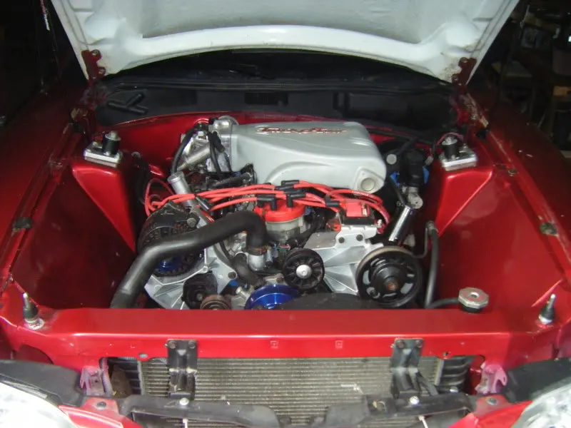

I thought I heard once that the intake has clearance issues with the strut tower brace... :shrug:
then take off the brace??? the intake sits at this height.
If you want to keep the brace, you have to get an aftermarket brace. Maximum Motorsports, and Steeda make one. I'm sure a lot of other companies do too.
Kurt
