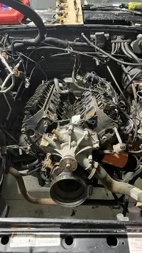

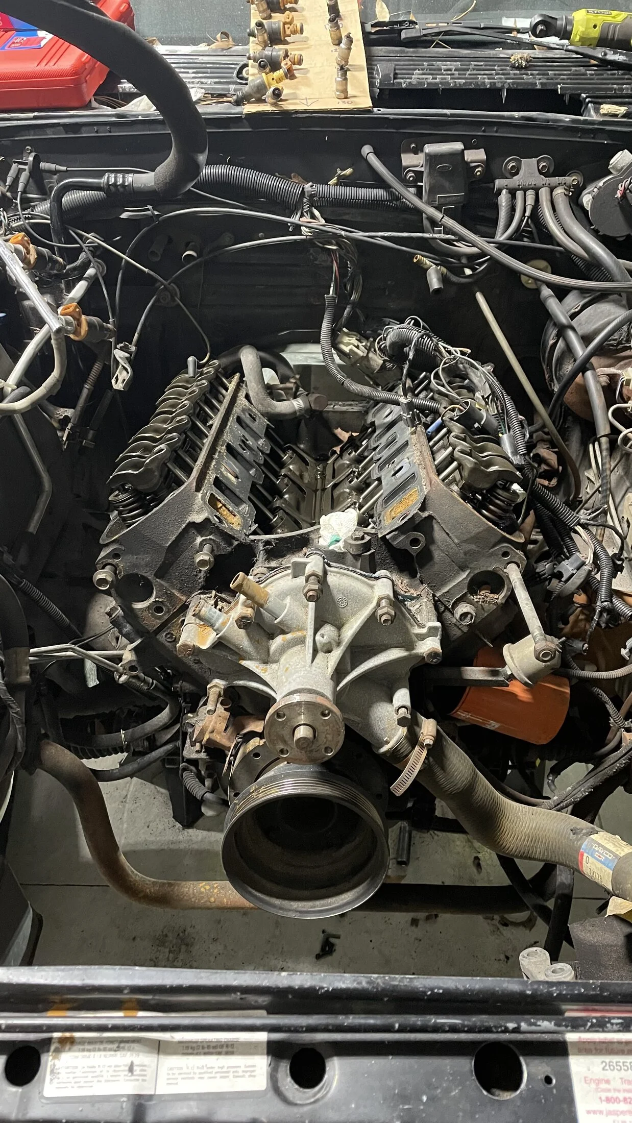

Thanks both for the replies. I finally got the transmission out tonight and should have the engine out tomorrow.Ffrom there I’m gonna pull the heads and see what kind of pistons I’m dealing with which will help me decide on boost and the way forward.

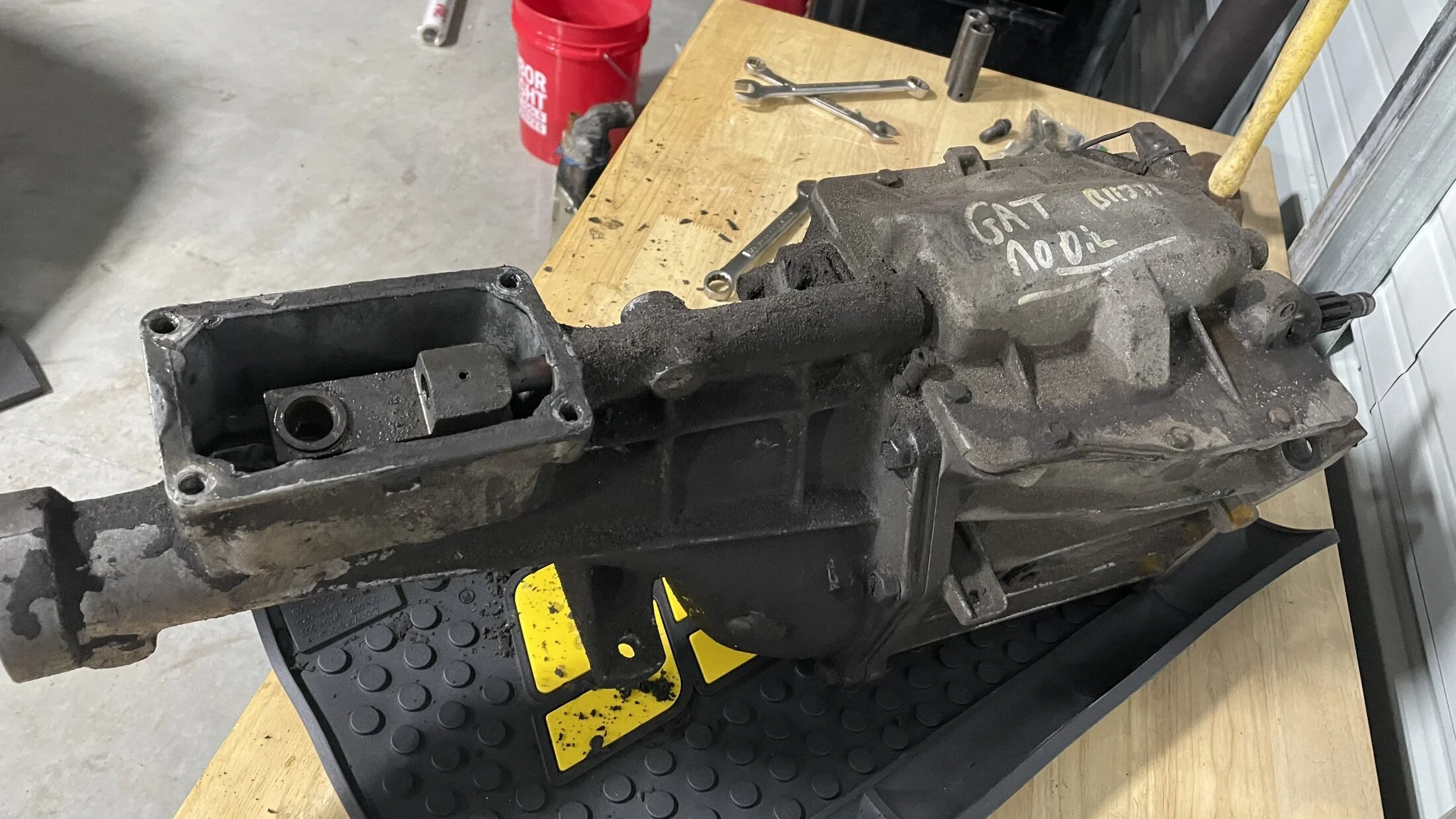

It looks like not only was the engine done at some point, but the transmission was. No tag on it, so I’m gonna have to figure things out by opening it up. It clearly has bad synchros (popped out of first, and I could hold it in second, never got further than that) and probably some chewed up gears. Should be fun.

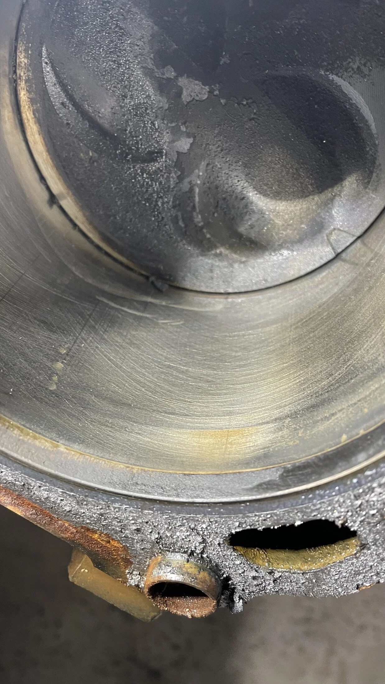

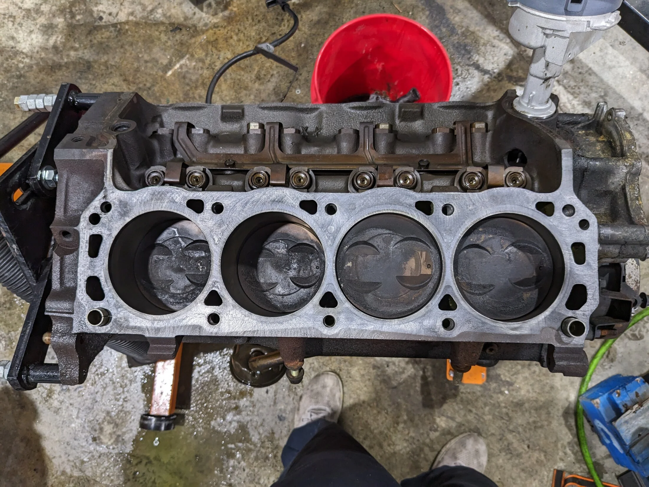

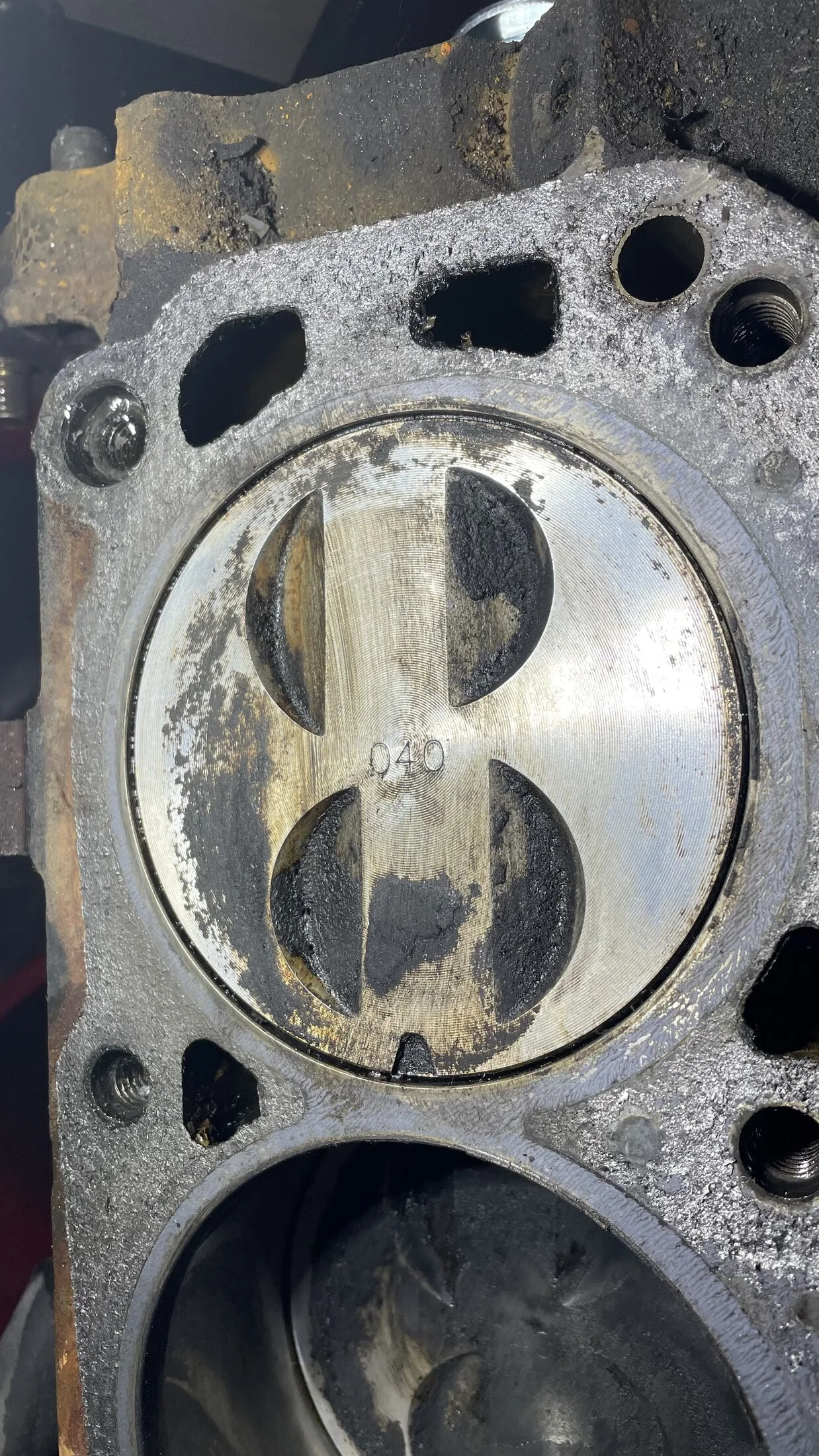

OK, engine is out and I pulled the head on the one through four side. Clearly it’s been rebuilt as it’s got .040 over pistons. Question is, does anyone recognize these or how knows an easy way I can tell if they are forged or cast or hypereutectic without popping them out?
Reactions: Scrapla347
Good hash marks on that cylinder man. Qith them being .040 over there's no need to even worry about them. That was the last rebuild that block can take. Looks like it was burning a little oil past the rings.
My car has a built 331 with cam and aluminum heads. I make good power at 7psi. A friend of mine has a completely stock engine with the same on3 kit and runs 12psi. His car is very tame until he puts his foot in it. Our power level is very close to the same by the seat of the pants. No meet for all the other stuff when you can just turn the boost up. A stick block usually lives until around 500hp no matter what heads and camshaft you have. If your engine was running well I'd clean up the tops of those pistons, install ARP head studs, and let her eat.

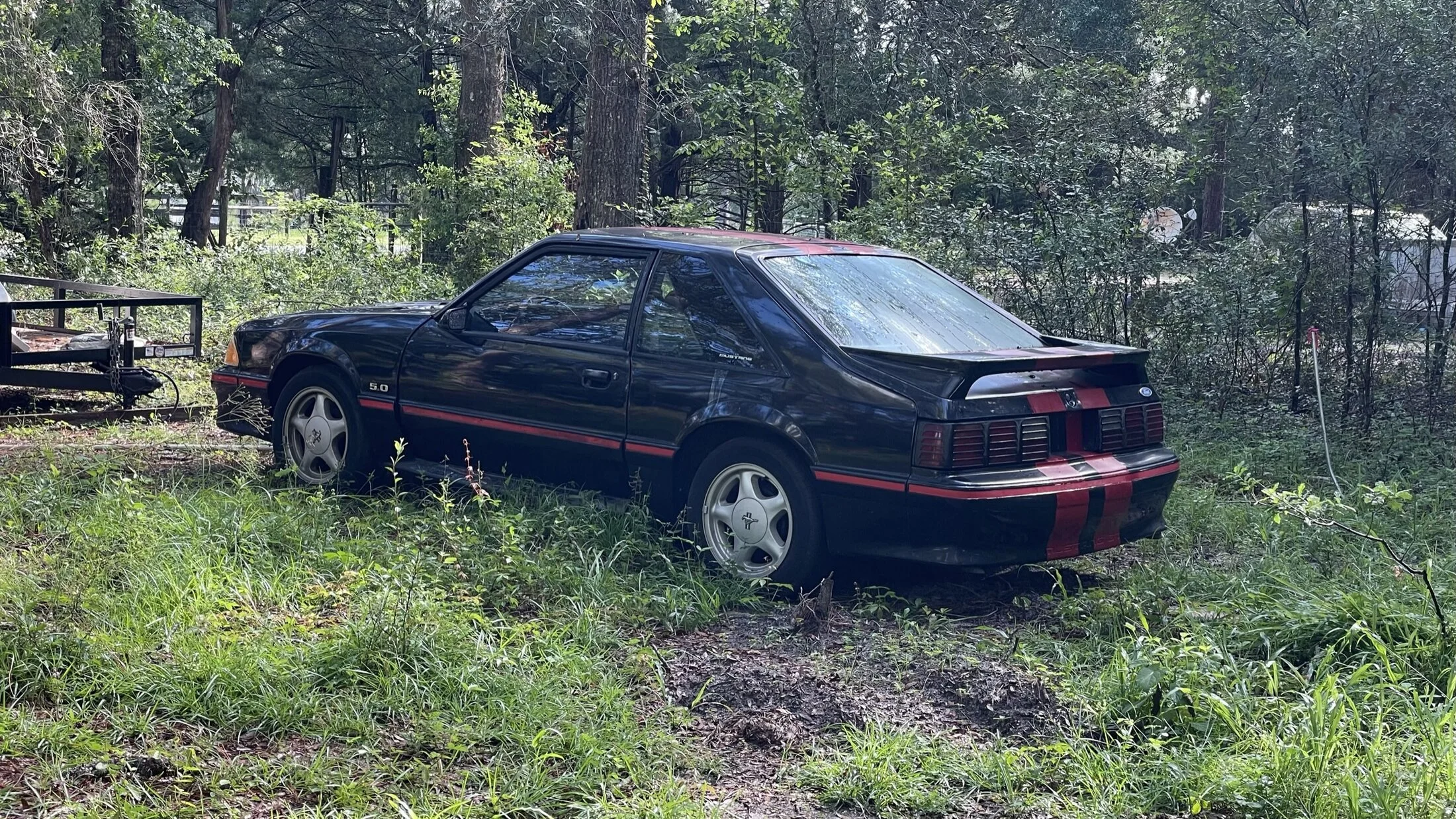

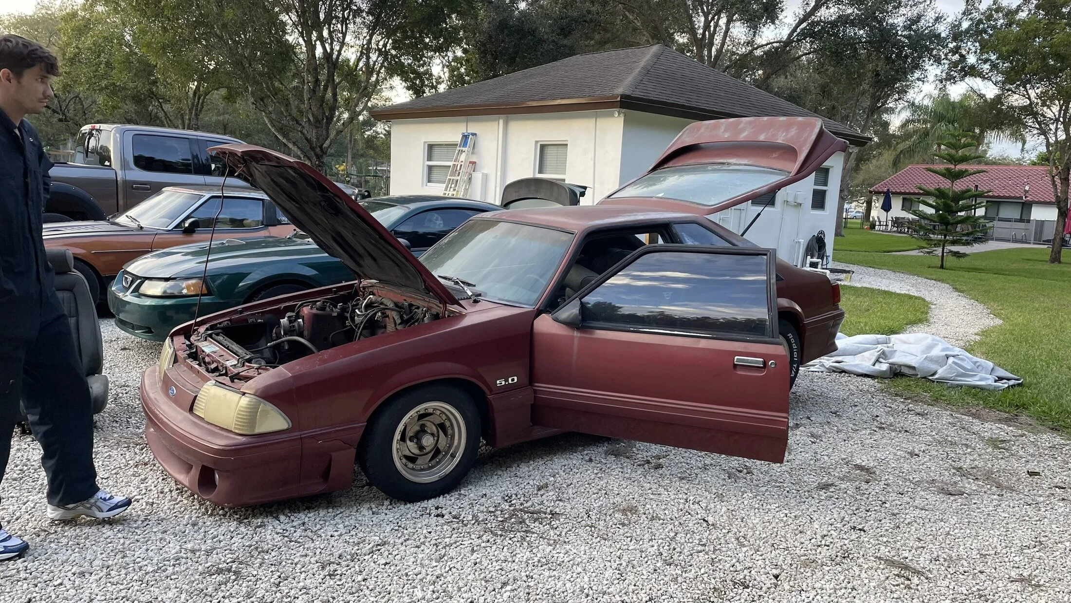

I picked up this '89 GT yesterday. It was a 4.5 hour drive each way, but it was worth it. There is a lot of rust on the body. Passenger floorboard is wasted, the hatch is wasted, door pillars are rusted through, the doors are pretty much shot, but the front clip is good and the glass is all there. The main reason I picked it up is, it came with 2 engines and 2 transmissions.
Engine 1 was in it., but blew a head gasket and was overheating. They said when the added coolant, it came out the tailpipe, so yeah... :oops::D. The trans had a bad 2nd gear syncro, but otherwised shifted fine. The engine has sat for about a year with water still in it (probably the cylinders) so there is no way to know how bad it is until I pull the heads. I'm not hoping for much.
Engine 2 is from a 95 GT and looks to be in good shape. They were going to drop it in, but lost interest. It also came with a T5 from the 95, which they believe was in good shape. I know I have to swap the input shaft to work with my 87 or 89 engine but otherwise, I might just pop the top and see how things are looking.
bonus round... After making the deal, the guy said he had a stack of boxes of stuff he ordered for it, but never did anything with, so those went with it. It was 6 or 8 unopened boxes from Rock Auto, and we started cutting tape and checking things out. Turns out there was a brand new clutch kit, new in the box Energy Suspension Motor and Transmission Mount Set, poly suspension bushings, etc,. I still need to go through all of that to see what is all there again. I was in a hurry to get the stuff in the truck and the car on the Uhaul trailer so I could head home.
It was a long day, about 6:30am to about 1:30am this morning, but I now have a lot more options to work with.
I'll probably part out the 89, it seems to have a decent wiring MAF wiring harness and the MAF along with the ECU, intakes from both years, accessories, etc. and enough parts to help me out on my '87. I'll let you know how this all goes.

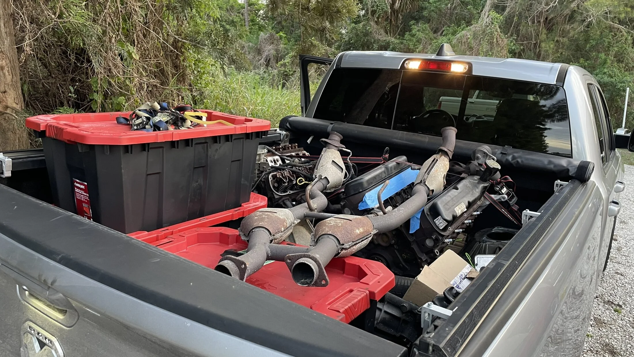

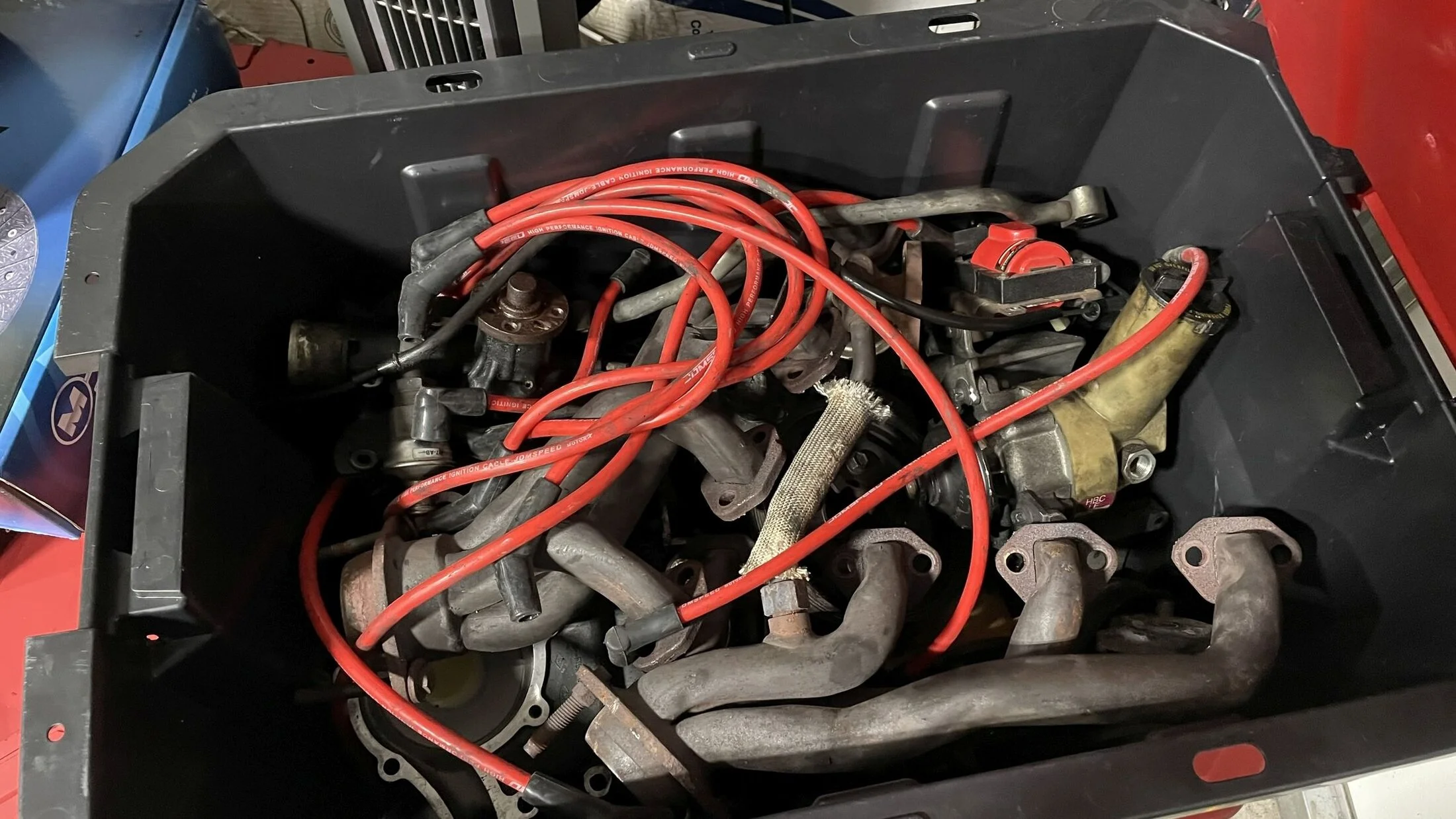

After dropping the car at our homestead and running back to my actual house Sunday night/Monday morning, last night I was finally able to look at some of the stuff that came with the car and was just tossed in the deal. A lot of the stuff was in unopened boxes from Rock Auto, plus 3 tubs of misc parts. They even labeled and ziplock bagged the bolts and stuff as they took parts off. Happy times.

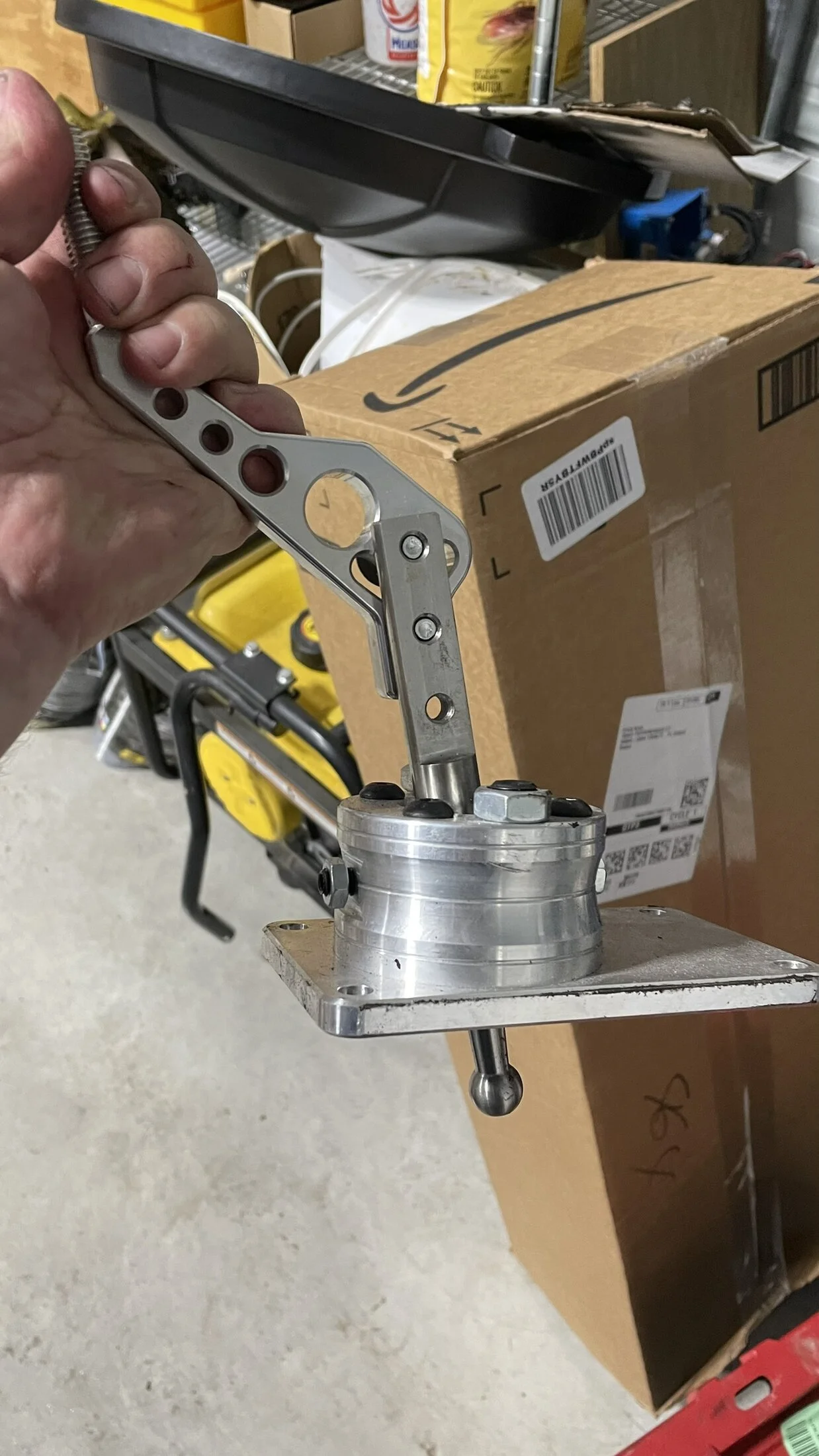

What I found was a brand new set of Energy Suspension engine/transmission mounts and some other new suspension bushings, a brand new clutch set, a new set of lug nuts and studs, brand new front brake lines, and more. In the tubs are the old exhaust and emissions equipment, cooling stuff, electrical, etc and a fancy (cheap generic Chinese I think) shifter. It's shiney, so I love it :D
I also have a complete upper/lower intake with throttle bodies, fuel rails and injectors off the 89 and the 95. Wow there is a lot of stuff here.

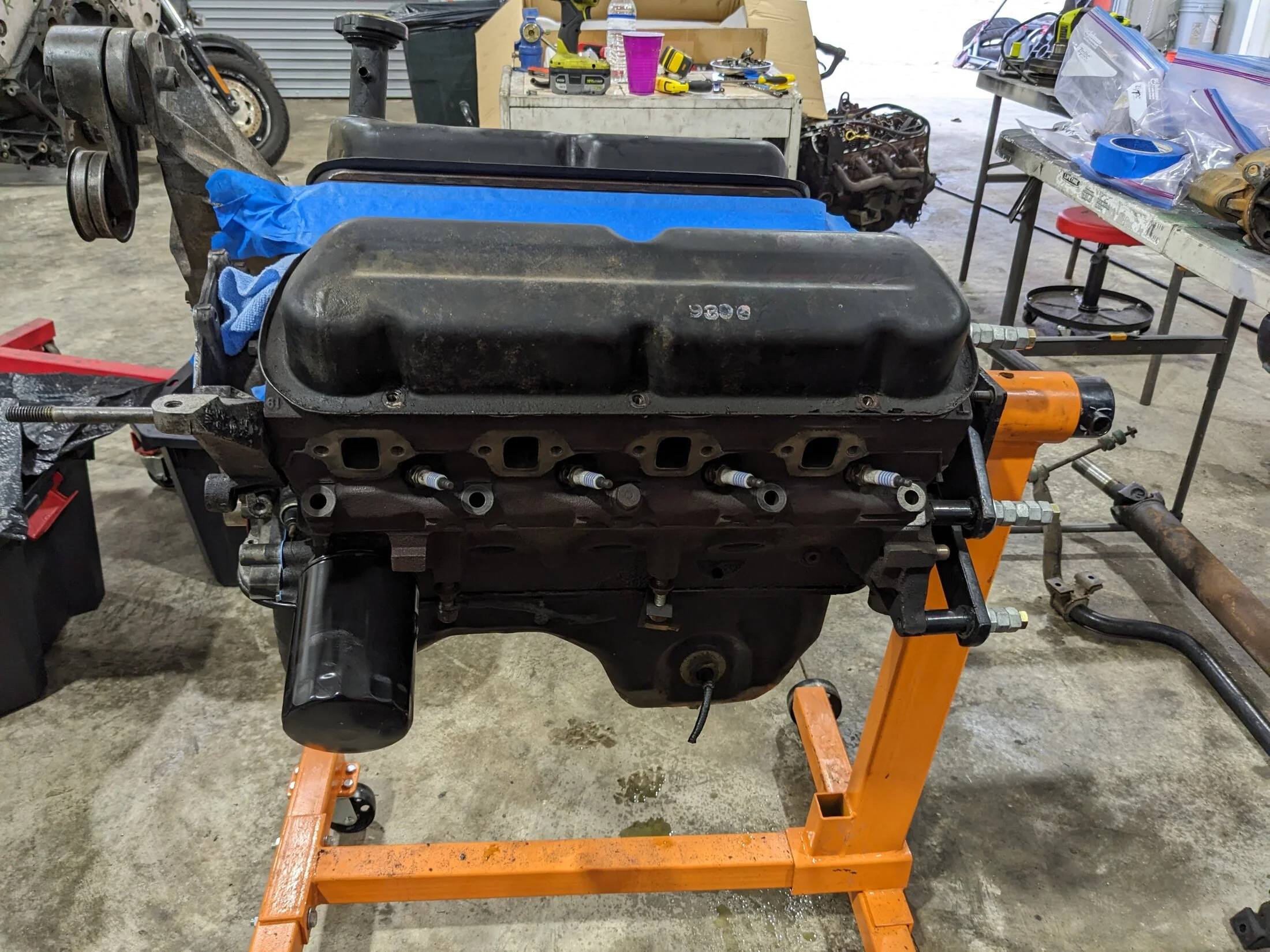

Most importantly are the engines. The 95 engine looks pretty damn good so I think I will start with that. I know the pistons are hypereutectic, but I keep reading that they can stand up to some fun if you are careful with the tune. I mean, if it all goes wrong, it's not the end of the world and it's not like a piston failure is going to launch things into a low orbit. Probably. Maybe.
I always have the .040 over engine from the 87 to fall back on it I create some holy pistons on accident.
So, my plan is this, unless I am missing something...
  • Slap the GT40p heads on the 95 engine
  • Get some 47lb injectors
  • Use the Terminator X EFI goodness
  • Leave the cam stock (unless I can sell/trade some of the parts I now have for a B or E cam)
  • Swap the input shaft from the 95 T5 with the 87 and use that trans
  • Giggle profusely as I apply liberal amounts of boooooooooosssssssst! ;)
