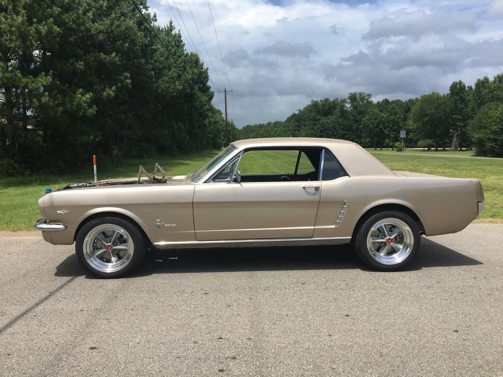

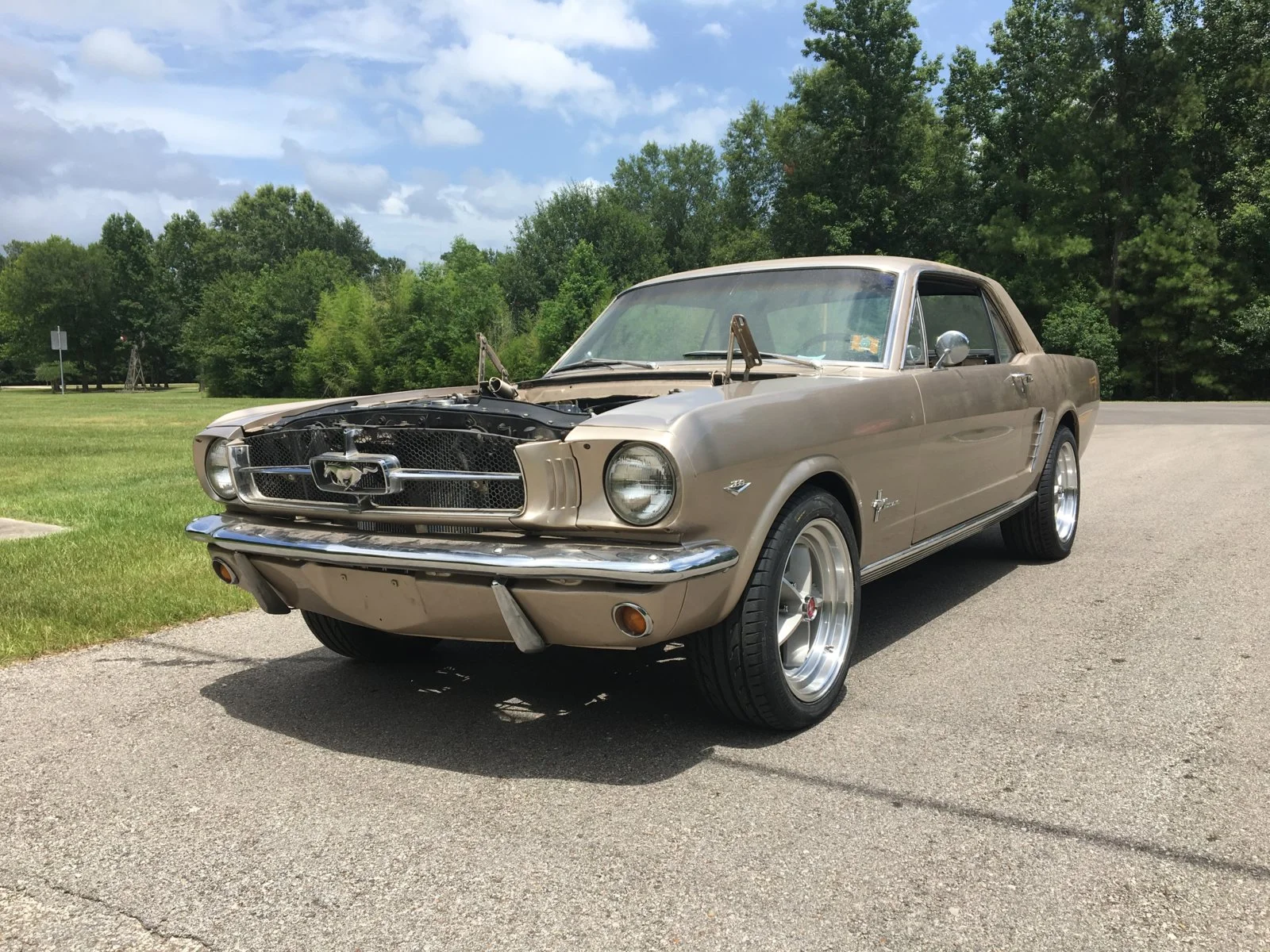

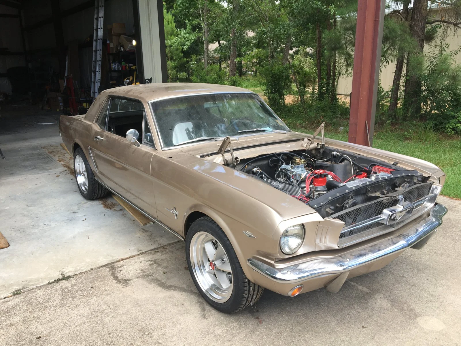

Hi fellows,
Just finishing my bud's 65 mustang and time for an alignment. Did the Shelby drop and new front 600 coils with 1" drop and 4.5 leafs in back with 1" drop. 235/45/17 at all corners. Stance is perfect and handling is very much improved.
What alignment specs do you recommend for this car with these mods? It will be a daily driver with ZERO track time. Main concern is highway handling and long front tire life. Can you guys steer me in the right direction on this?
Thanks
Rob
