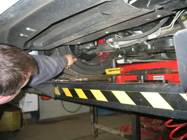

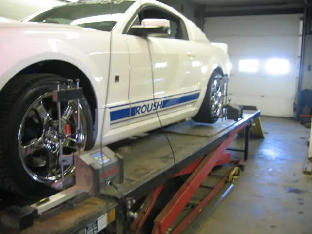

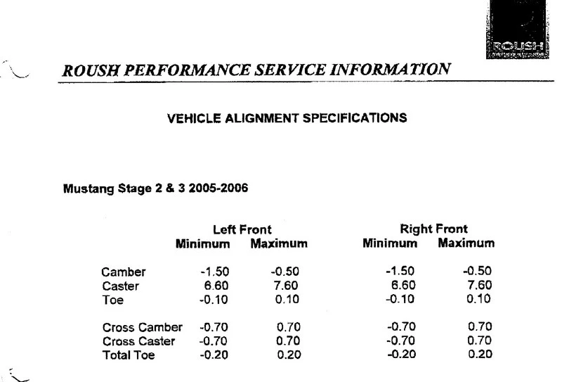

Here are the specs that roush supplied for their kit.

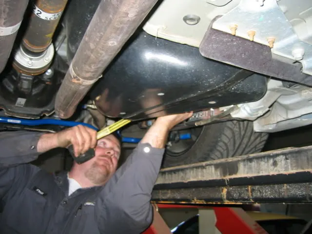

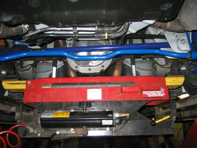

I did a 4 wheel aligmnent as I had installed a adj panhard bar. inputed the roush specs
The rear end I had adjusted . using a plumb line and it was dead on
All it needed was a half turn for the toe in no camber bolts needed camber and caster ok
final reading perfect!!!!!
