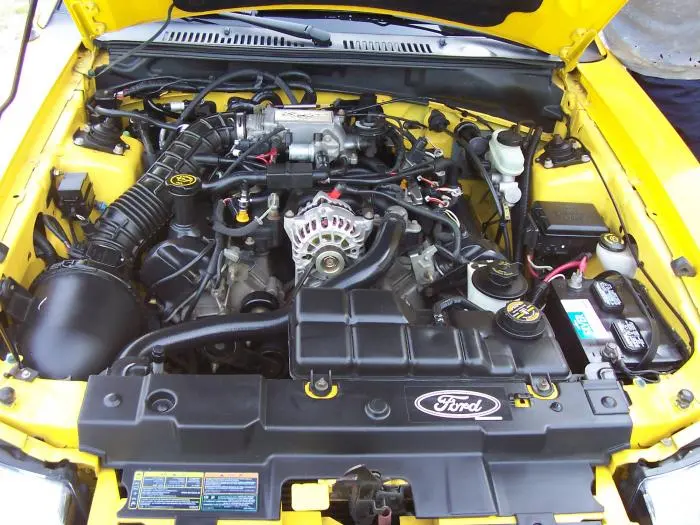

PI stands for "Performance Improved"
It was accomplished over the previous non-PI engines (pre-99 for the Mustang) by swapping the intake manifold, heads and cams out for better breathing pieces. The end result brought the early GT's from a Ford rated 215-225hp/280tq up to 260hp/302tq
