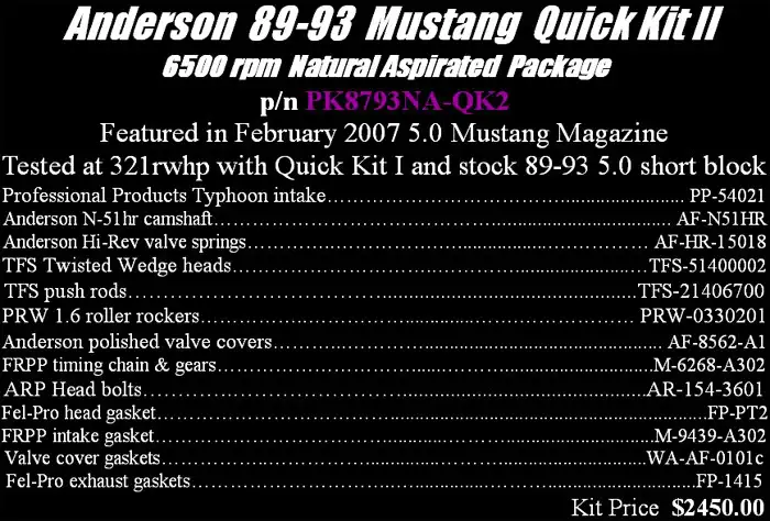

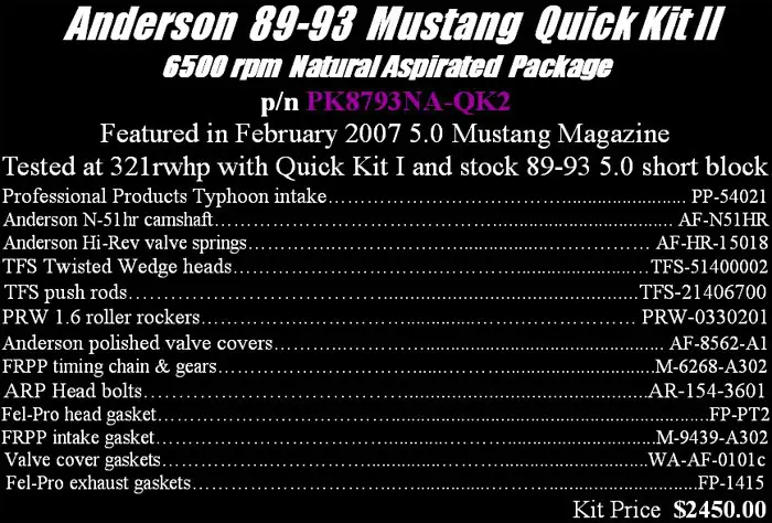

I would expect 285-300 rwhp.
You do not need longtubes.
You do not need a custom cam (but it does give you more power and driveability).
You do not need a tune.
You do not need to be non-emissions legal.
Now, that T-56 is going to eat up a little bit of that power.
Porting the lower is a cheap way to get 5-7 more rwhp on your performer.
They will substitute afr's if thats what you want. Call Rick, he will hook you up.
Ive been meaning to call them and see If there cam is Emissions legal or atleast Has Carb#'s, that is a awsome package, Ive been really wanting that for a while now. I would also pefer swaping the typhoon for an edel performer. IMO seem like a good top end kit, From reputable people. I would trust them over The Trickflow top end kit
