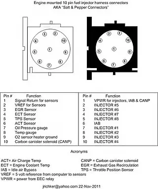

I’m In San Antonio we have a tropical storm from the gulf and I was driving back home & I noticed cel light & all of a sudden I’m getting all these codes? 22,29,32,51,53,54 has anyone had this issue driving in rain? Anywhere in particular area (harness/connector where these all could’ve gone haywire at same time? I have a 89 coupe as I said didn’t have any codes at all yesterday/earlier just after drive right now
Reactions: Creomod
After you clean them you should spread the male pins a little if you can as these connectors are a known problem with getting loose connections. Then use a little dielectric grease to help keep water out.
Reactions: Creomod
That connector is located pretty high in the engine bay. It would take a big puddle to splash water up that high.
But most of those codes are ACT, EGT, EGR which are related through the injector harness
Code 29 is VSS which is wiring under the car
Code 22 is the BAP. This is wired pretty direct to the ECU with no connections. Some of these codes may be unrelated.
I'm nto entirely convinced this is a 10-pin connector issue, but I would start there.
Thanks I cleaned those and added dialetric greese turned car on parked at idal and ran codes all went away with exception of 32 same as before . The 10 pin connectors I actually had them sitting low on to of trans so they wouldn’t be seen I’m gonna drive the car to get tacos and look for the cel light. Then either way when I get back I’ll run codes again I’ll update. Thanks gentlemen! ;)
