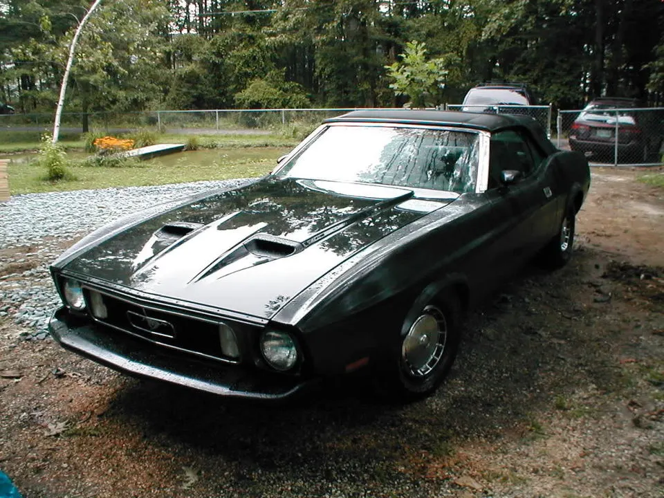

almost done,,,,,,,
:rolleyes: well, except for the whole engine compartment.............

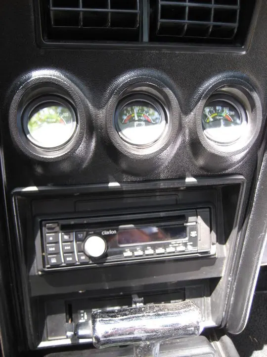

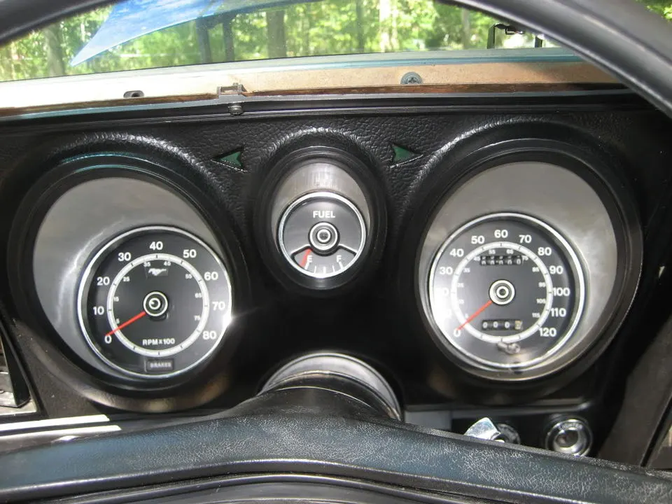

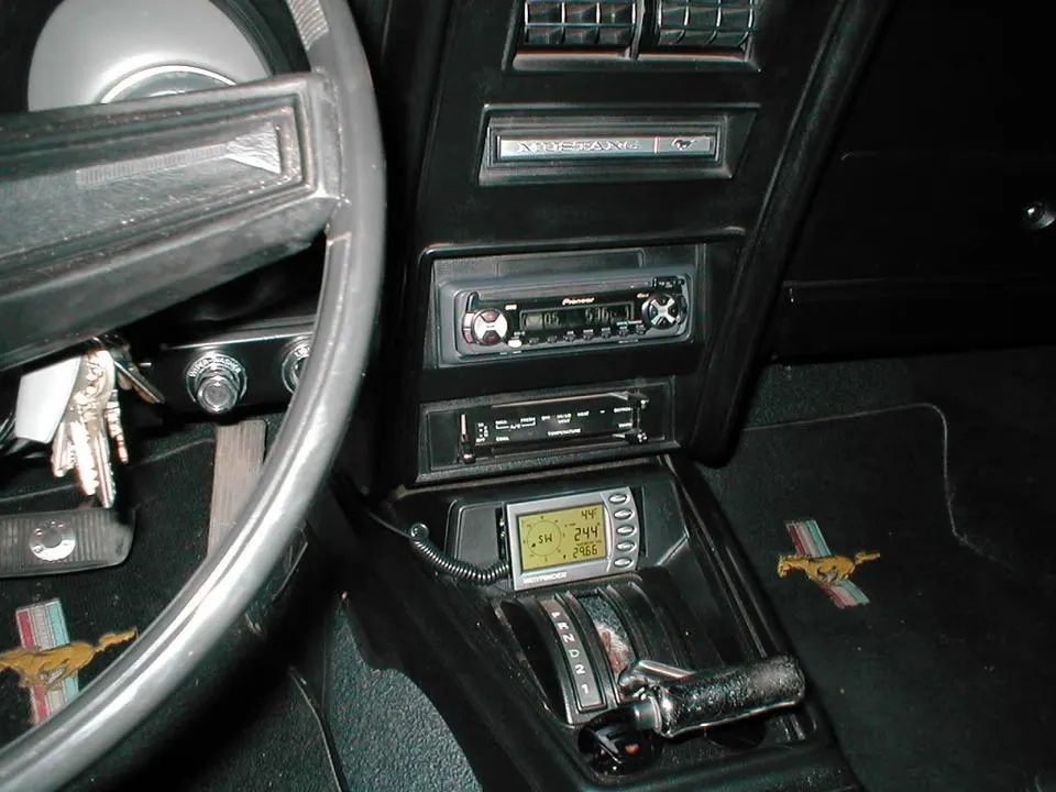

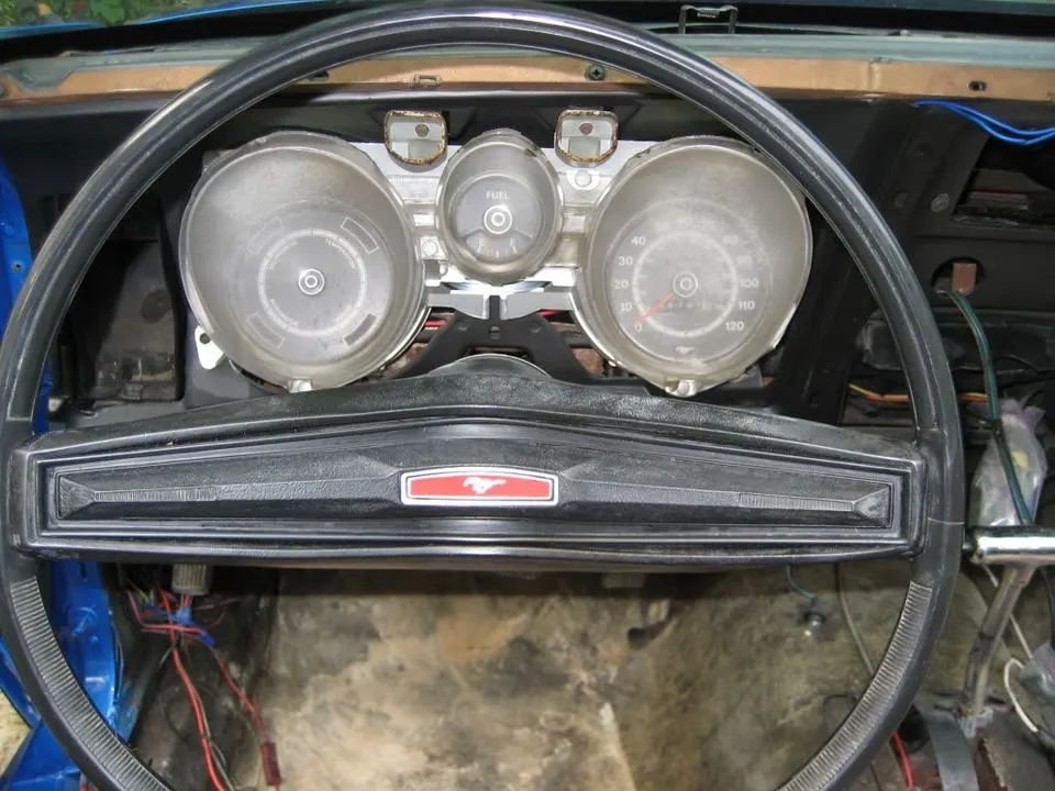

finally got my dash and gauges finished today, and buttoned up the interior....alway something more to do, but all of the hard work is complete...

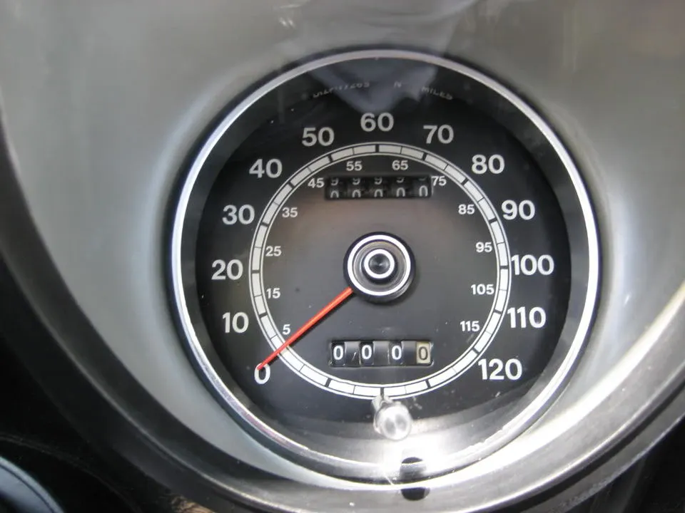

i took the sppeedo apart for a reset.......:nono:

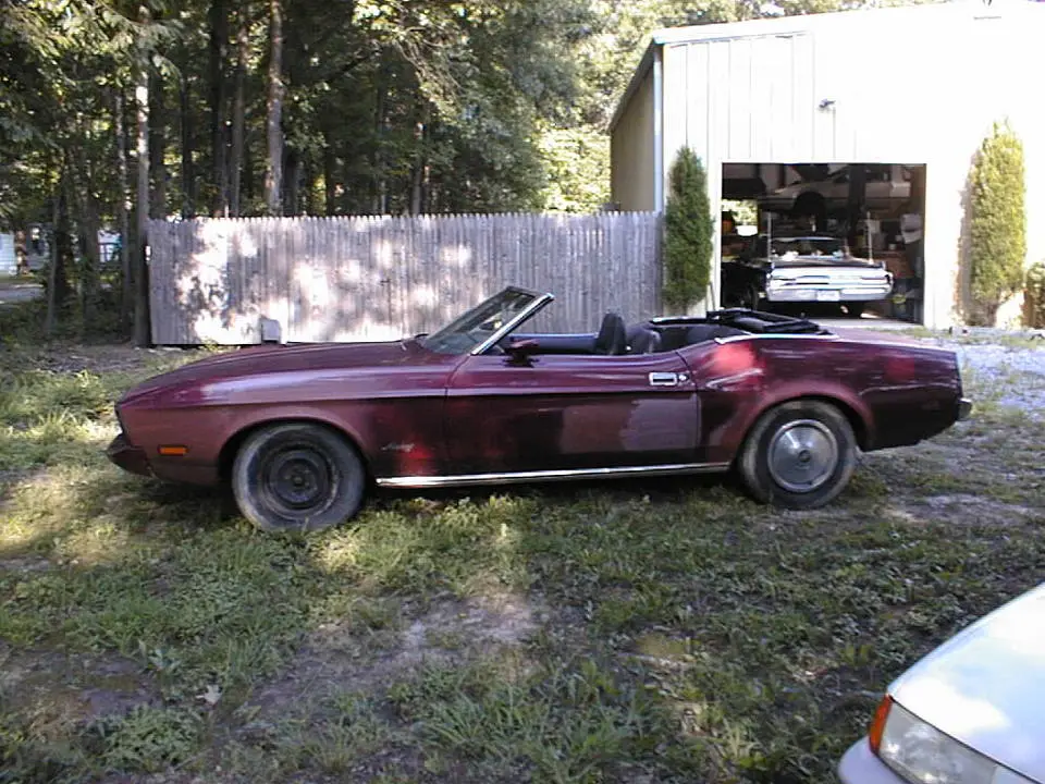

the day i bought er...........august, 2000......
ratted with 12 cans of cheap spray paint ............some time around 2005...

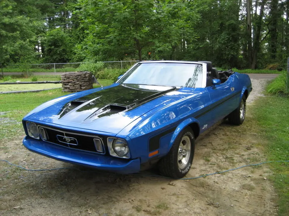

10 years later........
thanks...........
believe it or not, the wheels are original factory............rumor has it that so many people were stopping off for slots on the way home from the dealership,,,,,,,, that ford decided to offer them instead of the magnums..........:nice:
and the paint is from 1999 mustangs......... Bright Atlantic Blue
thought i should keep it in the family........

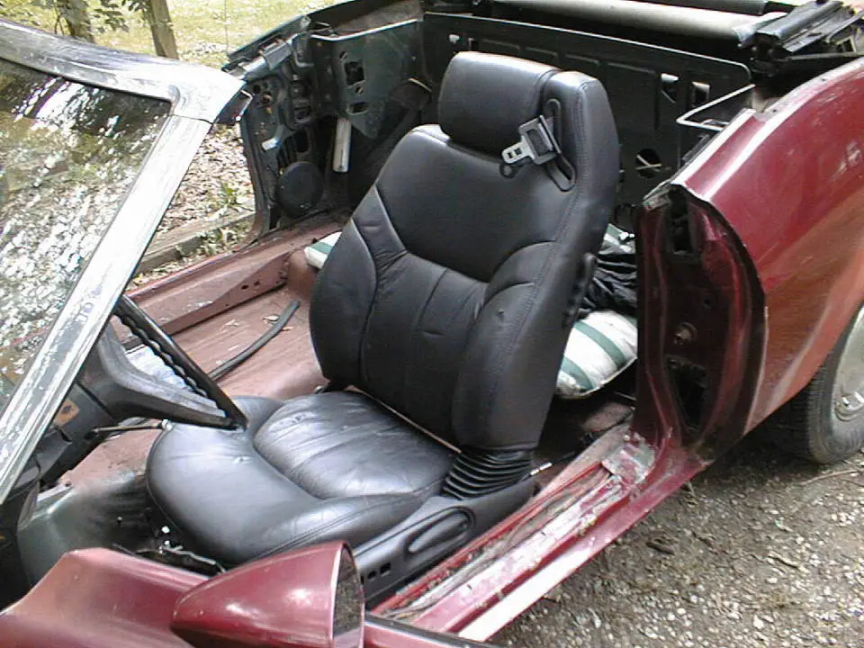

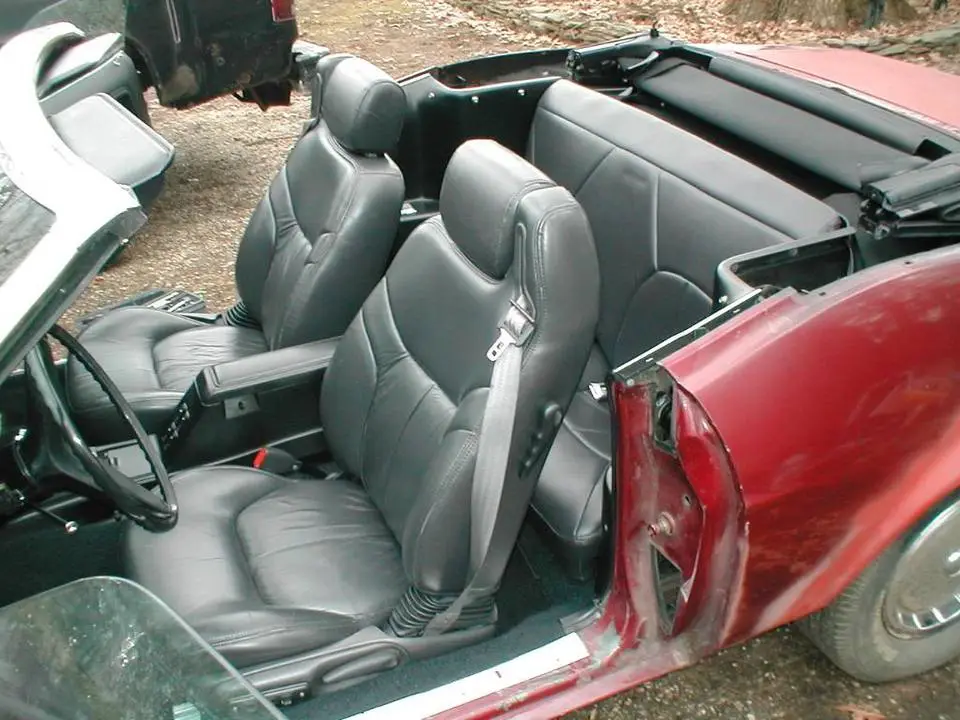

the seats.......
i really wanted a shoulder strap, i just feel more secure............
so, i looked at every convertible that i found to see how they did their shoulder belts.......most went across your shoulder and then into the side of the car,
but the sebring, had it built right into the seat.......so i bought a pair out of junk yard,,, thinking, how hard can it bee bo fit these in???
well..... i love them, all power........:D

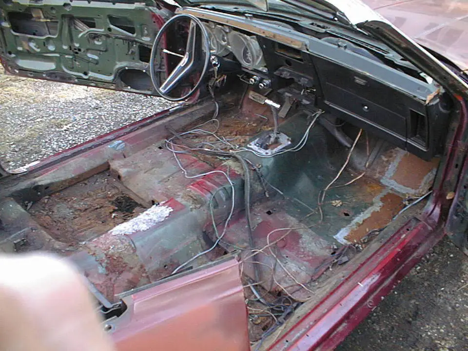

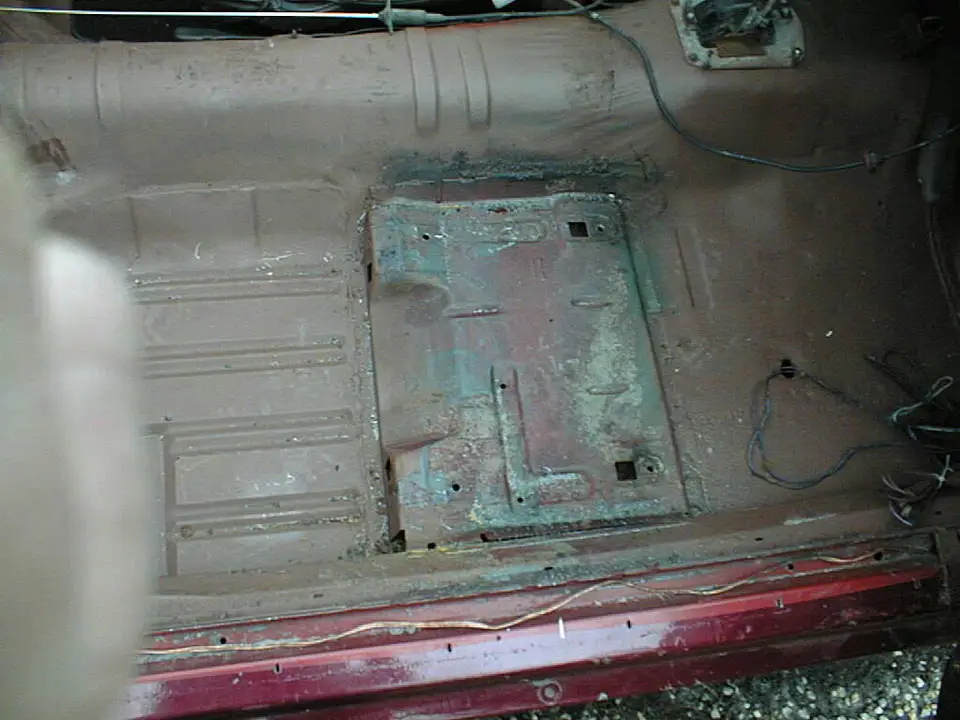

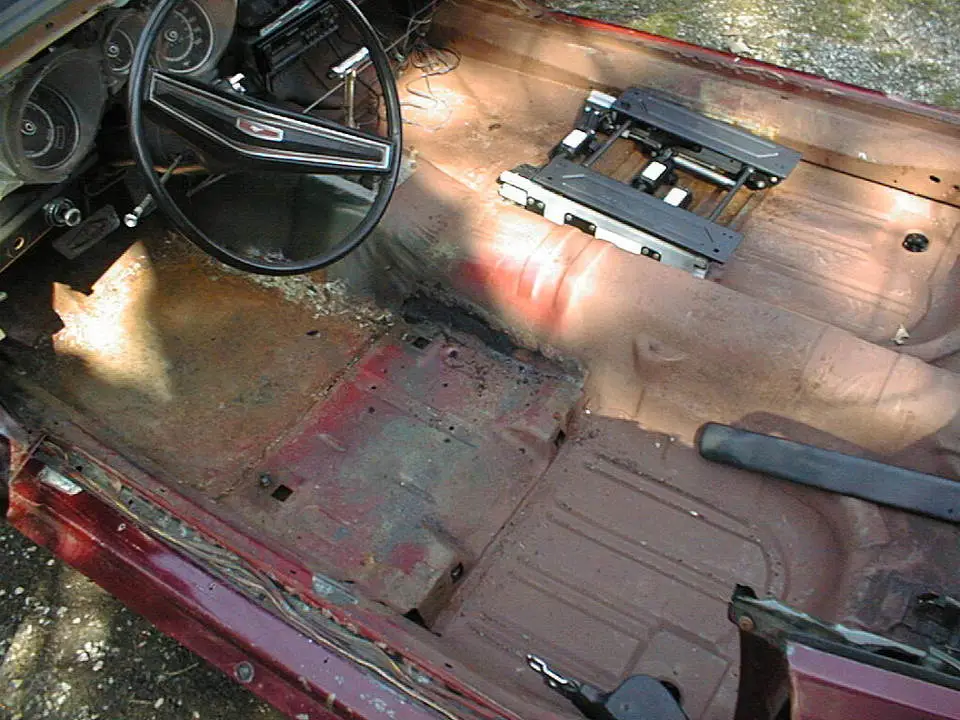

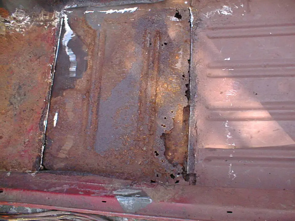

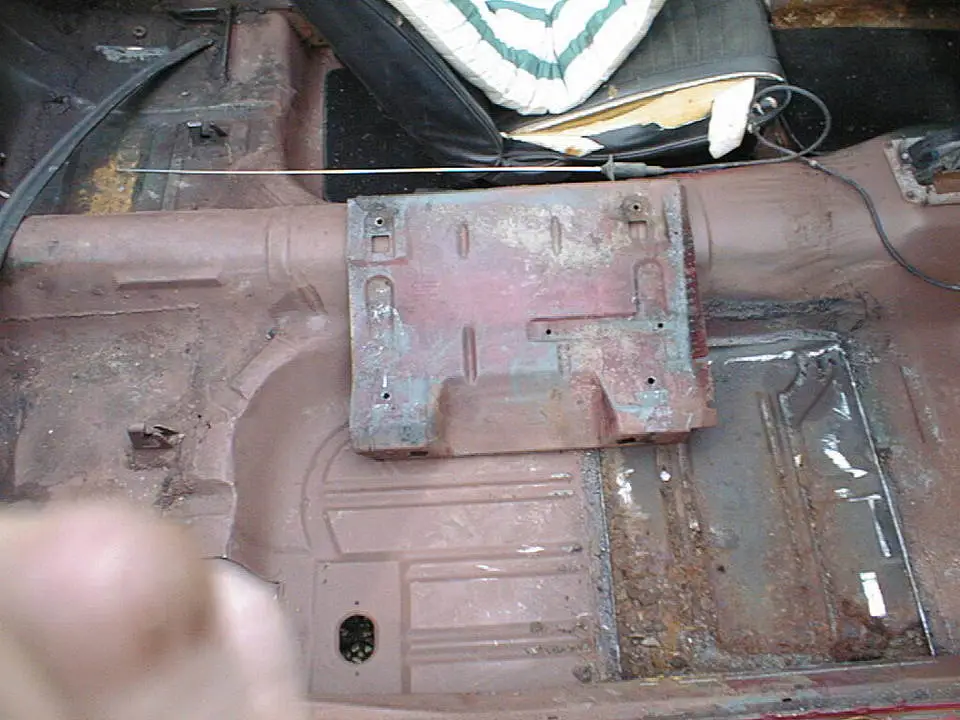

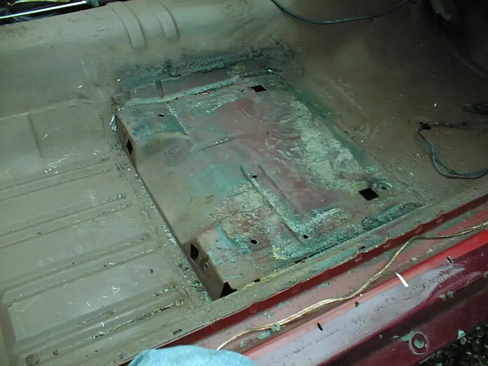

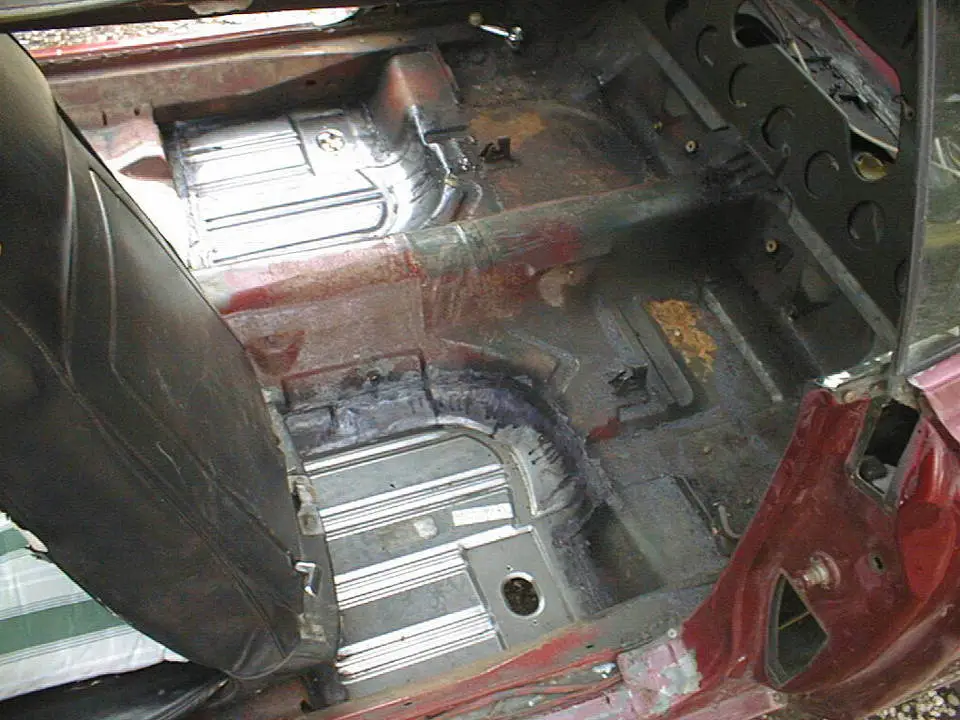

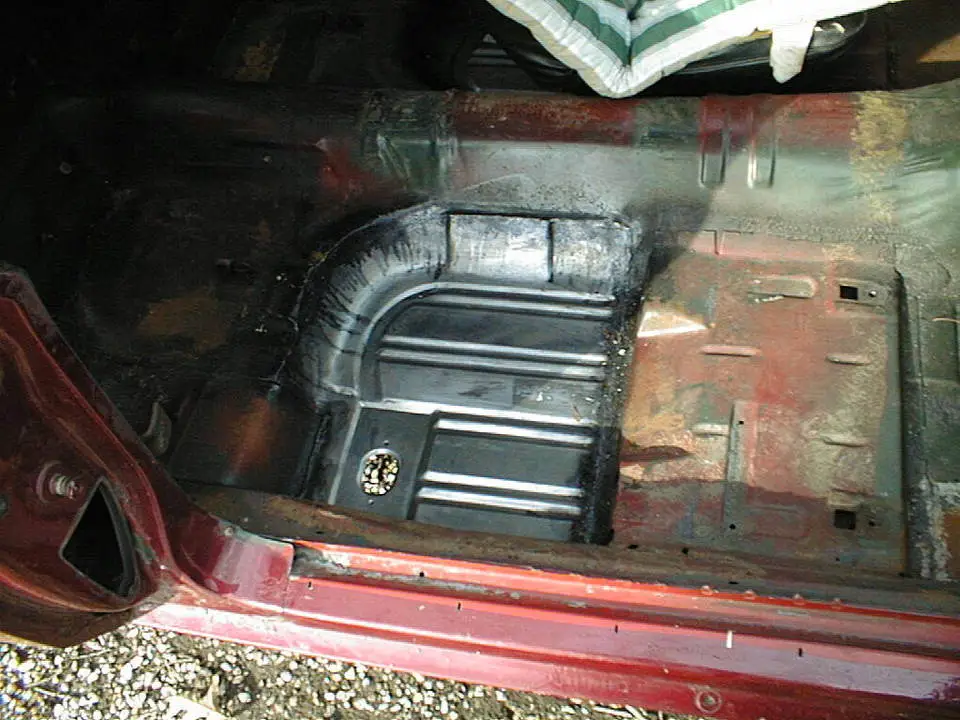

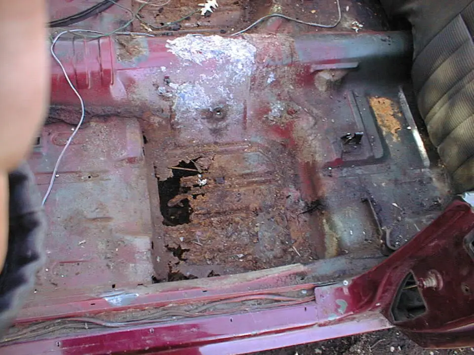

i wish i would have better documented the actual seat retrofit but i have some pics of the floor itself

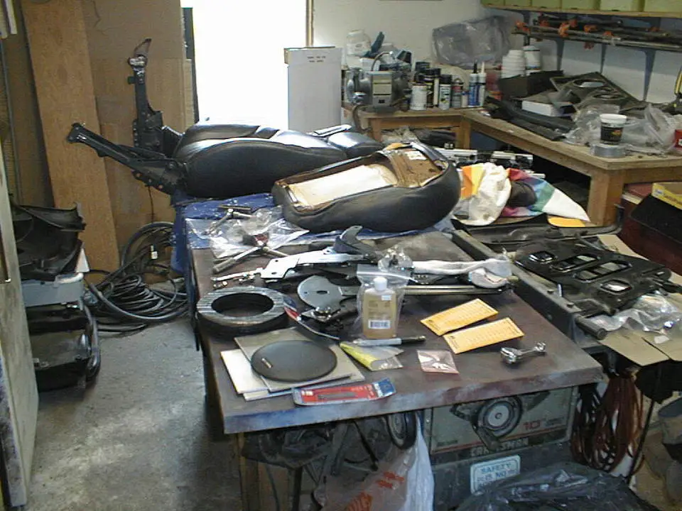

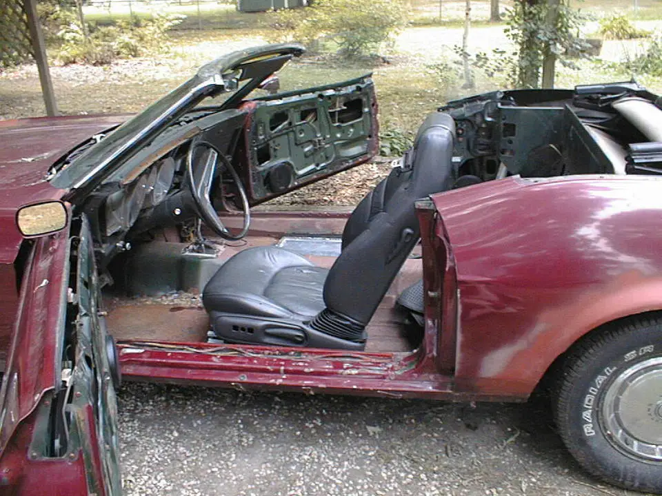

step 2 was trying to fit them in and attach them...

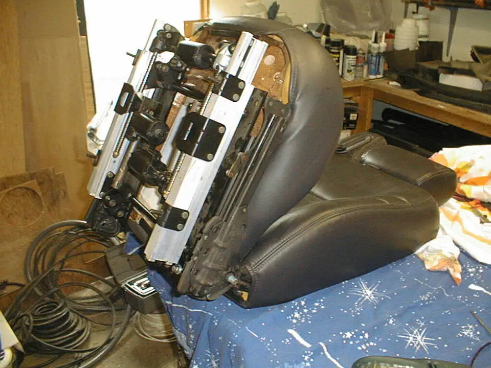

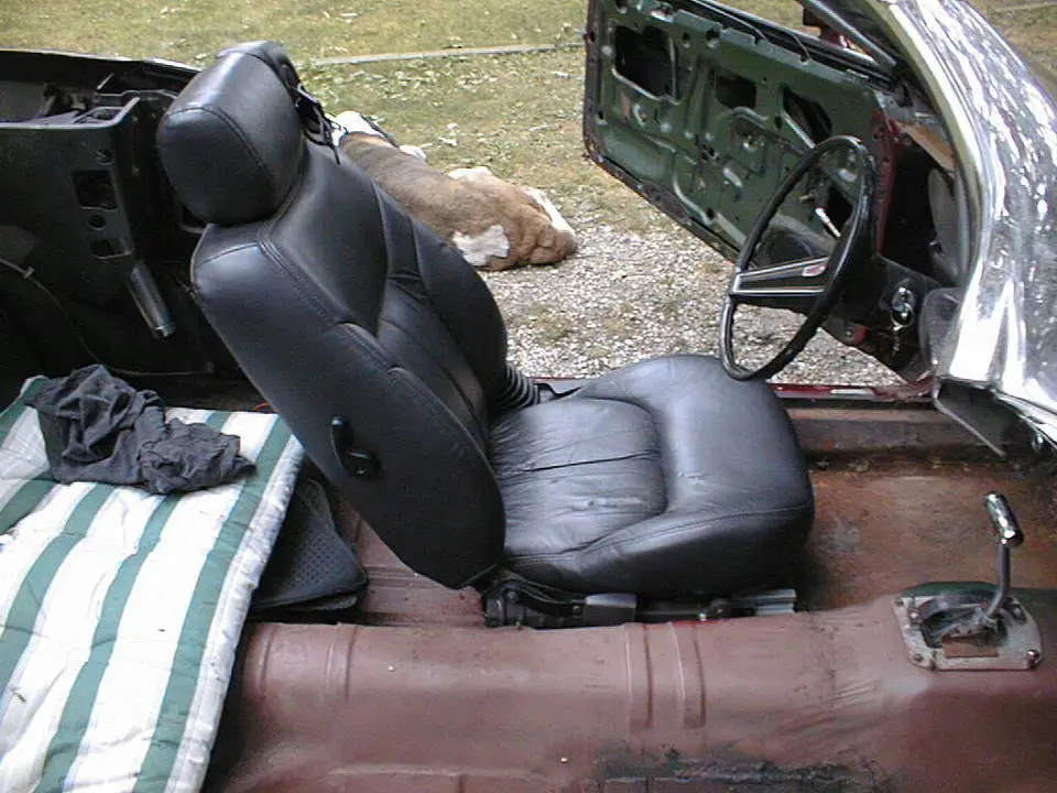

the drivers side was power the passanger manual, but that didn't matter becasue it was pretty much impossible to use the existing mounts that were on the seats,,,,,
so , i bought after market 5way power modules that are more typically used in pick up trucks to mount custom seats......then i removed the moving mechanisms from the seats.,, and was able to find some places that i could drill and bolt on the new mounts.....

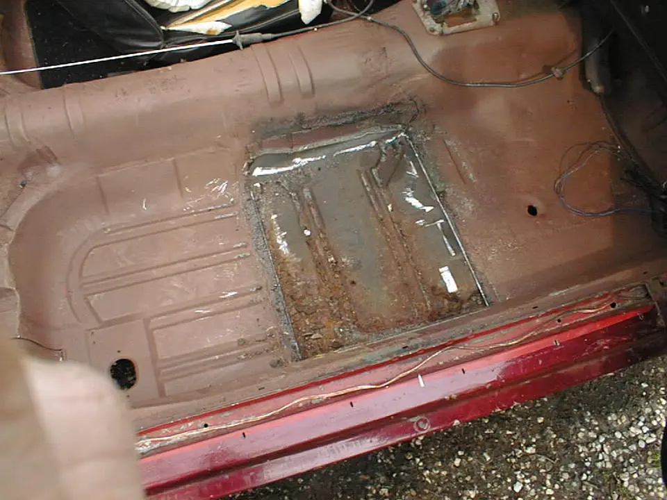

i had to remove the existing seats mounts from the floor and get a piece of metal bent and welded onto the floor deck so that i had a platform for the seat assemblies to bolt on to.....
this raised the seats a couple inches, so i had to install a tilt steering column in order to be able to get in and out of the car with ease......
the height adjust is worthless because of this,
tha tall being said.....we just drove 150 miles each way on a trip over the weekend and the seats are comfortable as all heck.....:nice:
sebrings black color was actually charcoal, and i had the rear seat redone to match the color and pattern of the the buckets......
if you didn't know any better the whole installation looks like it could have came from the factory...
good luck .....

i did remove the piece that was originally used to both the factory seats to, and then had a bracket bent and welded in so that there was something to mount my 5 way power adjuster to.....
i totally took apart the seats and removed the bottom end of both the drivers side (power) and passagers side (manual) and remember doing some hacksawing in order ot get the 5 way adjust to bolt onto the seats.
that was pretty much the hard part, once the adjuster was attached, i positioned the seats on the bracket i had welded in and line drilled holes thru that bracket and the floor.............the adjuster was flat on the bottom and had four studs protruding that went thru the welded in bracket
then from the under side i used a hole saw to make a big enough opening so that i could get a rachet thru floor and bolted the seats to bracket...... i had to use some fender washers as spacers to get the seats to be level in all directions, because the bracket was not welded in prefectly level.........
