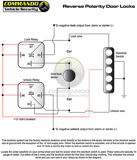

the door locks were last saterday and i got them to work. the only way i managed to was to tie into between the swich and the accuator. youll have to have 2 relays to get it to work. if you want a pic and diagram pm and and ill help you out. if anyone could help me with the starter interupt it would be greatly appreciated.

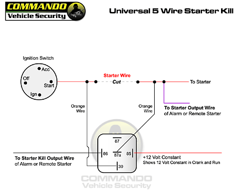

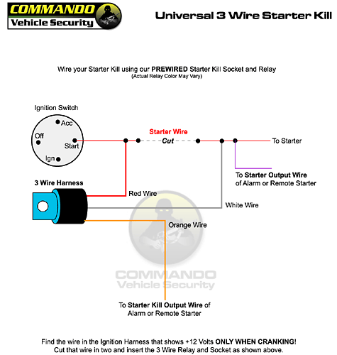

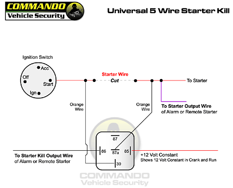

there's 2 ways to make your starter interrupt 3 wire:
an the 5 wire
but if you have a 87-94 use the 3 wire one.
if you need help pm me.

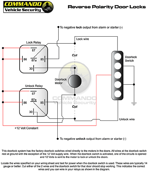

and as for the locks the 87-94 stangs use reverse polarity door locks wich means your gonna have to use a relay for locking and unlocking
but if you have the original door lock actuators they might be frozen like mine were.

Zeus:info for 86. you can get the lock/unlock wires in the driver kick panel. pink/yellow = unlock
pink/lt green = lock.
i would check the wiring from the brain to make sure it is working (use a DMM only; a test light can fry the circuit unless it has on-board relays). most installers will put the relays (if necessary) in the driver kick next to the stock wiring connector. you should see some fat connectors with some good size wires with these colors listed above. this is a lot easier than doing as 88MustangGT did, as running wires through the door is a pain.

stangs (or any car) can use a SPDT relay (the 'five wire' starter kill). it is a good idea to use a blocking diode on a starter kill relay, but not necessary (prevents feedback).

88gt, what are you having trouble with? Crash, what does your install sheet say for the starter wire? i think it is red and yellow, but i could be very wrong. you should be able to catch it under the lower ignition column. pull the little press on wire off of the solenoid (so car wont start) and probe wires, lookin for one that is hot when the key is turned.
you could also get it at the clutch safety switch (same circuit). or at the solenoid. remember, that unless you make some sort of armored plate over the solenoid, a thief will either disable the alarm and drive off, or jump the solenoid (like we do when the car wont start), and drive off.
