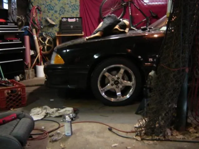

Ok i finally got around to finishing up the front end. I am very happy with these wheels. Now i gotta tackle the rear.
