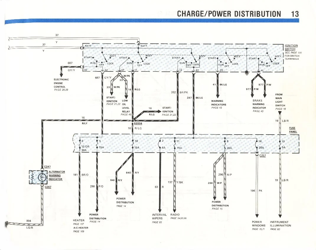

Engine off, ignition on, battery fully charged:
1.) Alternator warning light should glow. No glow, bulb has burned out or there is a break in the wiring between the regulator plug and the dash. The warning light supplies an exciter voltage that tells the regulator to turn on. There is a 500 ohm resistor in parallel with the warning light so that if the bulb burns out, the regulator still gets the exciter voltage.
Disconnect the D connector with the 3 wires (yellow/white, white/black and green/red) from the voltage regulator.
Measure the voltage on the Lt green/red wire. It should be 12 volts. No 12 volts and the wire is broken, or the 500 ohm resistor and dash indicator lamp are bad. If the 12 volts is missing, replace the warning lamp. If after replacing the warning lamp, the test fails again, the wiring between the warning lamp and the alternator is faulty. The warning lamp circuit is part of the instrument panel and contains some connectors that may cause problems.

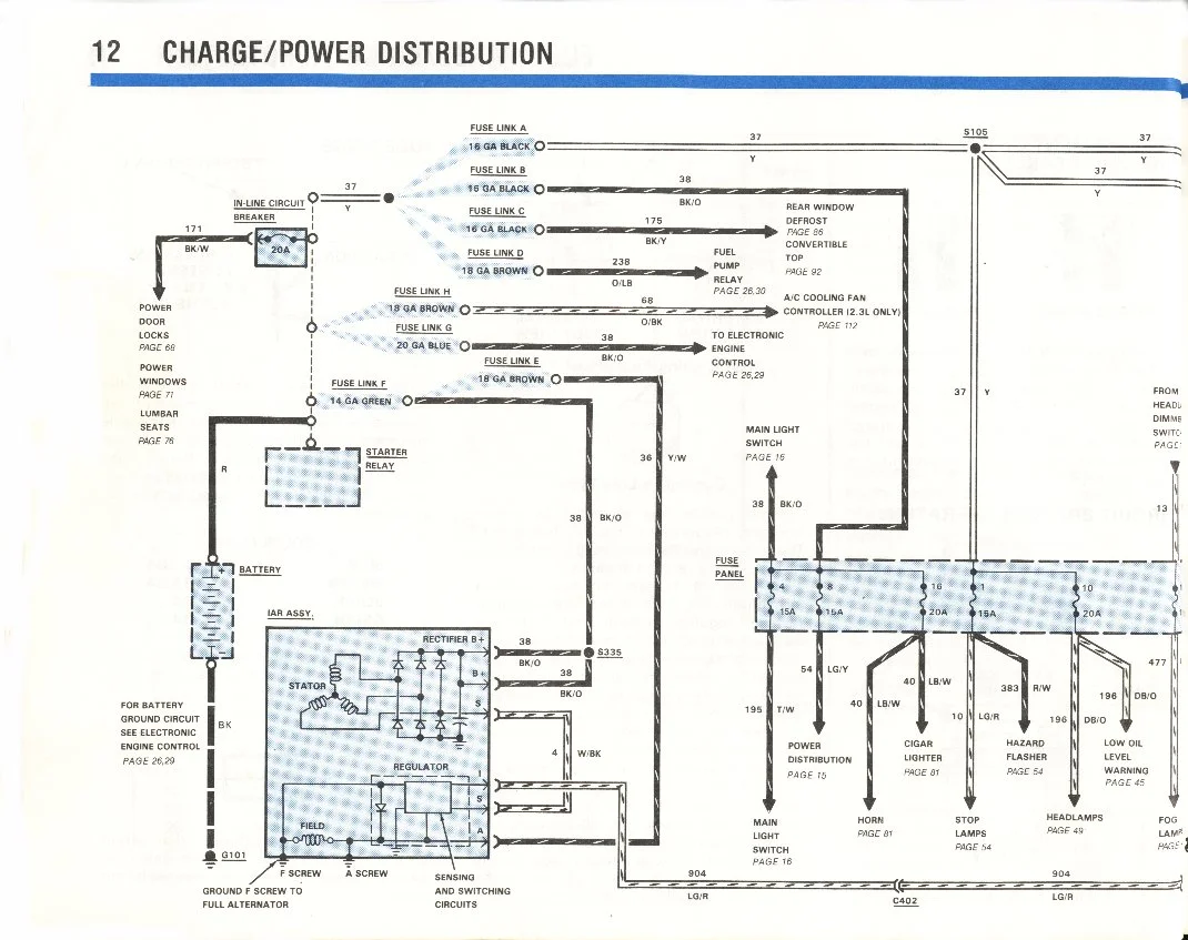

Alternator wiring diagram for 87-93 Mustangs.
The following are diagrams courtesy of Tmoss & Stang&2birds
Alternator wiring diagram for 94-95 Mustangs.

Alternator wiring circuit
Notice the green wire connects to a switched power source. The circuit contains a 500 ohm resistor in series between the switched power and the alternator. Connecting it to switched power keeps the regulator from drawing current when the engine is not running. The resistor limits the current flowing through the wire so that a fuse isn't needed if the wire shorts to ground.
Also notice the sense wire connects to the starter solenoid and it is fused. It connects to the starter solenoid so that it can "sense" the voltage drop across the output wiring from the alternator.
