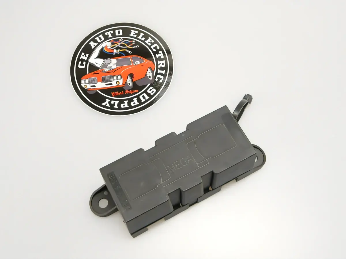

If you had the alt rebuilt the shop should be able to tell you what it’s putting out. The 6 ga wire can carry up to 65A so if your stock alt is putting out more than that move up to 4 ga.
As for the fusible link…trash it. Get a mega fuse holder and mega fuse that is less than the maximum current carrying capacity of the size of wire you are going to use. So on my cars I used 4 ga power wire and 125A fuses.

Fuse it to protect the wiring and all components in the circuit. You want it's rating to be less than any of the components in the series, and typically the wire is the lowest rating.
Fuse links burn up and they you are stranded. You can toss a 2nd fuse in the glovebox and swap it on the side of the road. However, size the wire appropriately with good solid connections/crimps and that should never happen.

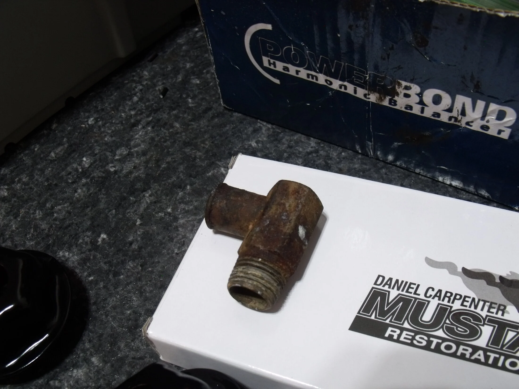

General, you have been infatuated with this part on my car that I took off and have been saving it for you.....
  • Haha
Reactions: General karthief
Reactions: limp
Reactions: limp
And wtf those stupid little things used to be $3 each, now there $8.60 on rock auto ffs. At least the fuses are still under $3 there. Getting tired of seeing stupid normal auto parts double or tripple in price.
If it's broken or worn out I want it.
Put that in some ospho, metal prep or hell Even vinegar and water and it will look new in no time... Lol I threw some crusty oem floor pan plugs, the oem metal ones in my derusting bucket a week or two ago, forgot to pull them out till today, damn things are cleaner them what's on most cars now.
