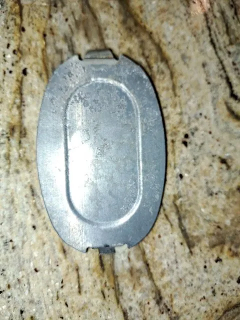

Ehh this thing was orange with rust much worse then that fitting when it went into the funky smelling derusting bucket. High build will fill the pits when I epoxy the half pan patch.. Like $20 for a pair of those damn things now, I hate the nickel and diming parts esp. at todays prices and the pan in that area if often rotted threw on these cars up here... Did a couple seat tracks and few other steel parts, all of them cleaned up.. Well except the seat track springs, those came out in a couple pieces lol.
