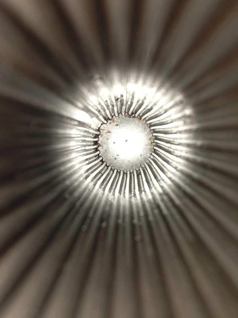

Deffinitly smoother , mine came from a friend with a 351 76mm turbo with a c4 that car went 9.23 with it and began to twist the input spline before anything was wrong with the drive shaft , I think they are a little stronger then we give credit for !!
TOOLOW91
20+ Year Stangneter
8,501
8,763
S.I.NY
Feb 22, 2013
  • Feb 22, 2013
Found the pic , when I did all my recent work couldn't figure out what was up couldn't get my shaft in , this was it !
I guess a TRANS brake at 3k will do that haha

dam!! twisted metal!! great pic i think u found the maximum capabilities lol im sure they can handle more than 400rwhp i wouldnt go without one
Reactions: toolow91
