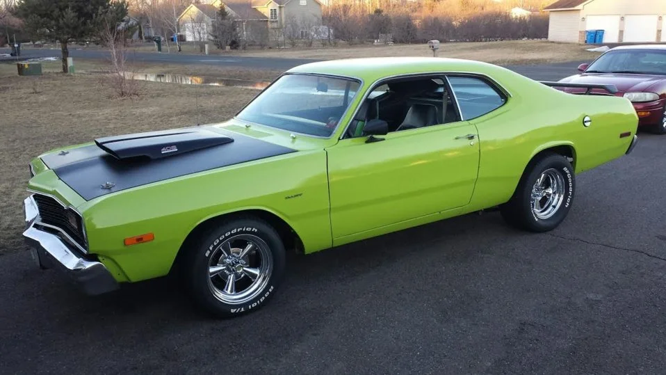

Thanks! I'll look at the Professional Products intake manifold. I assume the adapters are easy enough to find. I found a couple really nice exhaust cat back systems. Magnaflow has a gorgeous stainless system that I would consider if I were a Mustang guy. I do race a lot of Mustangs, however. This is my baby, the Green Monster.

Nice Dart by the way is it a Demon or just the Sport

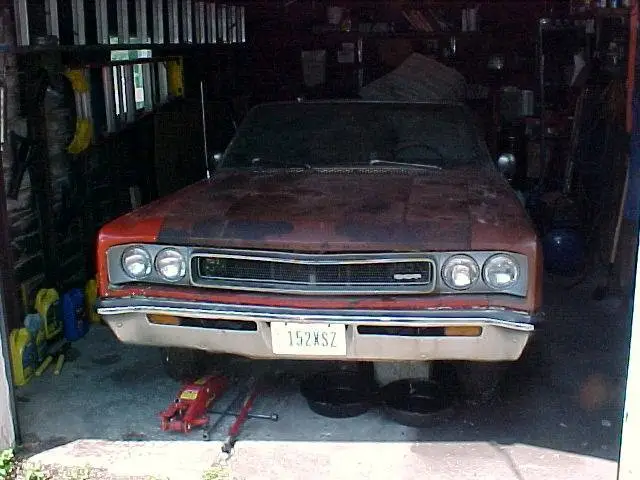

Besides what ever POS I drag home here's are off and on project its 1 of only about 700 or so 67 Rebel SST convertibles ever made

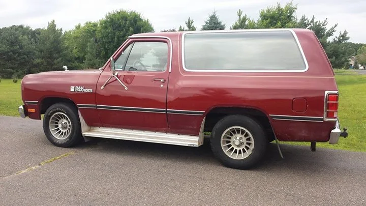

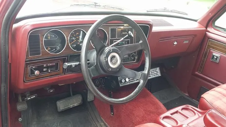

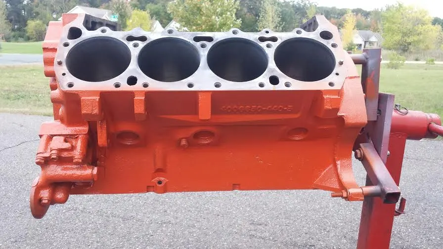

It's a Dart Sport. 500 hp 408 stroker. 12:1 compression. I put in a GM 200R4 transmission for the overdrive and a Dana 60 with 4.10's. It turns 11.57 in a quarter and with the overdrive I've had it to 145 mph with more to give before the front end got too scary. I love this car. I'm building a 440 for my 83 Ramcharger now. That's going to be a quick truck.
