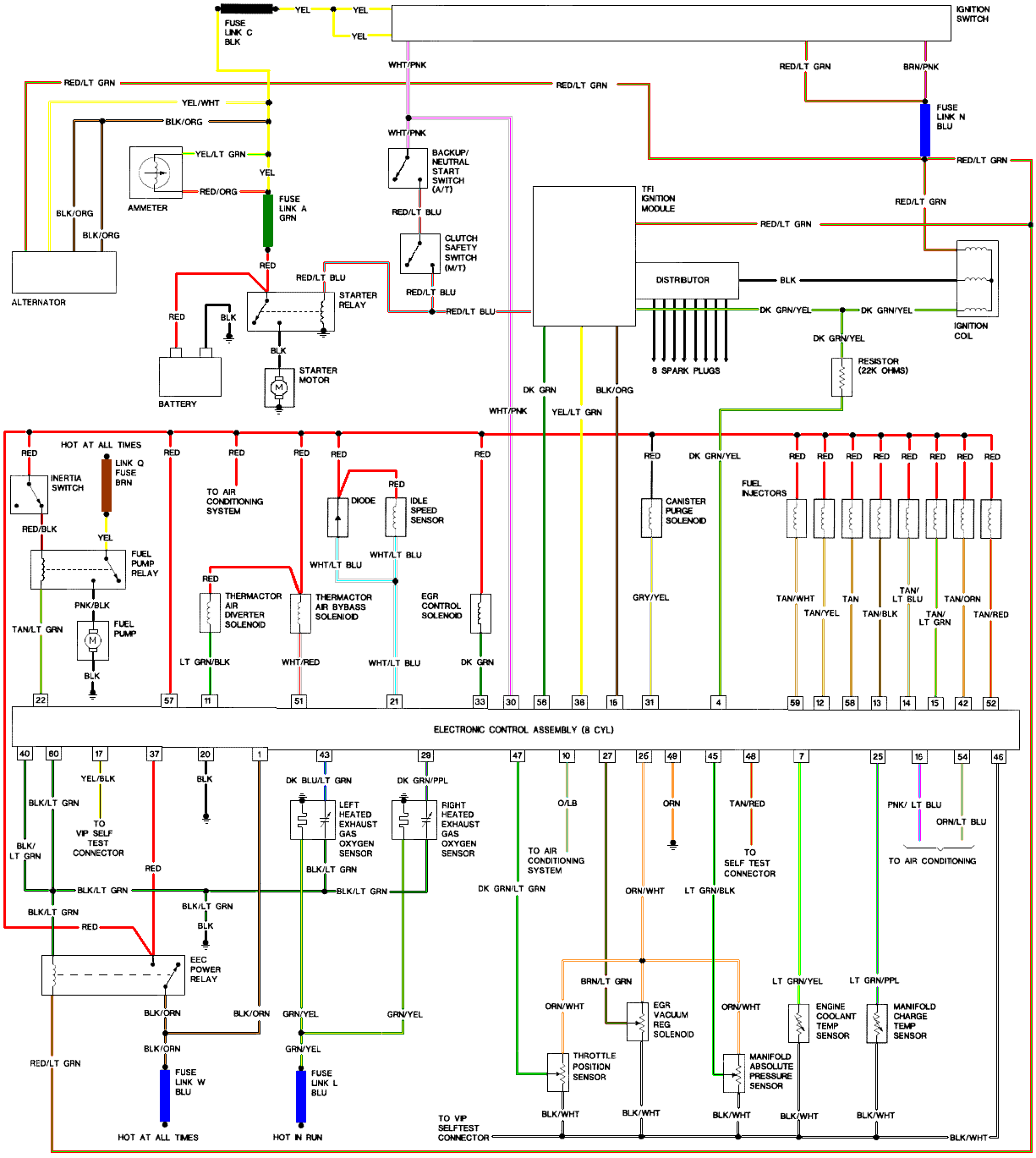

83 mustang with its stock alternator I had rebuilt...... When its running the needle stays in the middle. Any draw I turn on, ( headlights ) and it stays right there, no up or down movement...... Is this thing working OK... Been a minute since I was behind an amp gauge.......
The amp gauge measures differential output between battery and alternator. So, you should see it budge when you turn on headlights or the A/C fan or whatever.
I found a present for you:
Courtesy of Veryuseful.com
