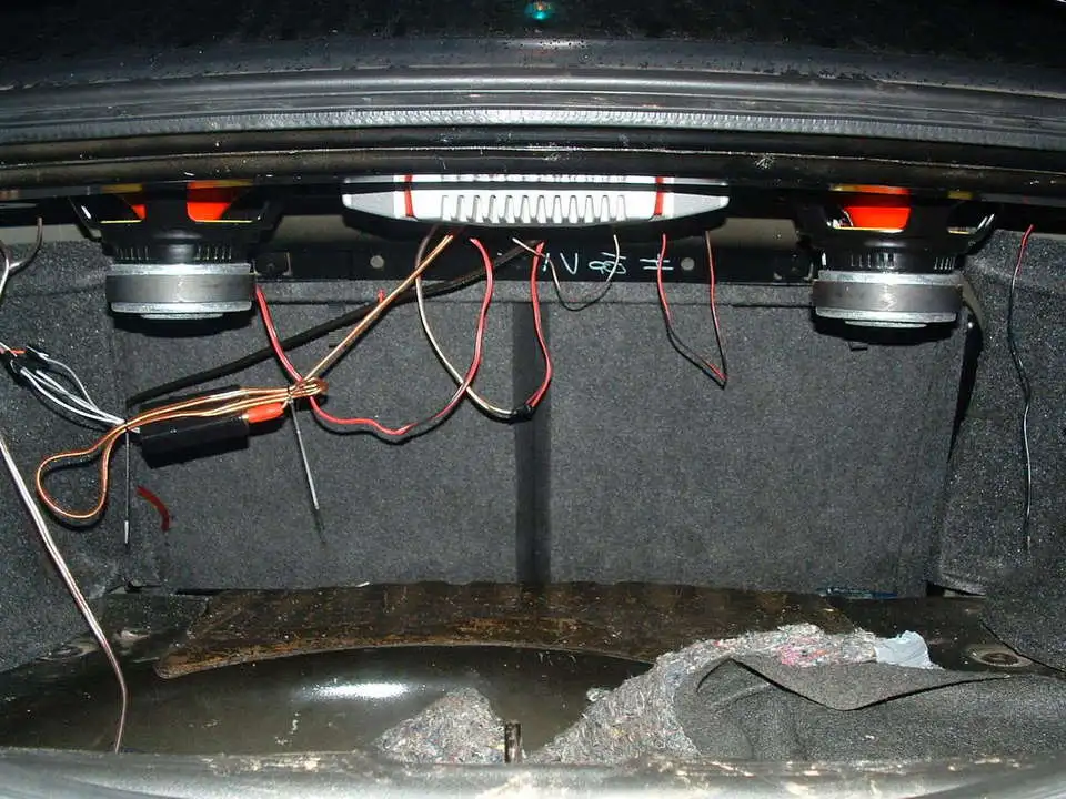

ah ok, all you need now is a Line-Out Convertor (around $20) just splice it into the rear speaker lines and hook up the amp to it. pictured to the left (black box) is the line out convertor, hooked up to the rear speaker lines
Umm yes it does hence the big heatsink on the top it is to draw the heat away from the circuit board. but then again I'm an idiot only did custom installs for 5 years, and slept through most of my electronics classes.

heat generates to the heatsink no matter how it's mounted, it's still going to draw everywhere, if it mattered alot then alot of pcs would go to chit because the processers are sideways and so are the heatsinks, as long as the heatsinks are there and the unit is ventilated there shouldn't be a problem, well that and how crappy the amp is makes the difference

Very true. It was just a myth about mounting amps upside down being a huge problem. I've done quite a few installs in a million different configurations, and when everything is done right, it doesn't matter how you mount them, as long as there is some room around them for air movement. I've had amps under seats before, and that was the only problem I ever had with air movement. If I had a few pc fans blowing over it, I'm sure it would have been fine.
