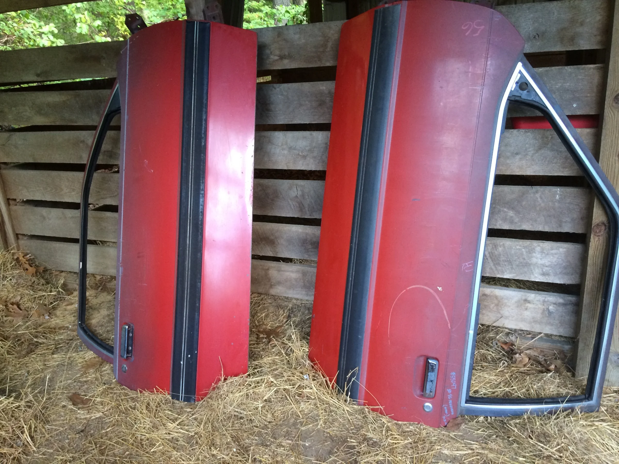

Just picked these up today there off a Arizona car with all the hardware in them including one good door card.

Good score on the doors

Why did you get the doors? I'm not knocking it, good back up doors are a good thing. And hard to find.

My doors are bad the bottoms are rusted out
That's right, you said that before. Sorry, sometimes I work extra hard at being stupid than other times.
In that case, cool score. They look really nice.

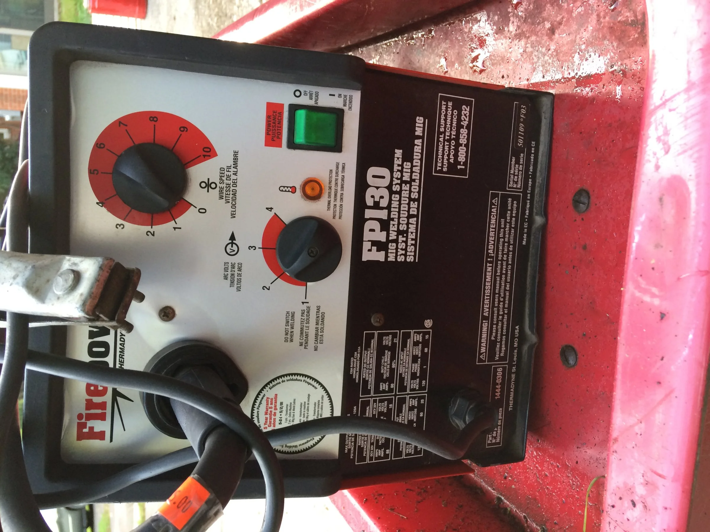

I picked this baby up today from my local pawn shop. It's a fire power fp130 company. What's the best company to order my new floor any input would be great .

There you go! Get after it!
Anyone of the places is fine, generally they all come from the same manufacturer. LMR has been good to me and I got my floorboards from them.
I'm not knocking CJ Ponly Parts, or any of the other guys. I just know the LMR's customer service has been spectacular for me.
Is there a gas bottle with this system? You're gonna have a hard time welding sheet metal if this is a flux core only.
#1. Sheet metal is the single hardest steel to try and learn on when learning to weld. Even for seasoned welders with good equipment, it's real easy to make a mess, real quick.
Flux core burns hotter than mig wire at the same setting, and by the time you get enough amperage set to melt adequately, it's too hot to weld sheet metal. Add in the fact that one of the two metals you're trying to weld to is galvanized, and you have a real challenge in front of you.
#2. Alternately, it makes a mess as it is, with all the spatter, and smoke residue, if you can get it low enough to not burn through, then you have an even bigger mess to deal with.
If you've read anything I write, you'll know that I'm way less of a "you can do it" optimist when it comes to some areas of expertise. I think it's far better to let you know what you're up against before you burn through, warp, and have to compromise the welds by grinding the welded sheet metal back down to get them tolerable enough to consider the body work that follows.

If you are going to weld galvanized steel, you'll need to remove the galvanized coating before you start welding. Acid etch treatment, wire brushing with a power tool are just some of the more common methods. Zinc fumes are toxic and use of a chemical respirator is recommended when heat is applied to galvanized metal..
The last time I welded galvanized metal was back in the 70's using an oxygen/acetylene torch. Burn the zinc off with the first pass of the torch and wire brush it when you finish with the torch.Then go back and weld the steel. The gas torch worked well enough to do the job, even though I never was much of a welder. It was simple to control the heat as long as you have the correct size tip.

No worries and thanks for the info. I will not be doing this by myself. I got the welder from my uncle who is a welder and welding supply salesman. He will be helping me through out the project.
