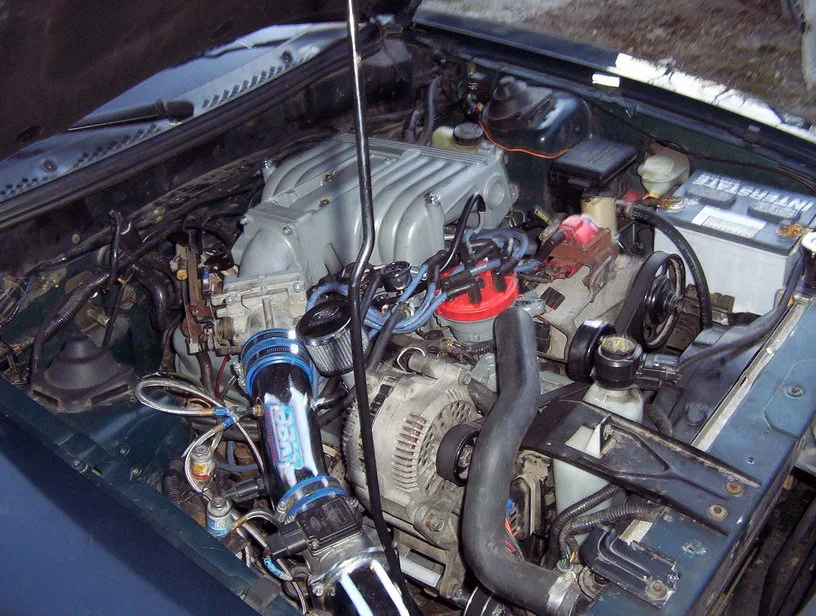

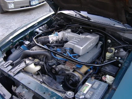

i did mine like 2 years ago. never used it anyway and i think i needed a compressor. i took it out when i did my heads the fist time, so had the radiator out anyway. you pretty much just unplug/unbolt everything and thats it. oh, and you need the shorter belt too.
this year
last years set up
