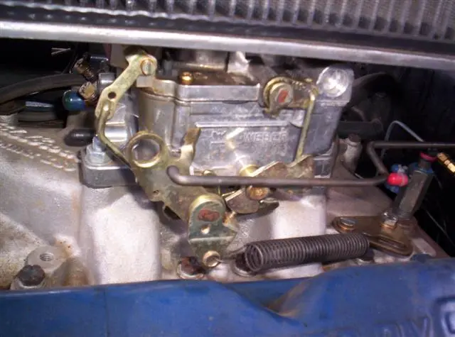

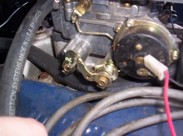

if you look on the top driver side of the carb in the front most part, you should see this plastic piece sticking up that has some linkage attached to it. that is your accl. pump. you can see 3 holes. the one that is at the very bottom will give the biggest squrit and the higher you go, the small that amount. where is yours at?
this is all i see (looks to be the middle hole).....and the accel squirt wouldnt have just become a problem now after its been fine for 8 months would it?
