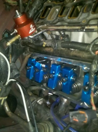

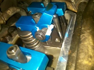

i know someelse just posted a simn thread but i can't seem to find it. i need to get a real set of rockers now looking for suggestions. someone said they liked the harlands but they seem to be the same design but probably made of better materials. i;ve got tfs 185's so was thinking of going with tfs rockers anyone have any experience with these? if the guy that posted the last thread sees this shoot me a m,essage just want to know of anything else this might of caused that ki need to look for

ouch! i may change my winter project from a new rad and hoses to new rockers!
how hard were you running when that happend? any damage to the pushrod?
I was idling at a light. I heard a "Dink" from up front it started to idle a little rough and shook like hell over 1500 rpm. By the time u got home it was blowing a ton of smoke
My only hope is that it didn't mess up the lifter or can. After seeing the other post with strikingly similar pics I'd say if you or anyone else has proforma make it a top priority to help the environment and recycle some low grade aluminum
Haven't had a chance to tear that deep into it yet. I wanted the rockers right away soil could measure. For new pusheids. Ill post the autopsy results soon ad they're in

I got lucky the lifter shot the push rod up so hard it wedged itself very high between the cobver rail and the broken arm and stayed away from the moving parts. The lifter also shot up but just hard enough to jam itself on the wishbone but not dislodge it so the sister lifter stayed clocked correctly and i didn't loose oil press and wipe the whole engine. I'll change the lifter out just for good measure though.
I have to say the COMP CAMS C/M pushrod held up GREAT, snapped the rocker got jammed as i said ealier but it's still straight as an arrow.
