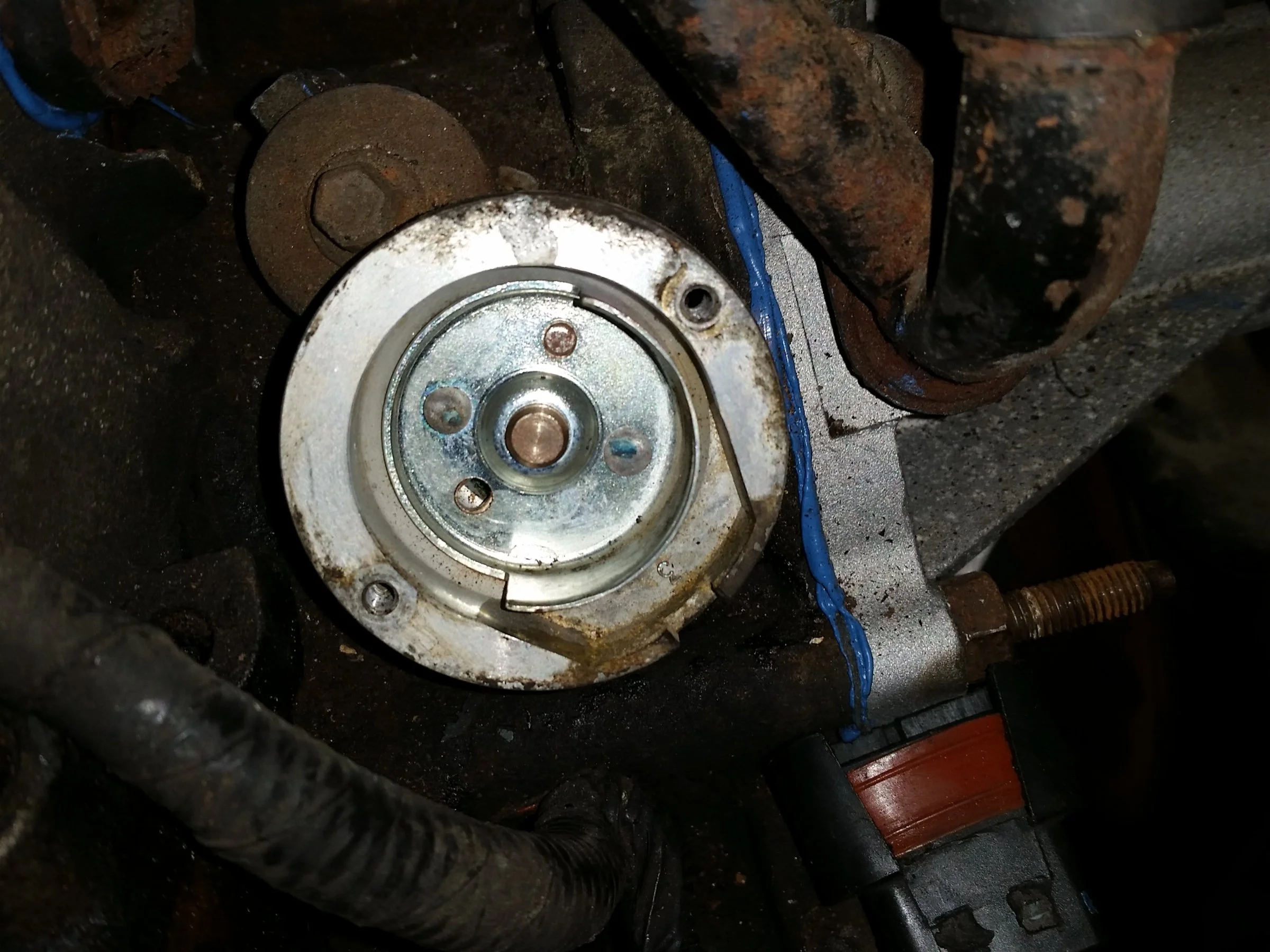

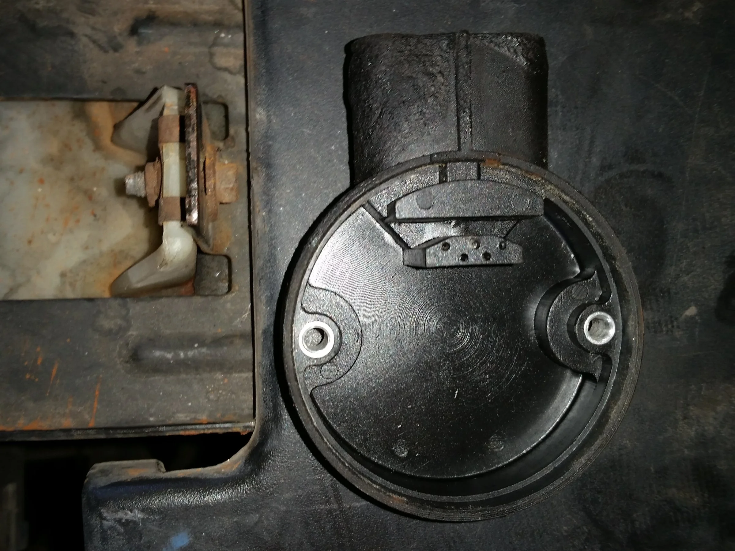

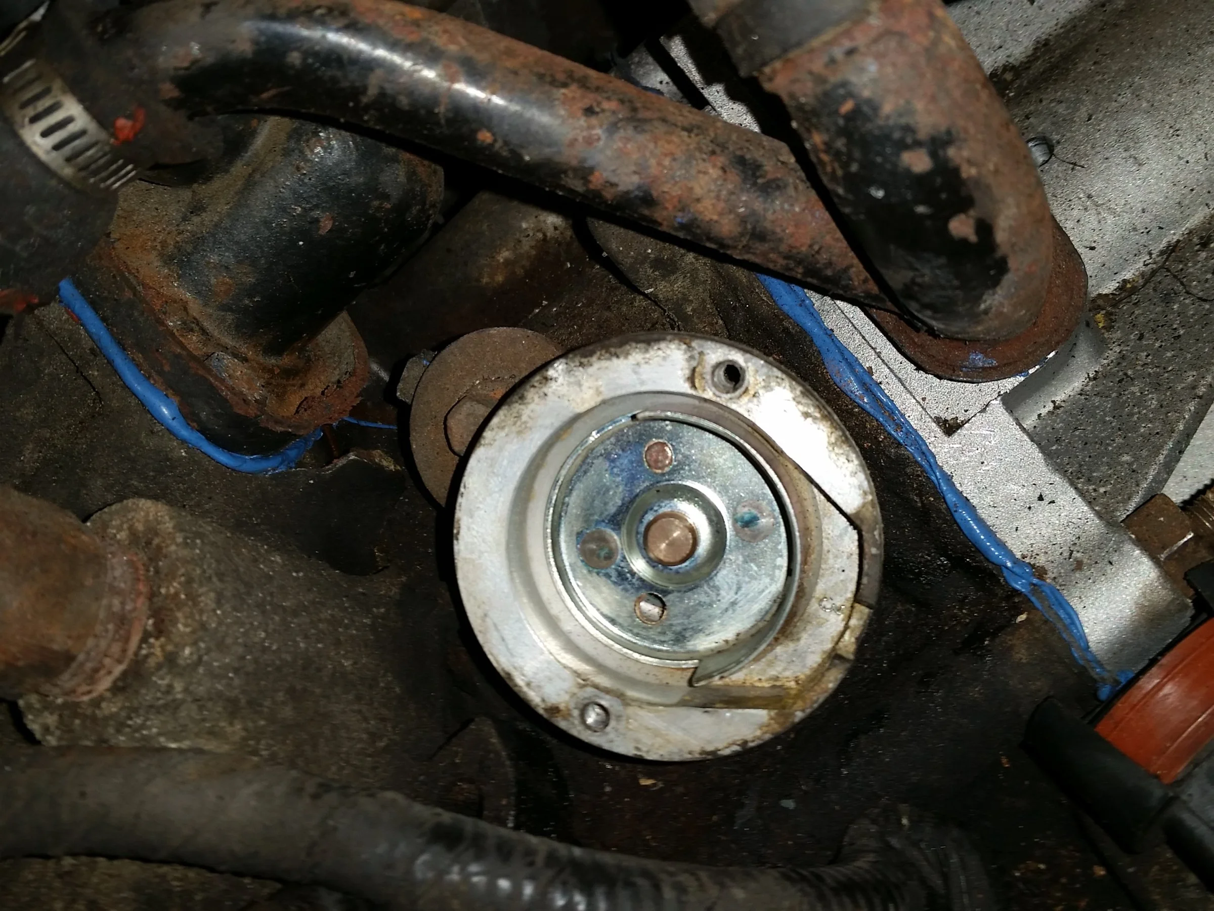

Okay I removed my cam sensor. Here's some photos.
I don't know how to tell if my cam synchronizer is bad or not. I do hear a whining but it could be one of my pulleys. But here's some photos of the synchronizer inside.
I'm completely confused with this part I don't want to ruin my engine.
Can anybody advise me if it's just my cam positioning sensor, for the po340.
Or is there something that looks strange on my cam synchronizer?
I'll keep checking my phone I'm in my garage thank you

It's fixed. The cam synchronizer seemed fine. Replaced the cam sensor. Light stayed out after about 10 mile. Muse be okay.
