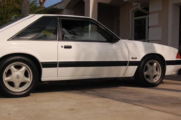

This is about what it took me. I'm running the FRPP 'B' springs and really like the stance. I'm running 245/50/16's and don't have any rubbing issues. I's also running stock replacement shocks and don't have any issue. Not the smoothest car I've ever ridden in, but it is 22 years old. Here's a pic as well.

I like how yours sits. How much lower does the B springs make your car?

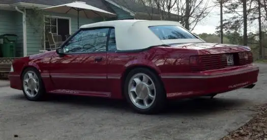

I rode on the B springs for a few years but they were a bit on the stiff side and I didn't mind. But my wife drives the vert from time to time and she was complaining about the ride. LOL
So, last year George and I tackled it again and swap the B's for a set of Saleen Racecraft springs that we had previously removed from my SSC. The Racecraft springs are notorious for sagging in the rear over time so I had replaced them with Eibachs.
We cut a half coil off the front springs to compensate for the sag in the rears and reinstalled them on my vert. I looks (and rides) real nice now.
Sits perfect, don't you think?

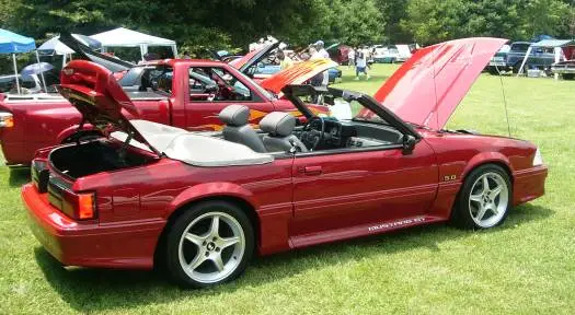

I've got an old 7000 lb floor jack. Oddly enough it slides right under my Fox cars with no problems. That included 3 cars, one with B springs (sold), one with "cut" Racecrafts (pic), and one with Eibach Pro-Kit.
However, if they were a 1/2" lower my jack would not work.
Guess I got lucky

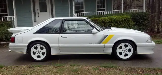

For reference, here's my SSC with the Eibach Pro-Kit with Maximum Motorsports isolaters.

It was around 3/4" - 1". I've barely got 1 finger gap in the front and a little over 1 in the back.

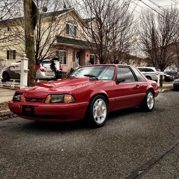

I have the pro kit in my car with no lower iso in the front and poly iso s out back and tockico front and rear shock and struts and i love it.
