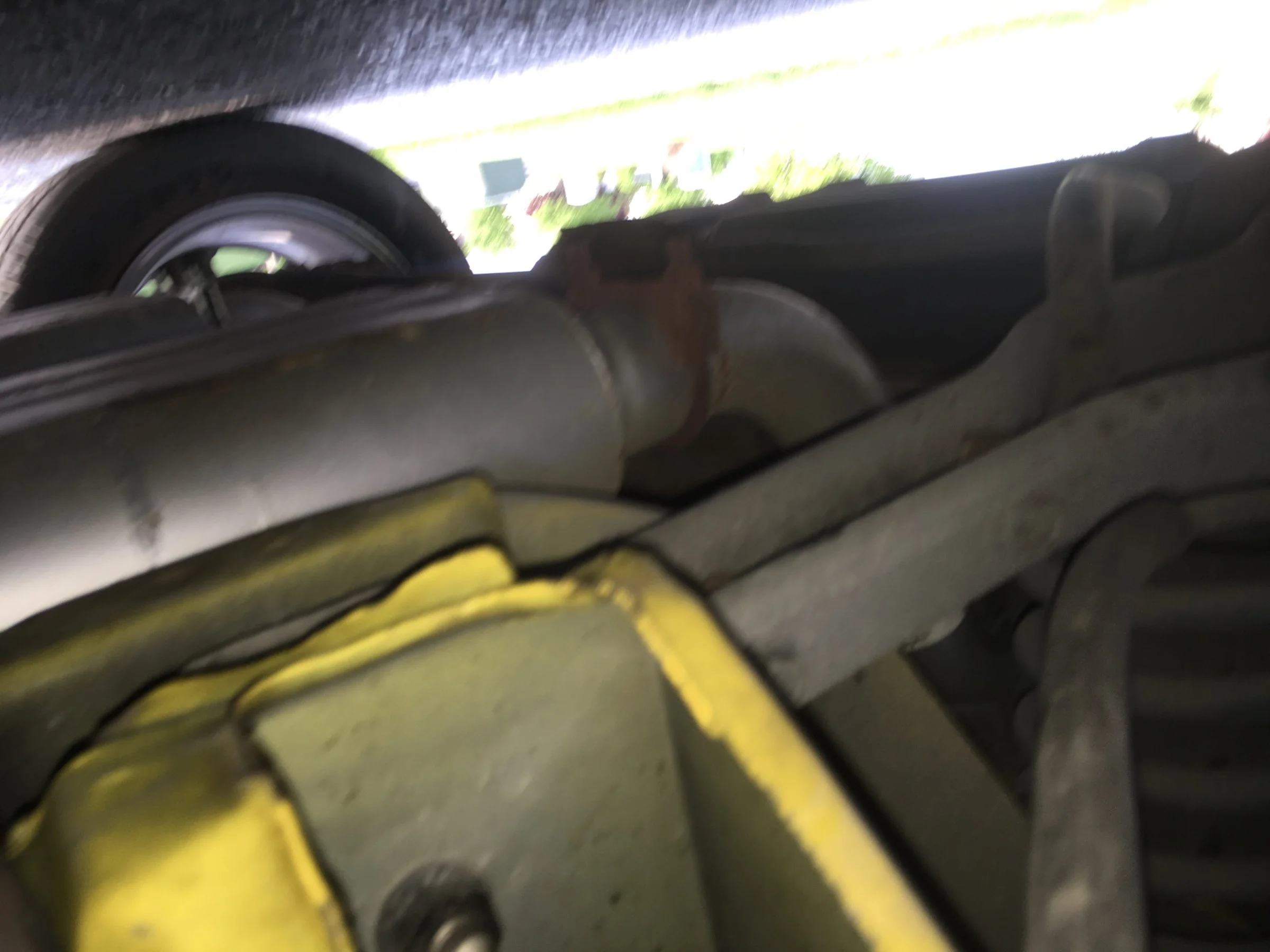

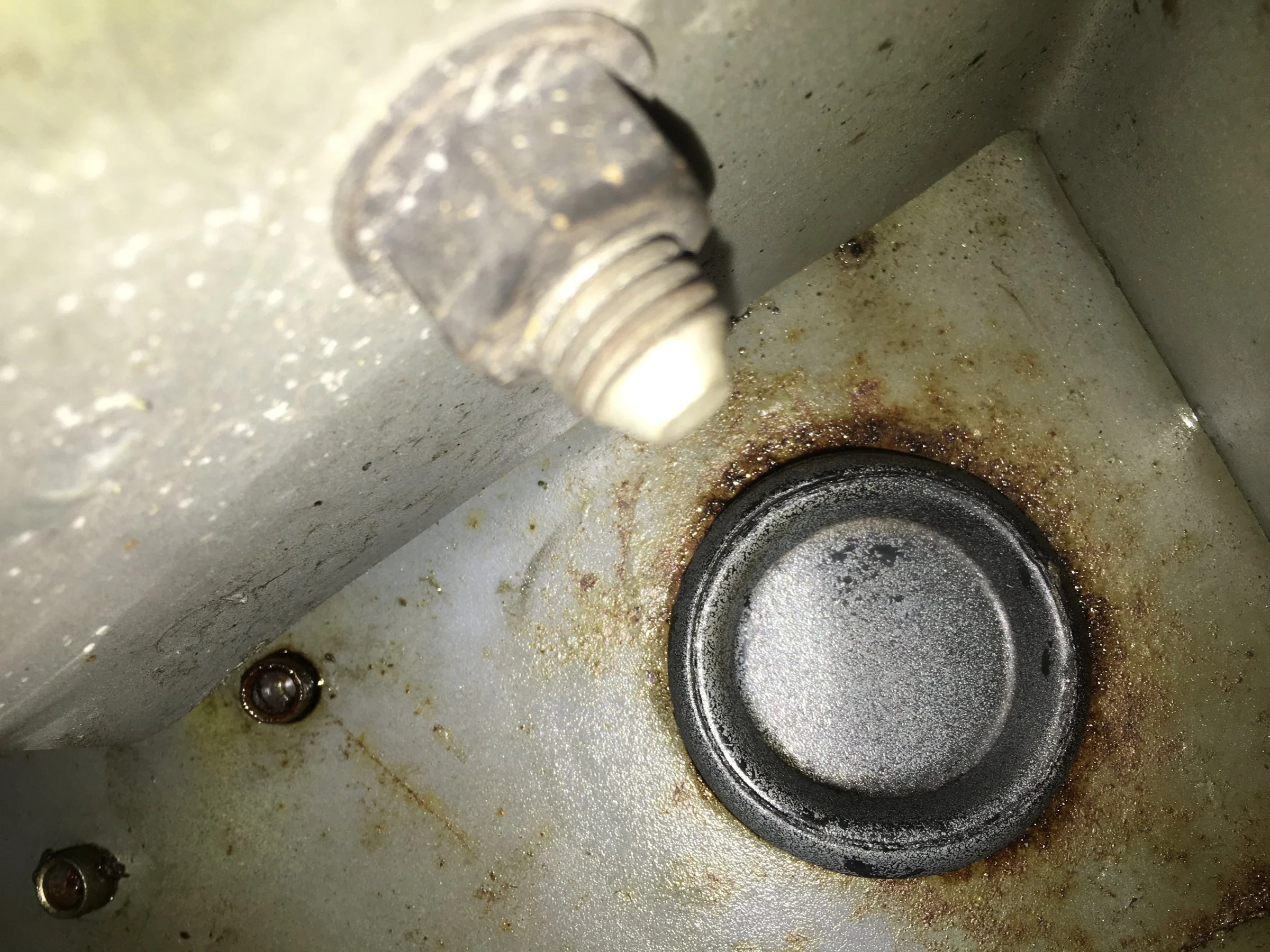

OXROX New Member May 20, 2016 8 0 1 May 20, 2016 #1 May 20, 2016 #1 Found a small drip on my 93 vert in front of right rear tire. Doesn't appear to be brake fluid as brakes are ok and no residue on line or wheel. It looks like oil. Appears to be coming from this "plug" on the frame. Any insight is appreciated.

89oem Mustang Master Dec 18, 2013 1,456 542 144 May 21, 2016 #2 May 21, 2016 #2 Hydraulic fluid from the top lift system. Pull the cover off in the hold or easier. Remove rear seat and seat back and you'll have full access Reactions: RangerJoe and smkshw
