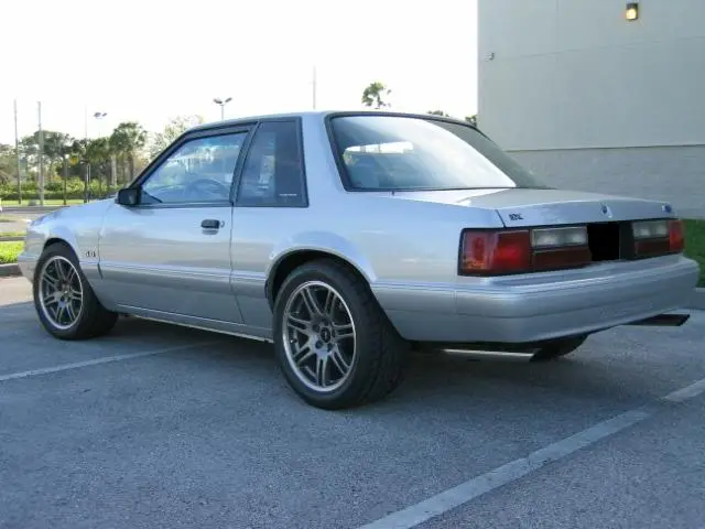

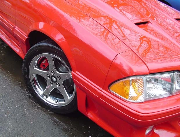

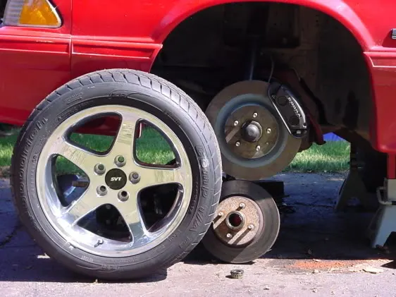

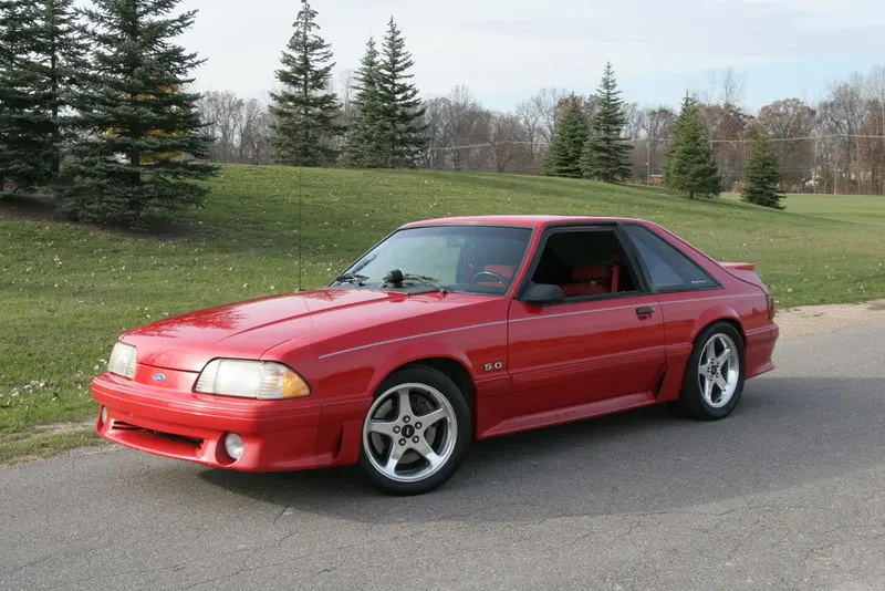

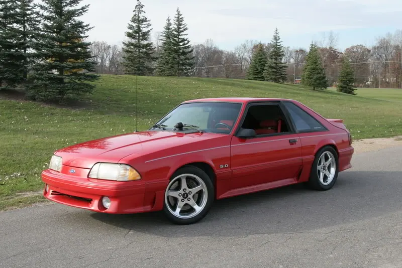

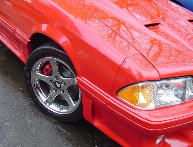

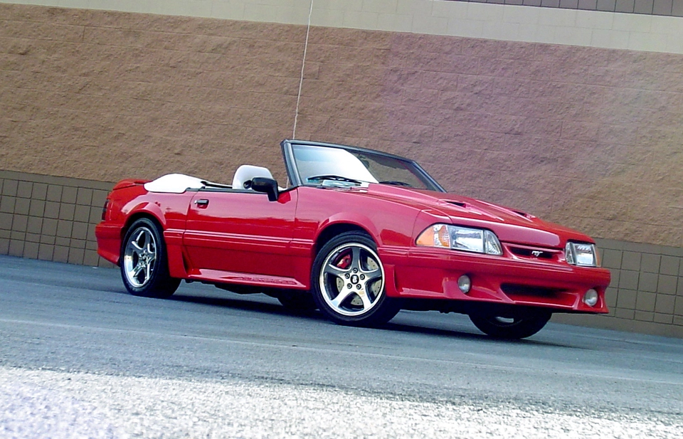

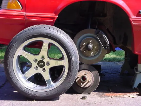

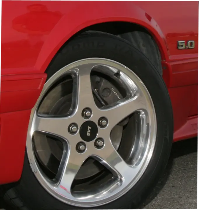

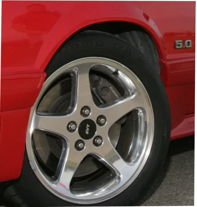

'01 Cobras (and 99's, same thing) were 17x8 and came polished. The 03/04 premium GTs had the same rim, but chromed.
Anyway, here ya go:
I'm pretty sure you'll have no issues because they're not 8" up front. If anything you might need the larger 91-93 front spats to accept the 17" wheel, but that may not be a problem at all.
The ones you posted are '03 Cobras. Not 99/01 Cobras / 03/04 premium GTs. Similar but different at the hub area and in width.
I have no idea the offset, but they're whatever the stock specs are for the SN95s.
they are a 17x9 with +24mm offset.
do you recall the offset on yours? it appears they are set in a little bit more than some of the other brands ive seen. correct me if im wrong, :shrug:
That's not an '01 SVT wheel. That's the 03/04 SVT wheel. 17x9"
May have some fit issues with it. Definitely will need the Sn94 conversion. Mark 7 rotors won't cut it but even so, the front wheels may stick out.

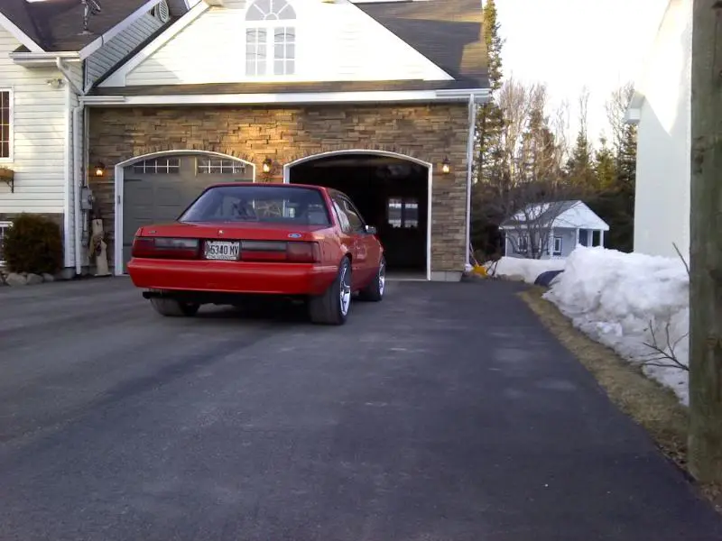

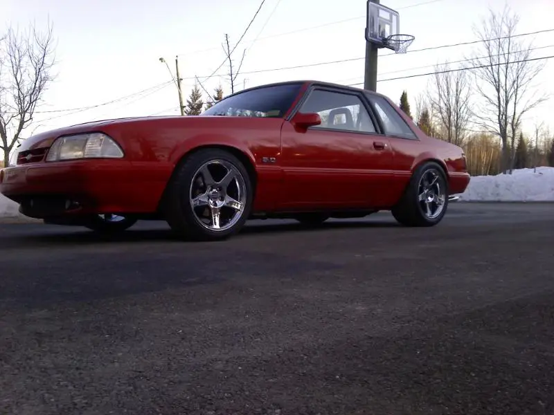

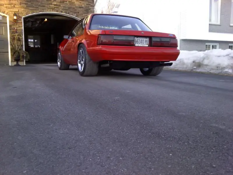

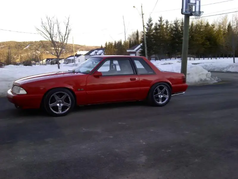

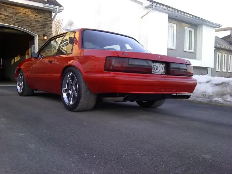

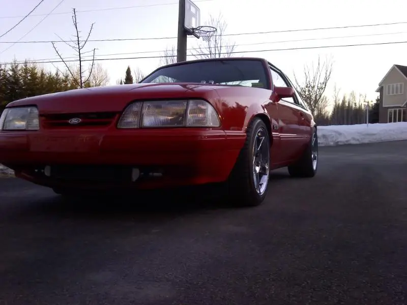

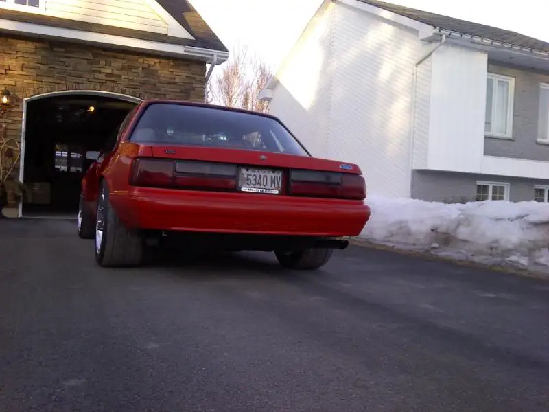

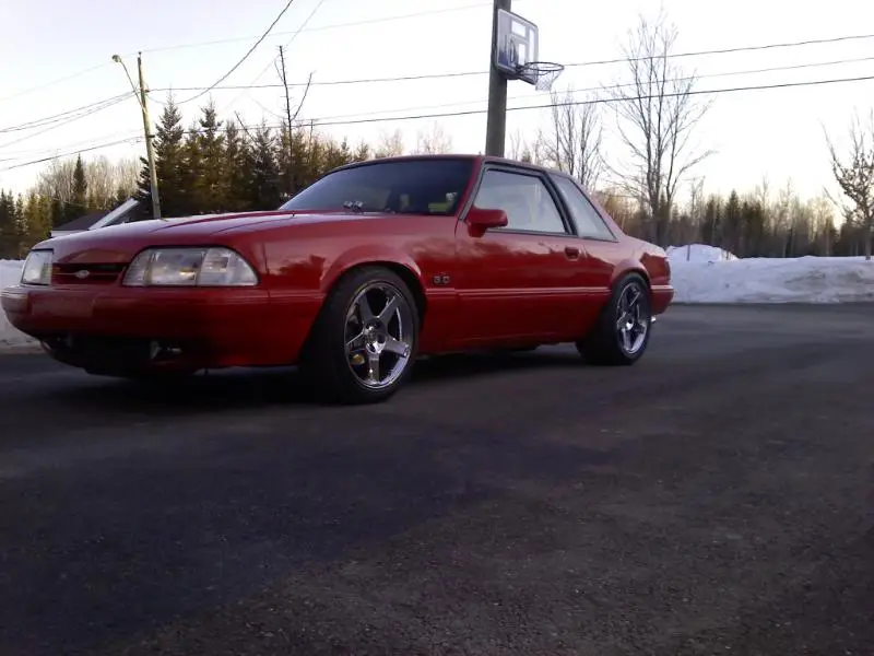

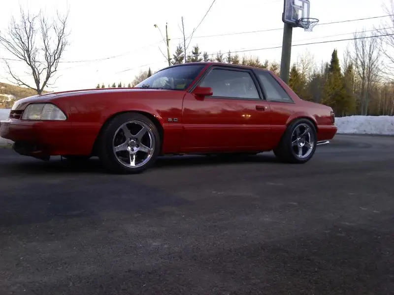

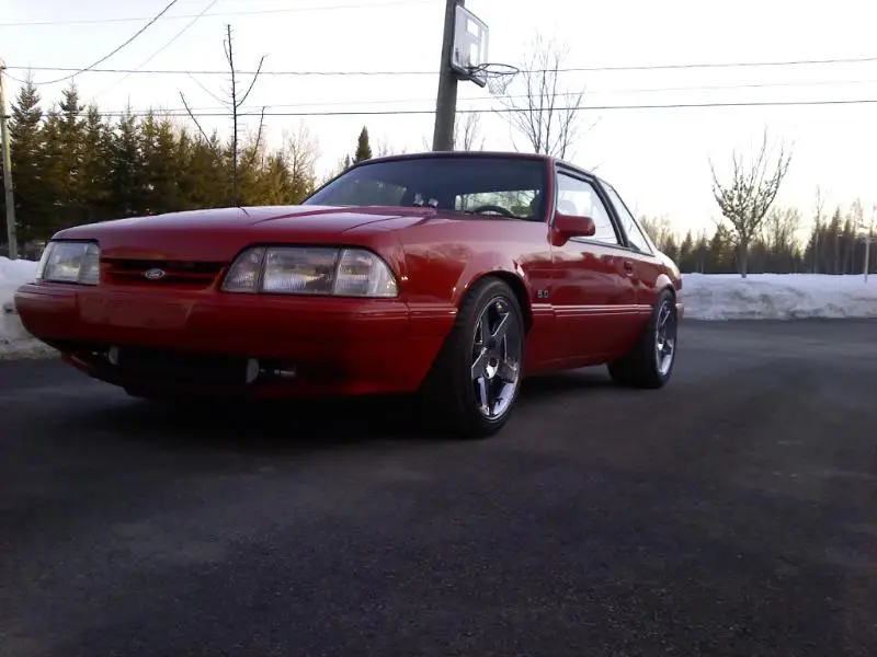

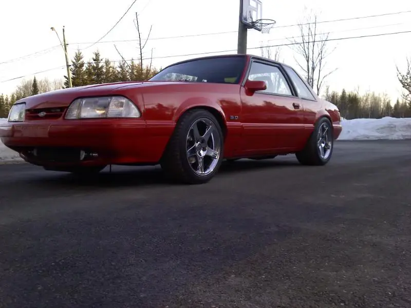

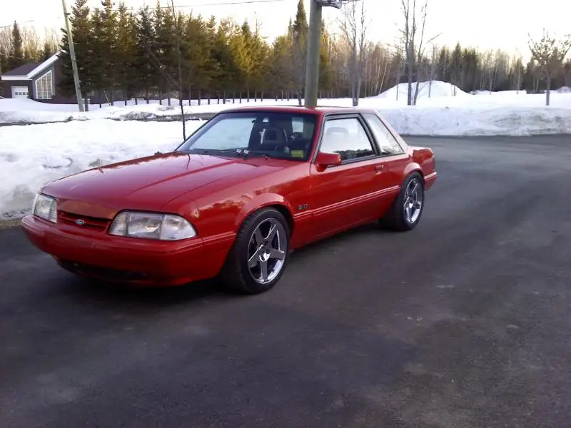

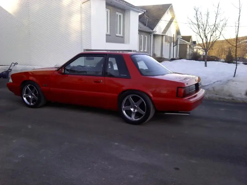

Here's mine, dont mind the front ride height. the front end was off the ground for about 2 months before these pics were taken, so it has to settle again...
I havent gotten a chance to drive it since I put the wheels on, so I dont know if they will rub or not, but just from looking at it I think i will be fine on the front wheels, and the rear will clear no problem once I flip the quad shocks. The tires are 255/40/17 up front and 275/40/17 in the rear.
edit; the wheels are originals off an 03' Cobra, so they're machine finish, not chrome/silver/polished. just FYI.
