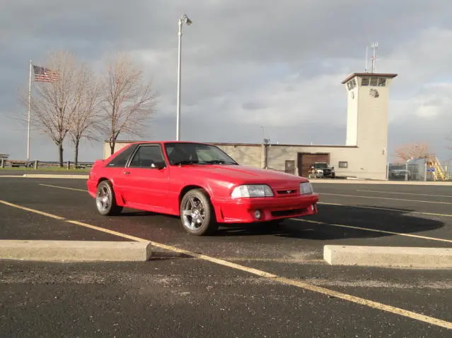

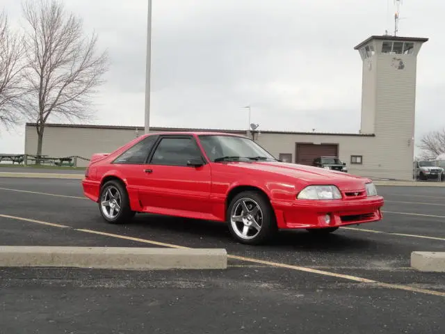

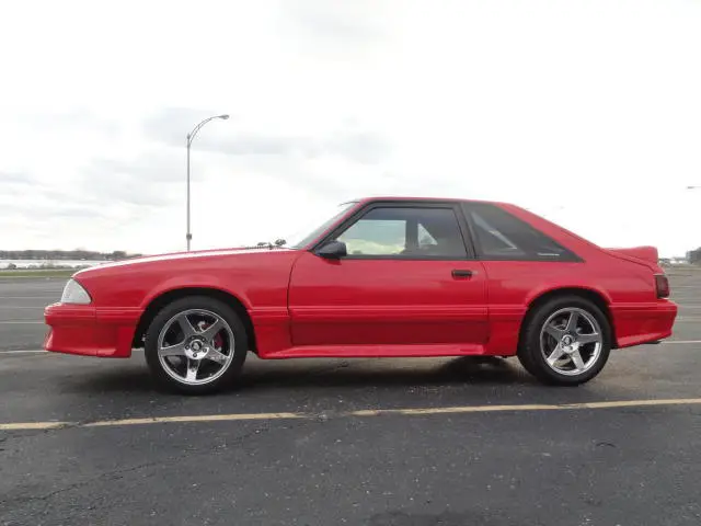

Yes 17x9 front with 255/40's I think that size tire is the best fit. I have FMS B springs cut to get the ride height right. I wouldn't know how many coils I cut out because I 1/4 coil at a time and it took me 4 times setting up the front and back to get it right.

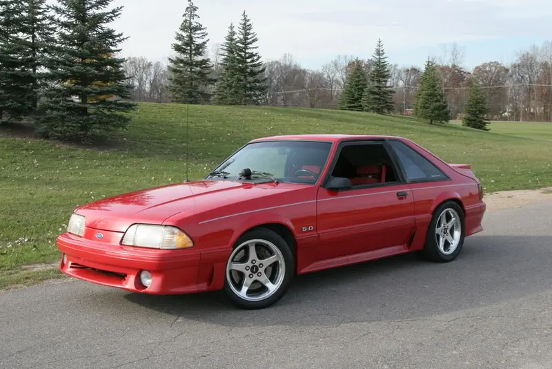

My current mod fox.

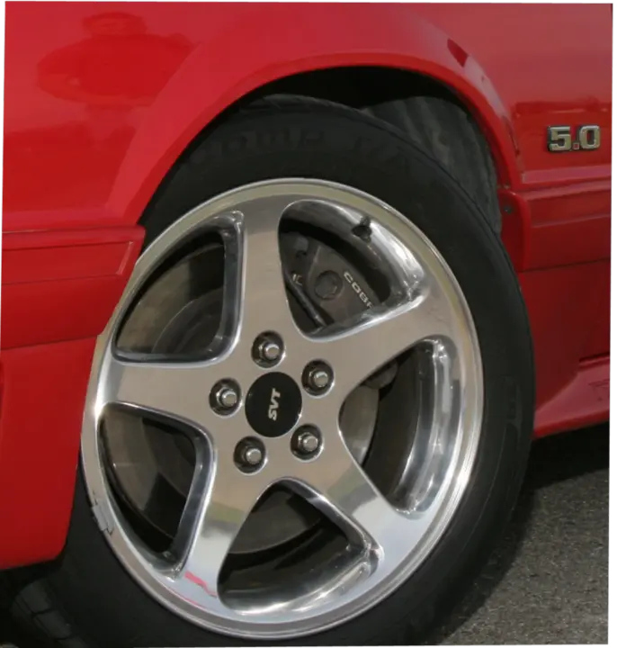

'01 Cobras (and 99's, same thing) were 17x8 and came polished. The 03/04 premium GTs had the same rim, but chromed.

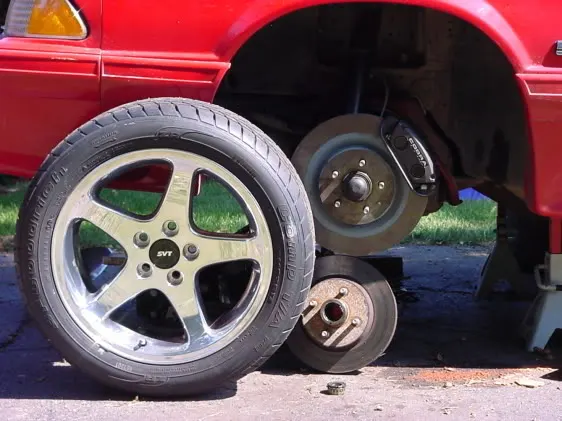

Anyway, here ya go:
