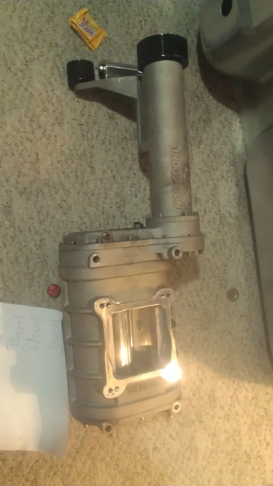

My setup was on a fox so it may be a little different. I had to get an alternator relocation bracket, electric fan, boost ref. carb, boost retard box(vortech), and a 140+GPH Electric In-line fuel pump. I think that's everything. Ran it at idle, but under load the fuel bowls would bleed dry. Ending up going a different route. With that said that blower is the coolest sounding thing ever. A jet plane is close to comparison :D. Definitely forged pistons as well.

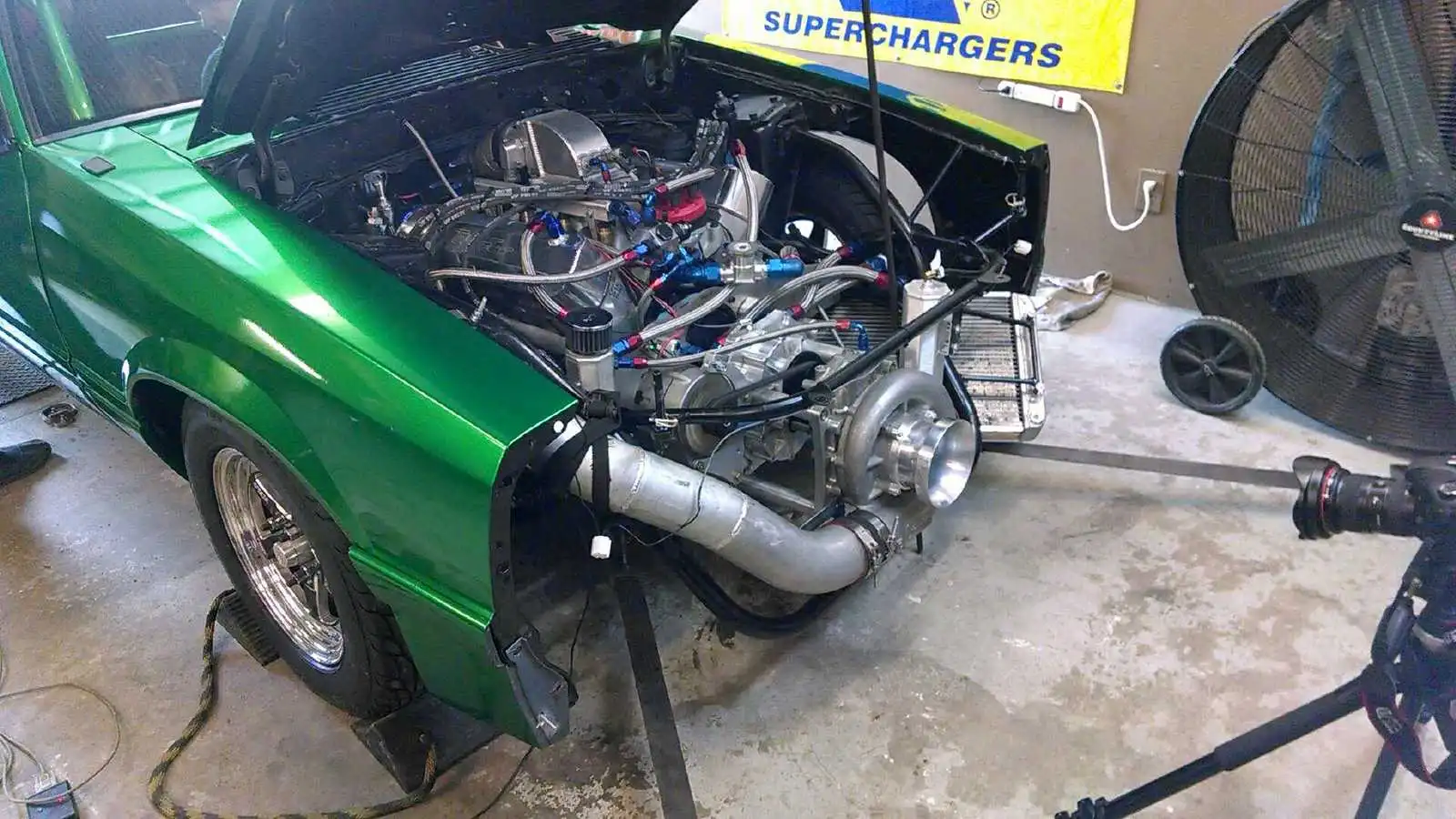

Do you have more information on the Ford Racing long block? If it does not have forged pistons I would consider going another route. What are your ultimate HP goals? Are you totally sold on a roots style blower? The reason for the last question comes down to a matter of efficiency. The newer centrifugal style blowers are leaps and bounds more efficient than the older style roots blowers. They produce less heat, more boost and more horsepower all while being more reliable. This is a centrifugal with a carb enclosure on sbc, it would be very similar in an application like yours as well.

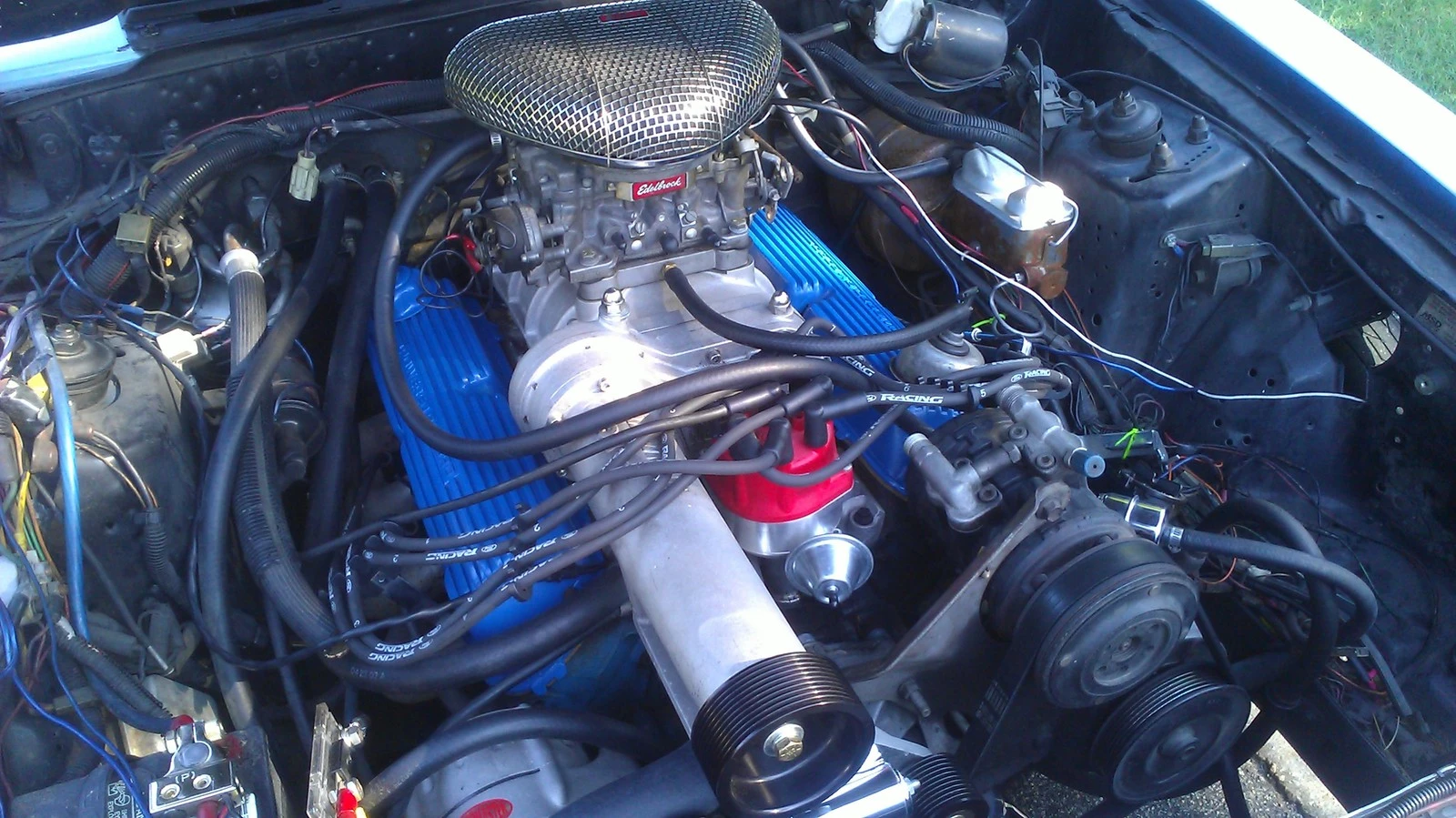

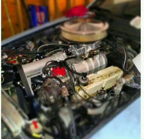

Clears dizzy just fine. Here's pics of mine.

Depending on which blower you decide on and which distributer you use it may or may not work... This isn't what you want to hear I'm sure. If you choose a bigger 6-71 style blower you need to be very careful with clearance. The manufacture should make very specific recommendations for the type of distributor. An hei type cap will more than likely not work and you will probably find yourself using a small distributor cap.
