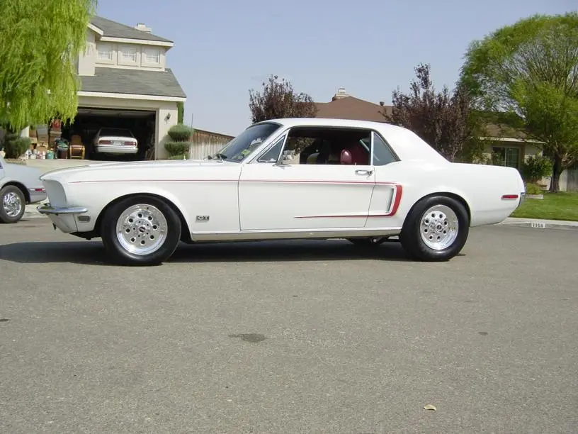

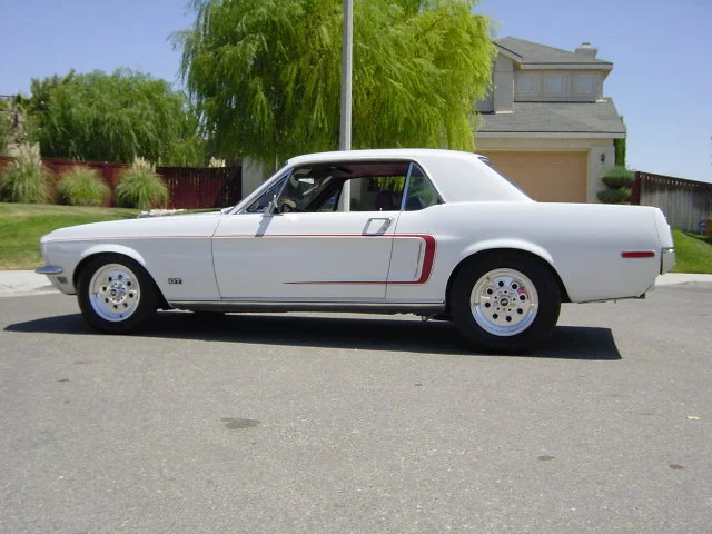

I know it's not a coupe, but I have yet to be sorry I dropped my car. It's street only and rides better, handles better and (my opinion only) looks better than it possibly would have if it were stock height. The stance is the mort important part of getting the look right.
I lowered mine 1.5"? in the front and dearched cal-trac split leafs in the rear. They closed the strip in my area, so mostly street, but a strip car. Love the look, love the way it performs, wouldn't have it any other way.
