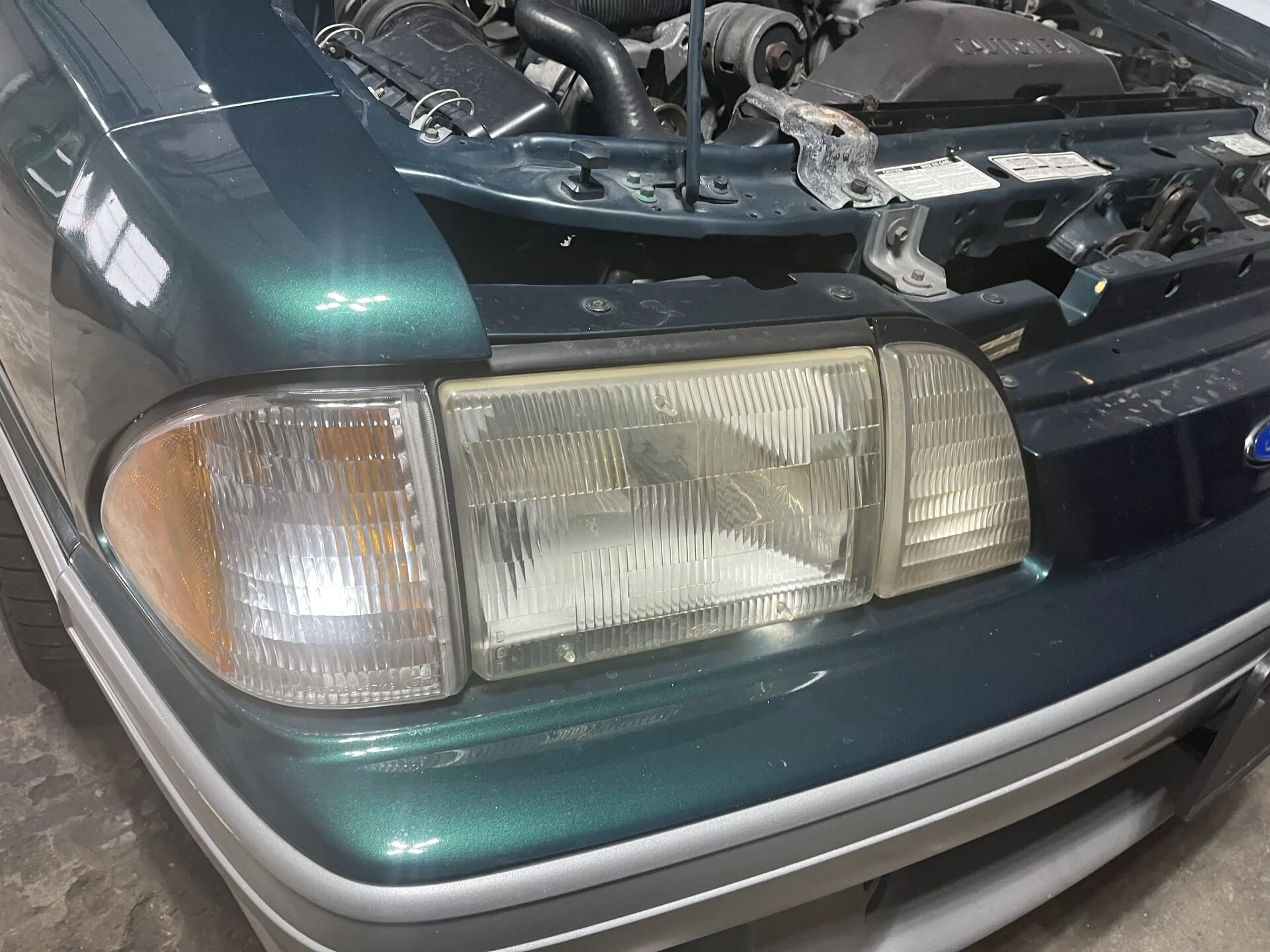

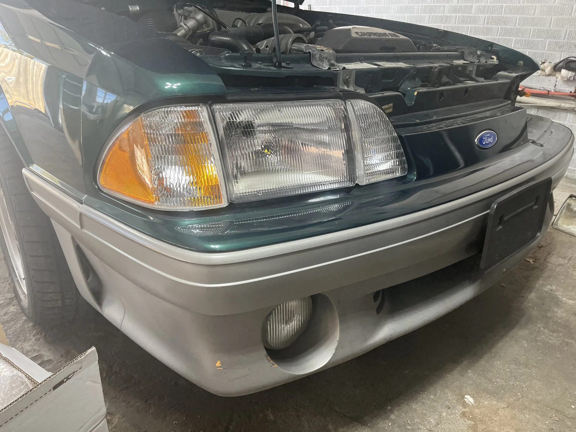

Some before and after. Could use a little adjusting , but much better.
