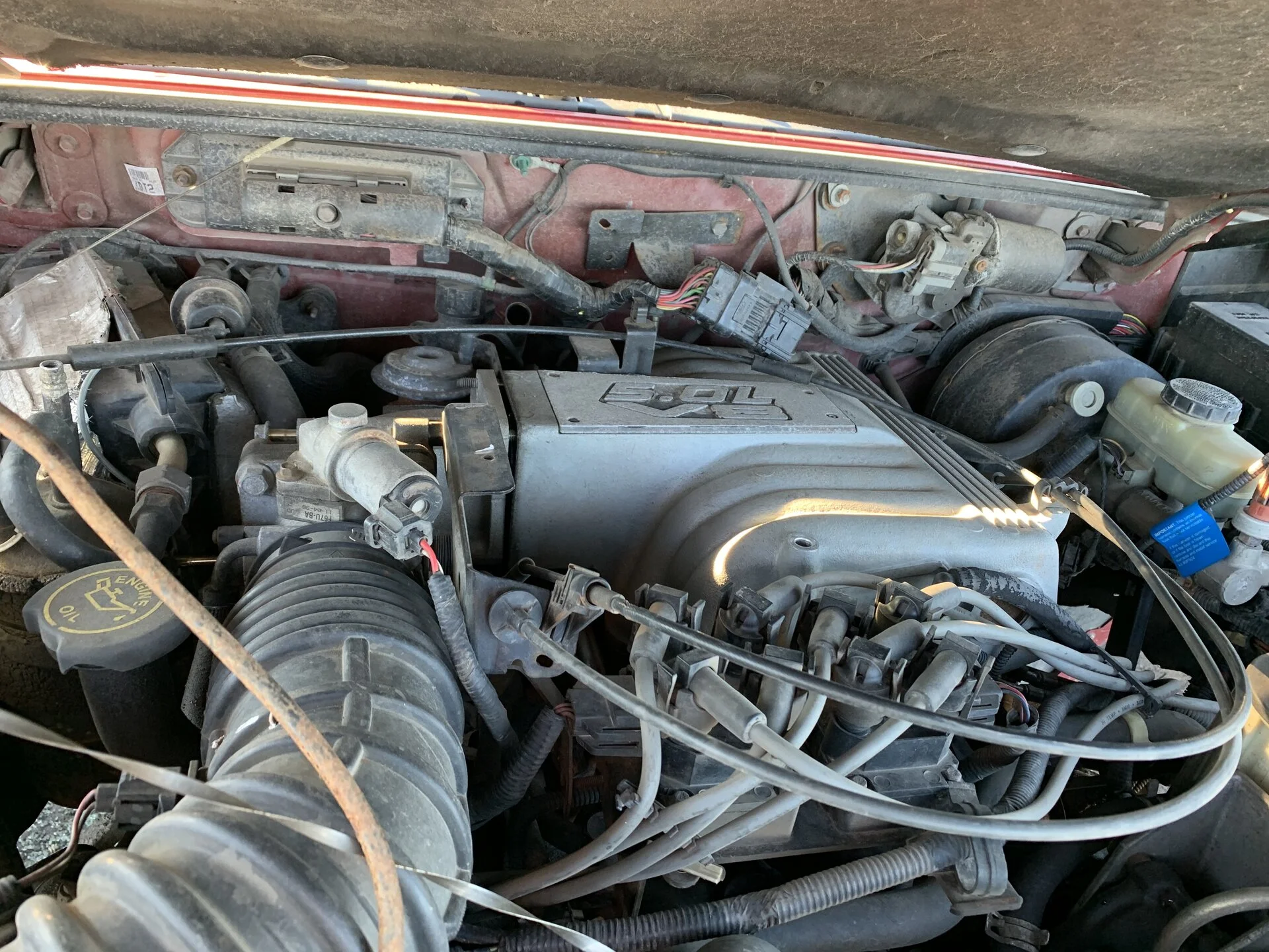

There you go. There is also some company out there that makes a factory looking "5.0 HO" intake plate to fit on an Explorer intake.
Kurt
That company would be Ford ;)
The stock HO plate fits on fine.

The only real difference on the intake plate is that two of the holes in the Explorer upper are left undrilled. You have to drill and tap those holes if you want to use all four mounting screws.

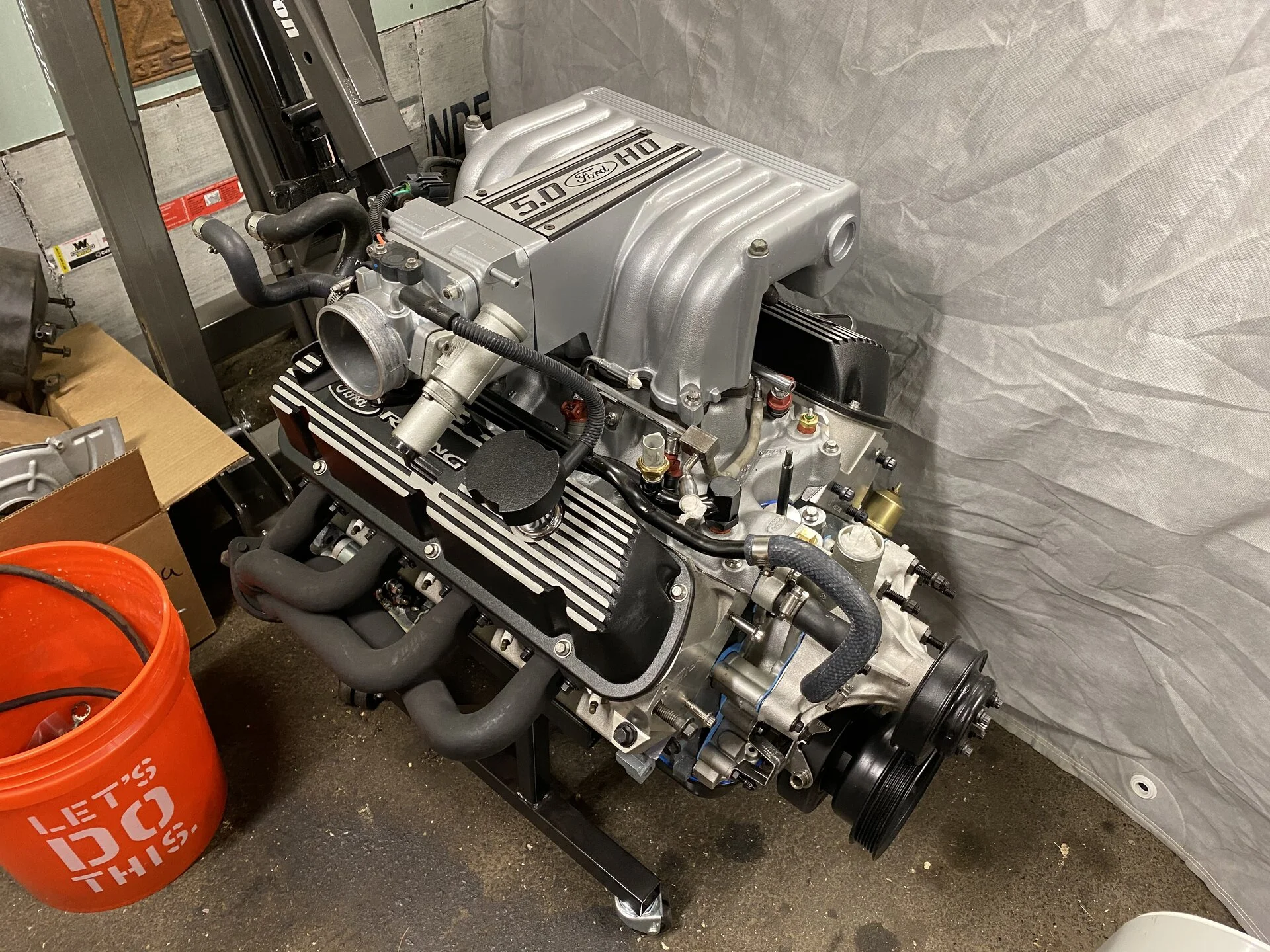

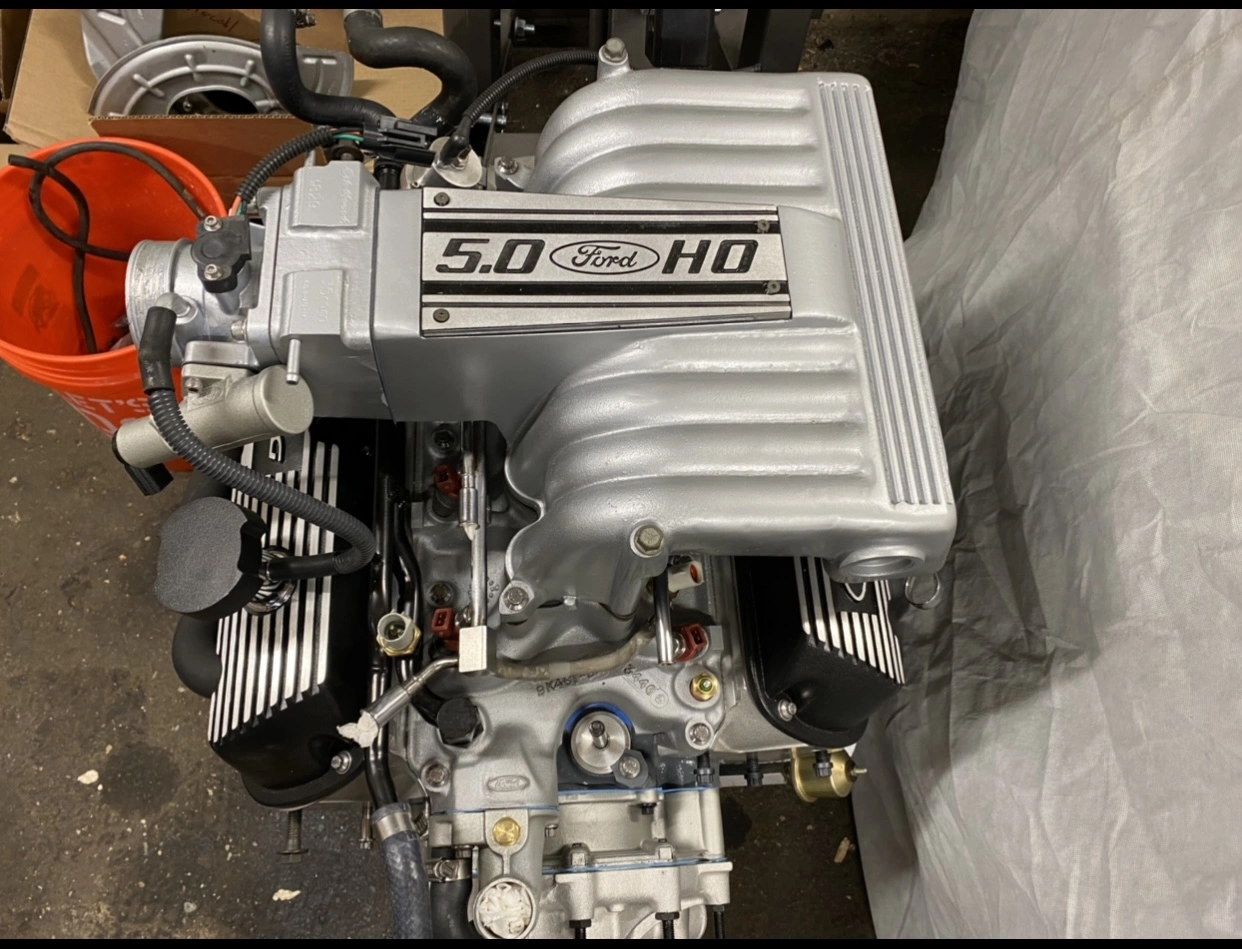

here’s mine, but I’m actually going to run a 93 cobra intake. This one will be a wall-hanger
I put a little extra work into it to make it look like a stock HO intake. Ground the nub off the side and took off some casting flash to smooth it up a bit like the HO upper.

That’s exactly what I want to do with the intake I have. Going to go on my Mercury eventually.
