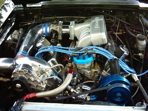

Here's a pic of a car with one installed, drivers side YS trim. It requires the use of the 8" Renegade lower pulley. The Kurgan Motorsports piece is much stronger then the Vortech piece. On a Passenger side mount it will require a modified upper hose set-up the rad hose needs to be on the other side.
