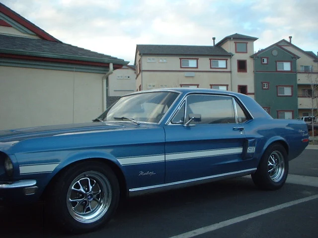

All of the GT/CS cars were coupes with side scoops. I think they look good :nice:

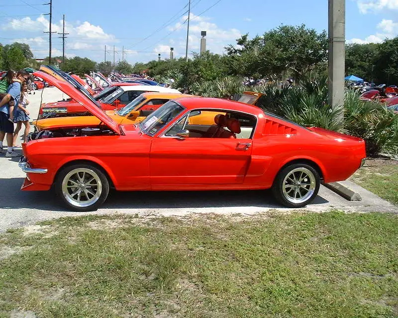

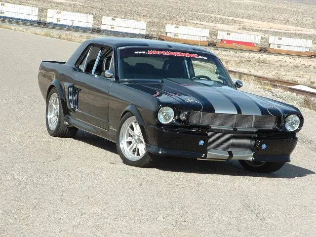

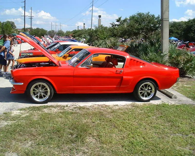

I used to think they looked good...but I've changed my mind, I think no ornaments or scoops looks the best now....if you do put hem on, at least make them functional, to me
I keep going back and forth on whether I like this car....regardless, its the only car I do like the side scoops on
p.s. off topic, I think the E2 kit would look much better with a front bumper

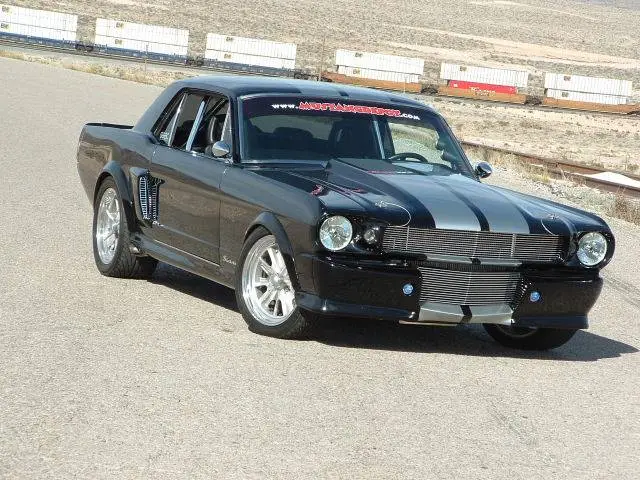

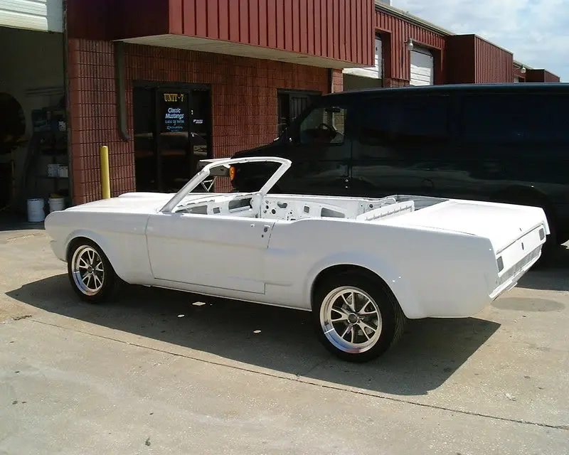

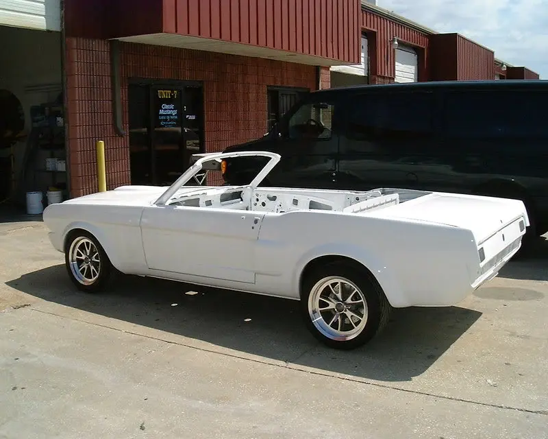

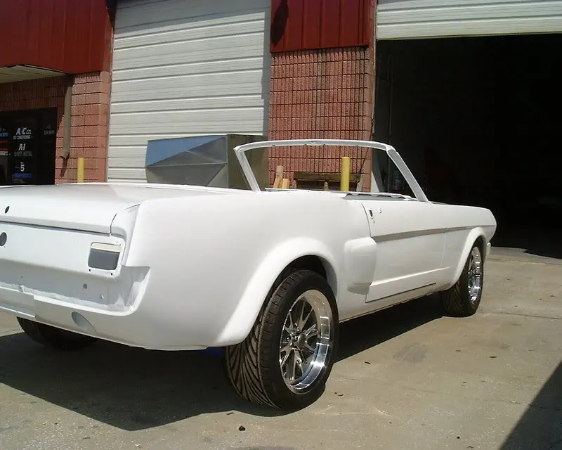

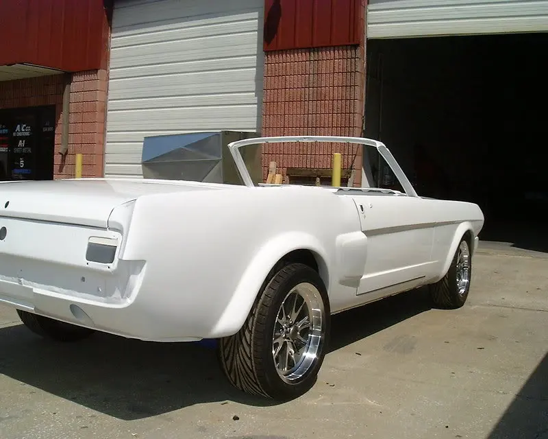

I know it not a coupe but we bonded them on a convertible and fastback. We started to make them functional on the convertible but you can't roll the back window down.

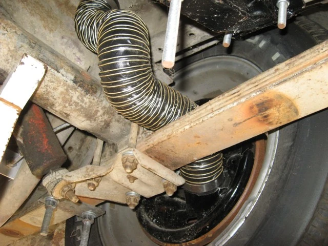

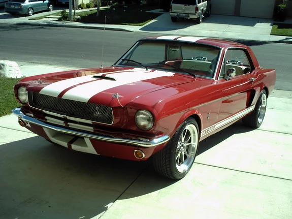

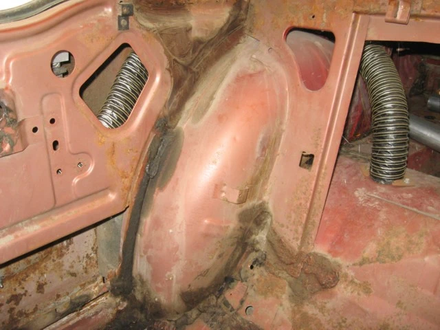

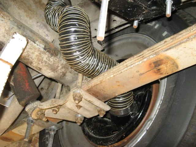

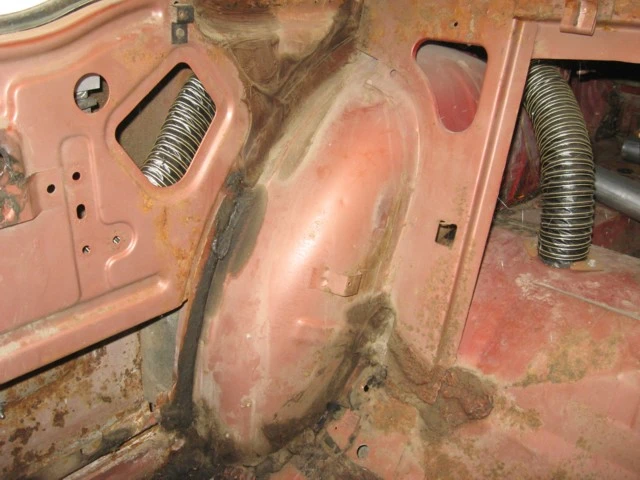

I like scoops. I ran the tubes on my 66 coup all the way to the backing plate. It's just mock-up at this point and the car still needs a lot of work, and a bit of cleaning. :shock:
It look's like overkill to me but they're not fake anymore.

shakkin66, I have seen your car before and really liked it, what type of front end is on it and where did you get it??? Also the rims, what size are you running and type, thanks.....I currently have the r-type front but would like to change to your style with the bumper... thanks
Riddler1, Thanks for the complements on the car! The front is just a the R- Model which uses the bumper that I hacked up back in the 90's with some 3" pvc ground to the correct angle and then glassed in. I was trying to add driving lights.....It looked stupid but I really like the open holes now as I plan on an intercooler at some point and can utilize them then. The wheels are 17x7 I think with 4.25" backspacing. The rears are 8" wide. They are the Torque Thrust IIs and you will hear people say they are too popular but I love them. I have 225s on the front and never scrub but couldnt pull off the 245's I had bought back in the late 90's

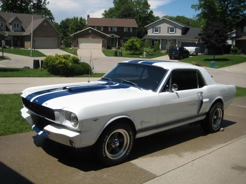

I attached a quick pic there of my mustang, it is also a 66. looking to change the front end to something like what you have, one with a bumper......looking to make some changes sometime soon

I was always wondering how you can keep these functional over a winter, after all that rain+snow+mud+salt mix ends up in the body. slight modification preserving its look would definitely help this design
