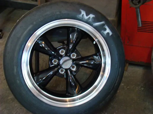

I do!

BannonJr said:
I do!
Those looks like et streets.....not et street drag radials

BannonJr said:
I do!
not a radial. try again

right...didn't read properly...my bad....
