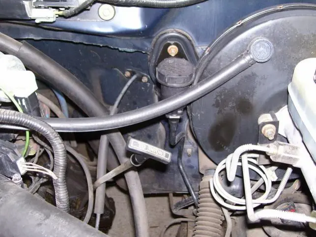

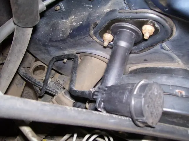

I dont know if this helps but here is the master for a 94 F150. If you want any more pics let me know. I havent messed with the master but have replaced the slave and it wasn't too bad and yes it has the plastic lines.
