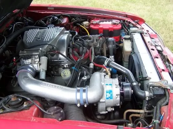

I got one but havent put it on yet. Post some pics up on how u mounted it with the coolant overflow, and im curious how many people on here has one. and how many relays everybody uses, 2 30amps or one 75 amp...Post em up! :SNSign: ...BTW I have two and one is for sale if anyone is looking for one.
Mark Viii fan (similar to the Taurus fan)
DCC controller [FK35] in front of the battery

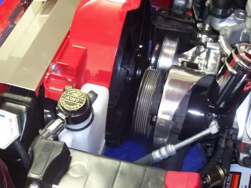

Stock overflow mounted in the stock location (radiator-style zippy ties attach it to the fan shroud)

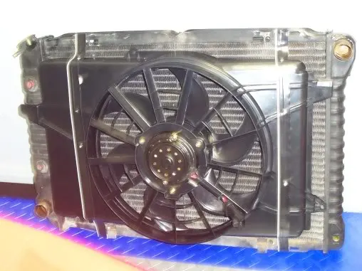

Few picks for some mounting ideas...first fan mocked up on old rad, used aluminum straps to mount to the taurus shroud an top/bottom rails of the rad...

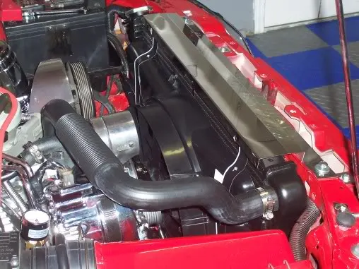

Here are a few of the fan mounted to the stock shroud and in position.
