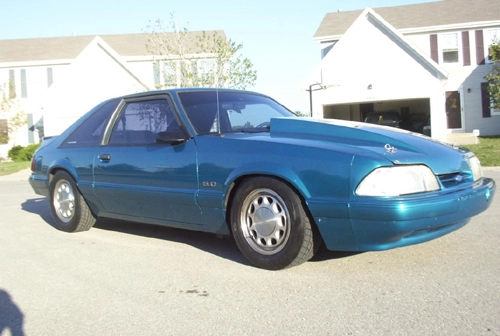

My long tubes sit about 3" from the ground. I really don't have as much problem scraping as I thought I would. Then again my car is lowered big time.
