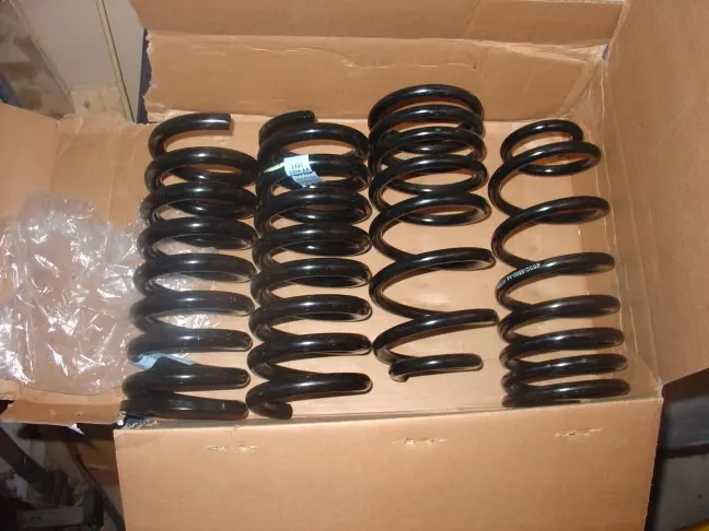

The back of my car sits way too high, and I was browsing the 94-95 section and it looks as if the majority have trimmed the springs to lower a little more.
I have the FMS B springs and it is as if the back didnt lower at all.
Here is a picture of some springs, the back springs have a little side which fits the retainer, and thus probably cannot be trimmed,and what appears to be a flat side, like the fronts which are flat so they seat. Can they be trimmed safely?
see what i mean!?...i know some say it looks good that way but i dont really dig it.

I ran chopped springs for a while, not by choice, I bought em like that...but I wouldnt recommend it personally... Have you let them seat long enough as well? One of the problems with cutting your springs is that you will lose traction, you rely on your springs to be able to put the power to the ground, when you sacrifice the resistance of the coil you will find it hard to keep your tires planted. It may not be that bad with one coil out, but I wouldnt do it personally...
i am running the isolators...i dont remember any on the rear, but maybe that will give me extra drop if they are there and I take them out???? Good, bad, or doesnt make a difference??
I have let them seat for about a year lol...
I am not in real need of keeping tires planted really, i mean the way i drive it 99% of the time....but that is a good point i will look into

Yes you can cut the rear springs.
I would cut no more than 1/3 coil to start, reinstall, and check.
Measure the ride height to the top of the fenderwells BEFORE and after.
If it is too high with 1/3 coil cut, then cut 1/4 coil at a time until it is ok
I cut them with a cutoff wheel, but a torch will work also. Since you are cutting at the end, you should not cause any significant problems with heating the metal, etc, that I can see.
Cutting in short increments also lets you keep it even from side to side, although I have not had the problem.
I have B springs in my Capri, and they were high in the rear, so I cut about a 1/2 coil, like 12 years ago. They have been fine since.
