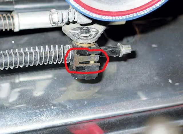

Anyone familiar with this metal clip?
jrenkas
Oct 4, 2009
It's on the kickdown cable of my 88 5.0. I managed to loose it after removing my throttle body. I think it stops the cable from "self-adjusting." Does anyone know where i can get a new one?
Thanks
try a junk yard. and I think its the white or off white pin in the pic that the metal piece is covering that stops the cable moving. you push it up when you want to adjust the cable
