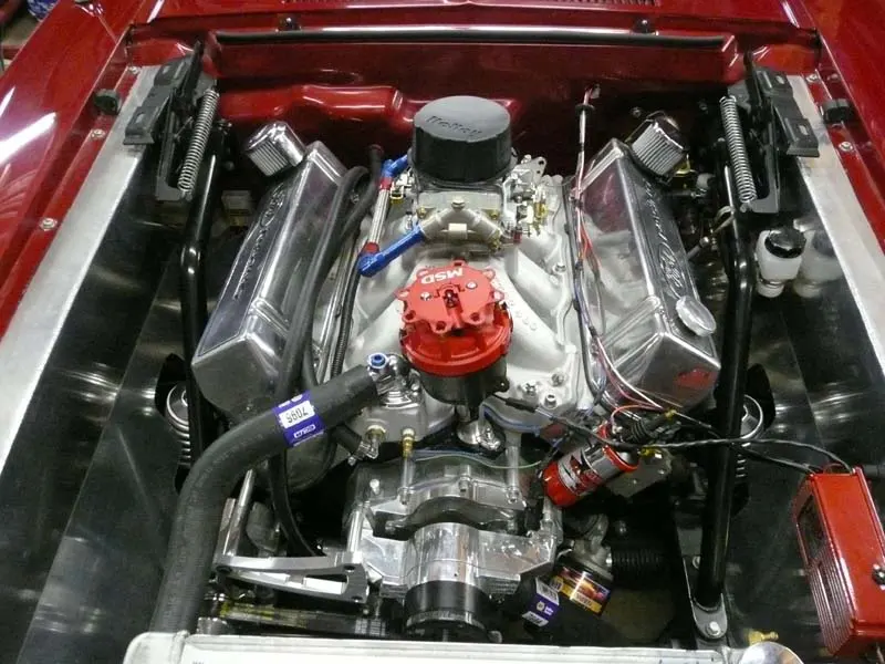

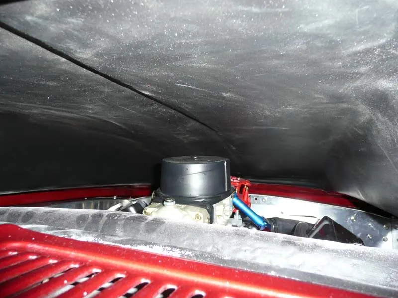

I have a 532 in my 68 Fastback with a custom suspension/frame setup and i am looking for an air filter to fit under my 6 inch cowl which i am not even sure will work still, my engine sits pretty high and i can't get it any lower.
The intake looks like a Victor. Those are pretty tall and cause enough of a clearance problem on their own. The engine appears to be sitting pretty high. Why can't it be lowered any? With the rack & pinion setup and a dual sump pan, you should be able to get the engine down low and help yourself out with the clearance problem. You didn't move the engine back any, did you?
Yea the engine looks to be too far forward to me also. That combined with the Victor intake and it's level carb pad, works against him in hood clearance. The engine's tilted about how a factory install is, but the Vic's carb pad ends up tilting the front of the aircleaner up in the front because it's carb pad is parallel with the axis of the crank. A swap to an RPM intake (or anyother intake) will gain him some room as the carb pads are tilted to compensate for the factory engine install angle.
Looks like you're going to have issues with the distributor clearing as well. You can also see clearly how the Vic intake has the carb tilted up in the front. I had a BB 67 with a 390 and 427 and neither came close to hitting the stock hood with low riser & Medium riser heads and intakes (428PI, 428CJ, the 62-63 3x2 and a stock LR 2x4) The 2x4 cleared the stock hood with 1" spacers and the cast oval aluminum air cleaner housing.

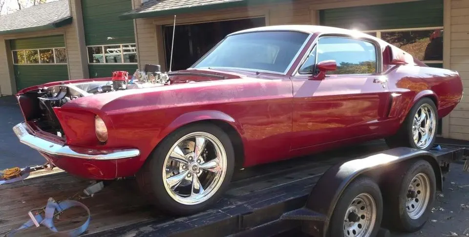

beautiful car, everything about it. maybe a shaker hood set-up, ones that have the big hole in hood, then when closed the filter part fills in gap. either way, please keep us updated with pics. Seeing yours is making me regret selling my full chassis 65 coupe.
I should be starting it in the next couple of weeks, i got the fuel line in today and tomorrow i am going to tackle the dash wiring, thats all i need to do to fire her up. I have a couple minor things to do but the dash wiring is the biggest project left.
That's a good idea on the shaker hood, i'll keep that in mind if the cowl doesn't work. I do have a stock hood i made into a GT500 hood in my garage. i was thinking i could just cut a hole in the scope and have the aircleaner and stuff stick out of it lol. I wanted this car to be a sleeper but look like a GT500. Didn't realize the 460s are so tall.
