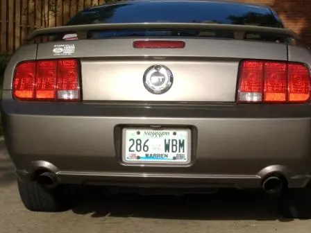

Here are some pics

More pics
as you can see the welding wasn't that great, new piece of pipe is smaller than the stock pipe. I also bought new tips. Cheap chrome one's from O'Reily's. The tips are 3.5 inches in diameter. Also watch your exhaust hangers if the shop uses the stock hanger mounts and the new hangers don't line up in the notches on the mounts you will have a super annoying hanger rattle. I had to take it back to get it fixed.
