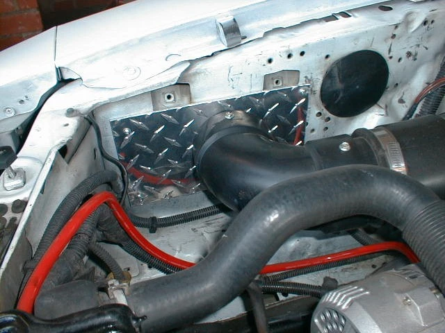

Made mine out of mandrel bent Walker exhaust ells (3.5" upstream of the maf; 3.0" downstream of the maf); rock wool insulation and rubber-stretch tape from Home Depot to insulate it; and various truck intercooler/radiator hoses cut up to form the rubber connectors between components. Aluminum plate to form the cold air box; closed cell insulation to seal to underside of hood. Link to picture below....
http://www.stangcity.com/showphoto.php/photo/2160/cat/500/page/2
