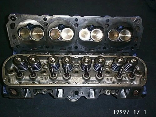

Anyone have a pic or diagram of stock 5.0 heads?

Purchased a 5.0 and I just bought some of Thumpers heads. My heads that were on the car have different rocker studs than the ones he sent me. Thru some conversations with a tech, mine "stock" ones appear to be old school heads with different rockers. Need to see what I will need to purchase in order to get the 5.0 rolling again. A pic or diagram of a stock 5.0 head from 87-92 should do the trick. Help in a timely matter is greatly appreciated!
Please email a pic to [email protected] Thanks again!
have the heads taken to a machine shop and have the PORTED E7s machined for screw in studs and guide plates... that will end the rocker problems usually for about 85.00!! Cool?? there are rocker studs that are totally adjustable and then there are studs that are not ( later 69 and up)

PS here are what a set of 289s look like with screwin rocker studs..
