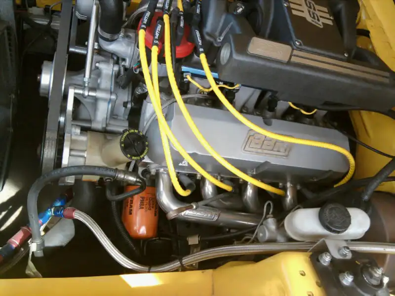

just for reference, this is the MM K member on our AI car with the stock oil filter location
