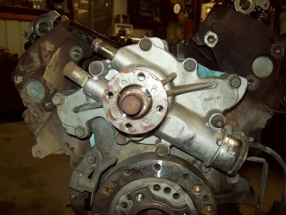

-There is one bolt you may think you need to remove the vibration damper to to get to- you do not! Just remove the pulley (you can use a socket on the main crank bolt to break the pulley bolts loose). You'll know which one I mean when you can't find it at first :rlaugh:

That bottom bastard almost tricked my into pulling the whole vib. damper off :rlaugh: It really doesn't seem like it'll come off without it when you're looking at it while its in the car. :rolleyes:
