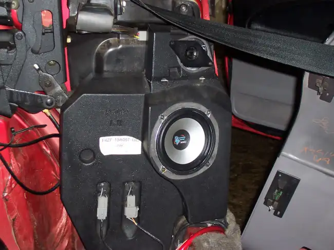

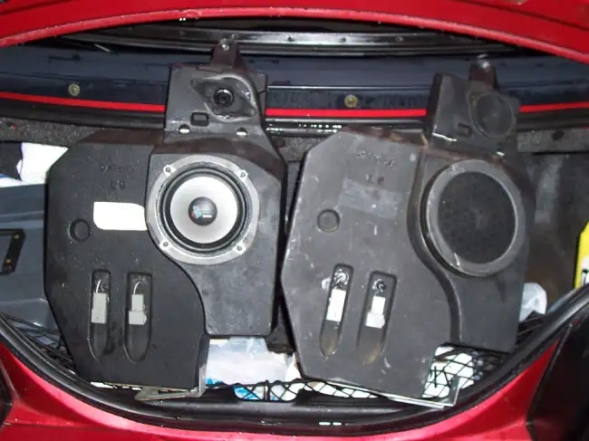

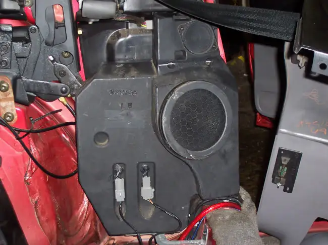

I just got two rear mid;s and all 4 tweeters from 98 Cobra convertible and i have then installed, oh boy they works avesome
First pics with my mismatch speakers ,2nd pics with new stock speakers
On left is old one s, on right new ones
