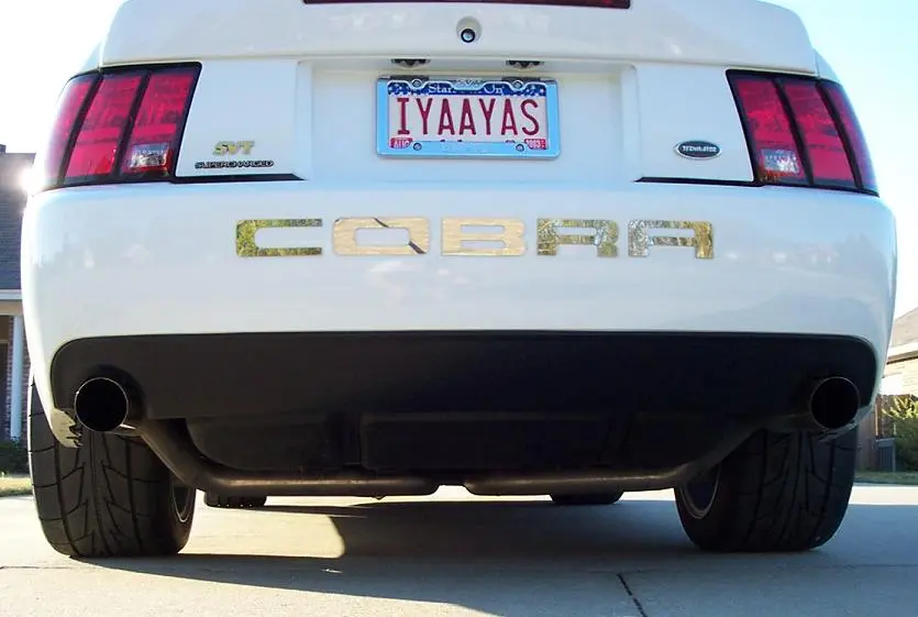

anyone have pics of 315's?
Black03GTRR
Apr 3, 2004
62
NJ
Does anyone have any pictures of Nitto 315's on stock 17x9 rims? I'm thinking about running that for this summer but don't want it to look bad or be bowed out and loose tire life. Thanks guys.
315's on 10.5's... sorry.
U.M.
Thanks meat... when you put the IRS bolt on there that fits 10.5's does that mean that you can't put the stock 9's back on or does it not matter?
Doesn't matter. The aftermarket rounded upper IRS bolts work with either the stock 9in or 10.5in rims. Since I was running the 315 Nitto's the replacement IRS bolt is only needed when the suspension is fully extended. Once I step up th the GY GS-D3's then I'll need a 3/8in spacer to go along with the upper IRS bolts.
