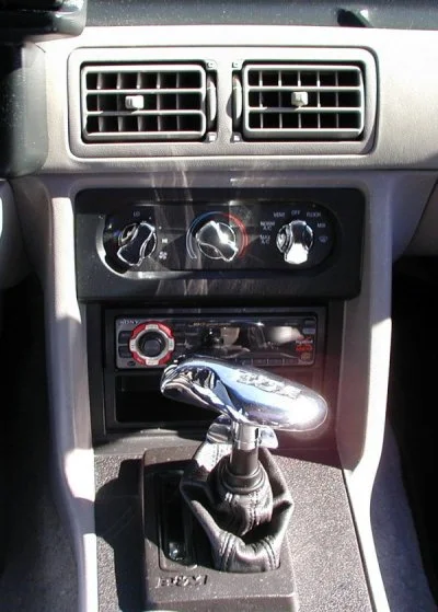

The B&M hammer is a nice shifter for the AOD that you don't have to hack up the console. I run the B&M Pro stick with my AOD , but have the electric OD. I think they have a plate for the B&M pro & Hurst 1/4 for it to work with the AOD. I also use the mounting kit from Holcomb motorsports that puts the Pro stick and 1/4 stick in the stock location. I didi have to notch my trim plate for the ****fer to go all the way into 1st, since I run my trans in manual mode.

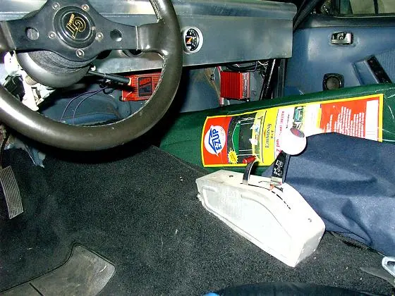

This might not help, but here is how mine is. I dont have a stock dash in the car.
