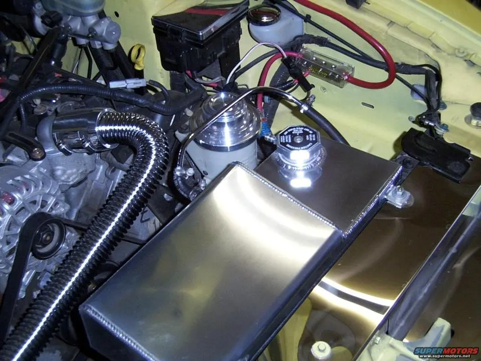

Is your POS cable wrapped? I cut the end off mine and hooked it up using a stereo distribution block.
