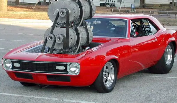

I went with Hampton Blowers, great service and he also sells everything you need. I didn't go with fuel injected, I have two 660's on mine. I was thinking of fuel injection but I went with a methanol injection kit. can't wait for the numbers.
you dont have any track times do you? what do you expect that beast to run?:hail2:
