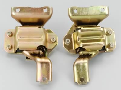

Seems like it would be a simple matter to fab brackets that would attach to the stock 4.6 Mustang mounts
It was simple, until I got to the driver's side....the problem is the steering linkage...which when used with the stock motor mounts kinda tends to go right through where the bracket needs to be, that picture shows mounts of the type that might be found on a crown vic, or possibly a mustang, I have mark viii mounts, which are completely different and mount straight down as opposed to a 45, the same type of mounts that are on T-birds with 4.6L engines...it would be simple to buy some mustang mounts....but the dealer wants $200 a piece, which is ridiculous when I can just make my own...besides I dont really want stock rubber mounts anyway, I would prefer better power transfer...I'll take some pictures tonight of what I am wrking with so far
...it would be simple to buy some mustang mounts....but the dealer wants $200 a piece, which is ridiculous when I can just make my own...besides I dont really want stock rubber mounts anyway, …
Well, you must be shopping the wrong places, the 2004 mounts are $28.79 each at Rock Auto.
getimage.php
Why don't you want "rubber" mounts? The way they are constructed I doubt you'd get 1/4" of movement even at max torque, and they're indestructible by federal law. If that's too much movement, you could get urethane mounts for $140 for the pair from Summit.

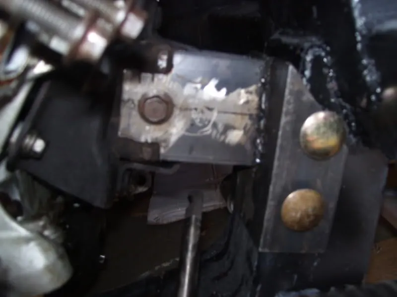

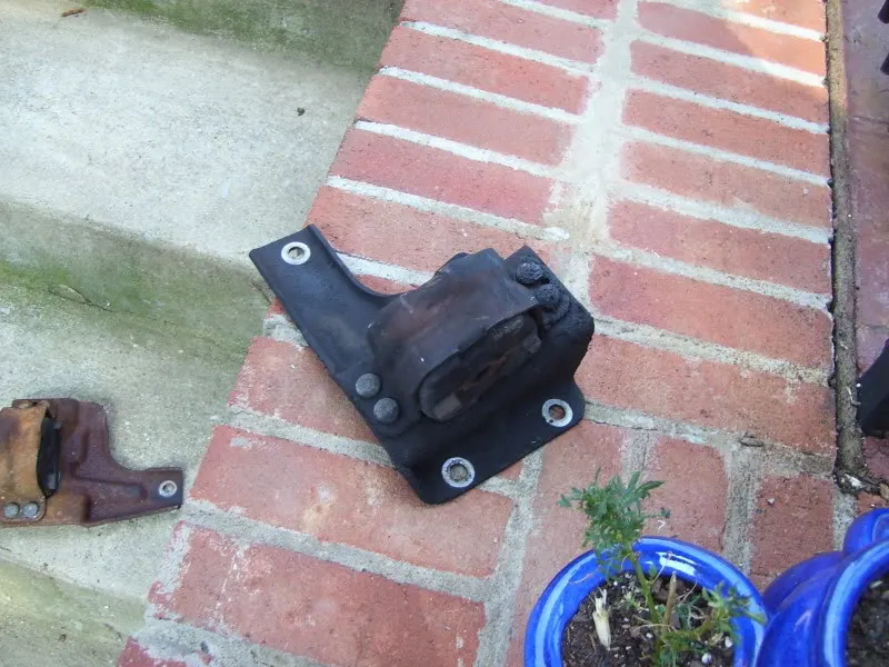

ok, here is what I have...this is the mark viii mount with a frame bracket i fabbed for the passenger side
you cant really see it but it mounts vertically...the whole assembly takes up a good deal of space and I am unhappy with it

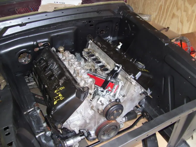

this is the drivers side space I have to work with
front of engine
from up under where the exhaust manifold will be
very limited space here, the steering linkage is almost certain to interfere with any similar mount over here

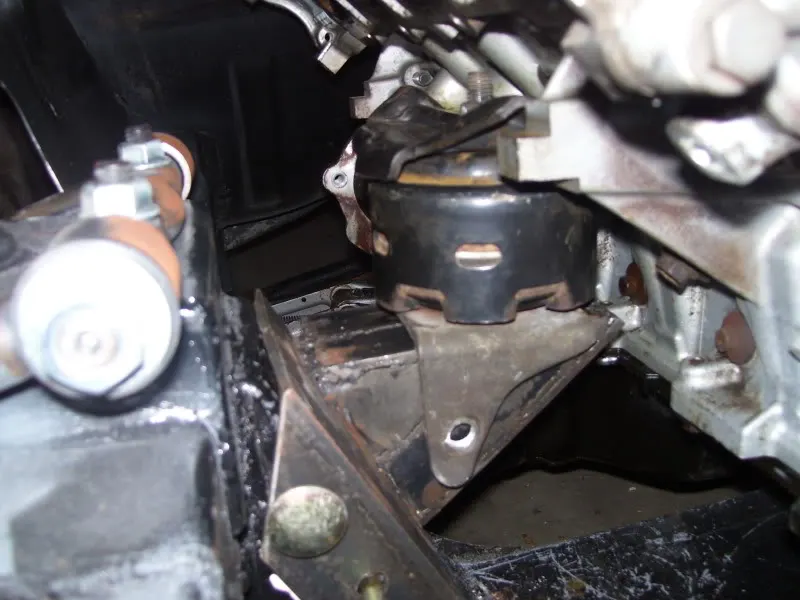

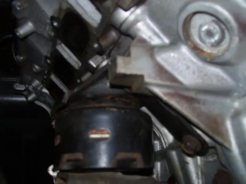

so I picked these up today...
I think they are from a crown vic or something along those lines...I think they will adapt more easily to my application than the huge mark vii ones(I will try them as they are and if I am unhappy with the flex I will weld plates to make them solid, or possibly take the inserts out and re-pour them with Urethane

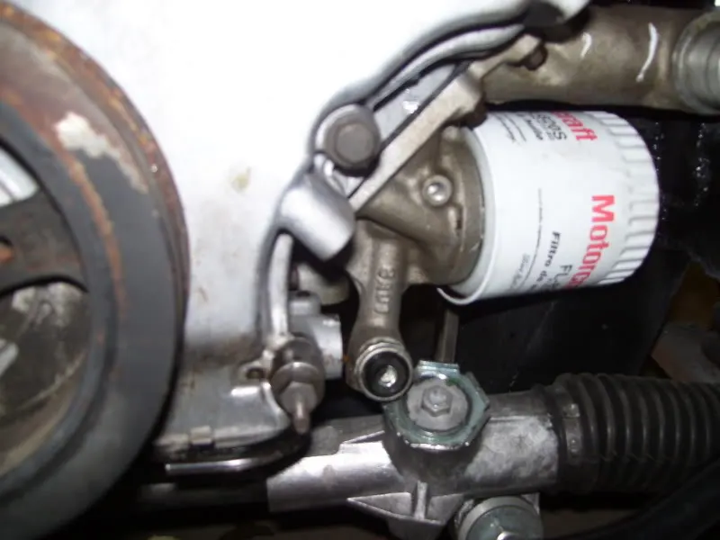

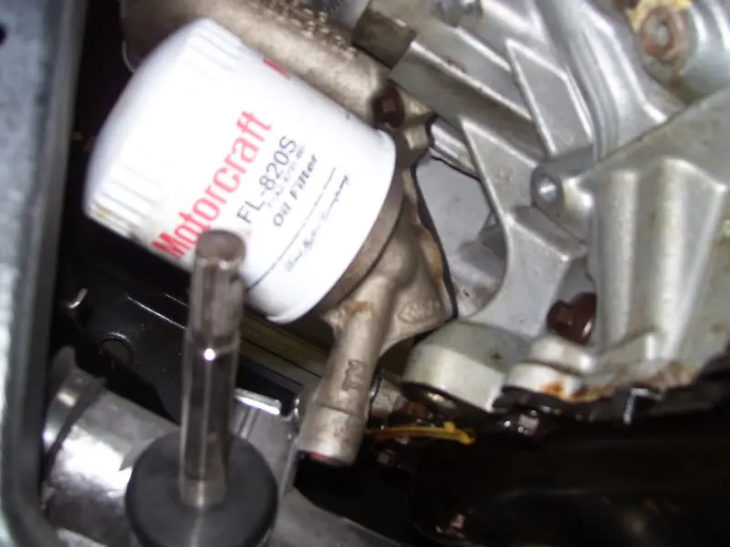

on another note...I noticed the crown Vic oil filter/water pipe assembly was also better...it didnt have the oil pressure sensor extension sticking so far down it hits the steering rack...it also puts the water pipe at a better location

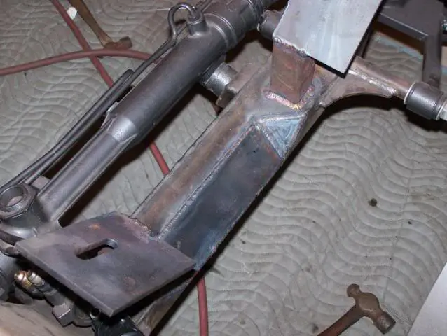

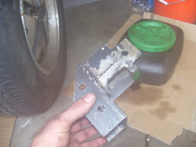

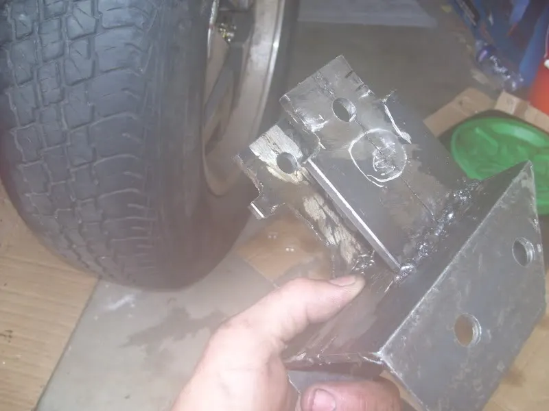

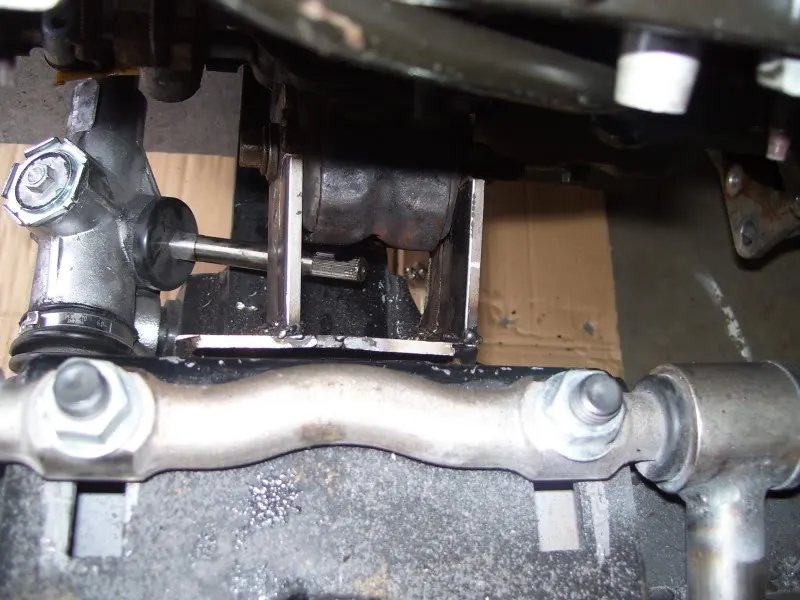

alright, an update, this is what I came up with....this method gave me the most clearance for the steering linkage...I have a feeling the header over here i going to be a PITA too, I'll have to twist it around the linkage somehow, anyway some pics
note the rough notch for the steering linkage
and installed...temporarily...
from the top...though I will add a bit more bracing before its all the way finished

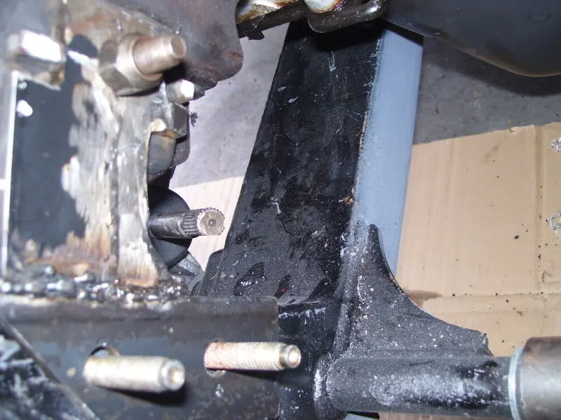

from the back(camera held sideways) you can see the splines of the linkage here

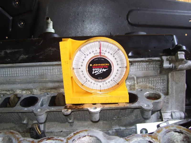

best of all...I ended up with 3 degrees...perfect, also perfectly centered between the frame rails...within 1/32 ofan inch anyway
an overall shot of the engine bay now that its sitting on real mounts...although I have to re-do the passenger side mount to match now
